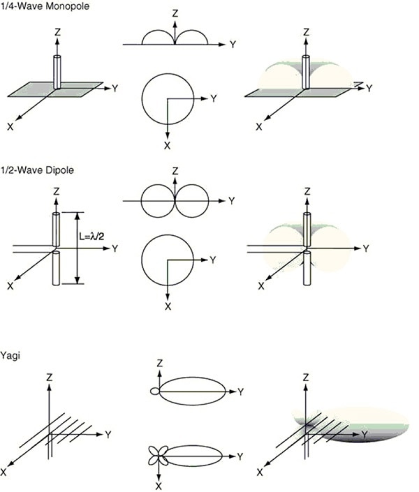

I am deferring the description of such parameters till I get to the measurement phase of the project, with the exception of the radiation pattern, because it gives us useful information, needed for the design. The radiation pattern is the distribution of the radiated energy into space, represented as a diagram. Below there is an example of radiation patterns for some antenna types.

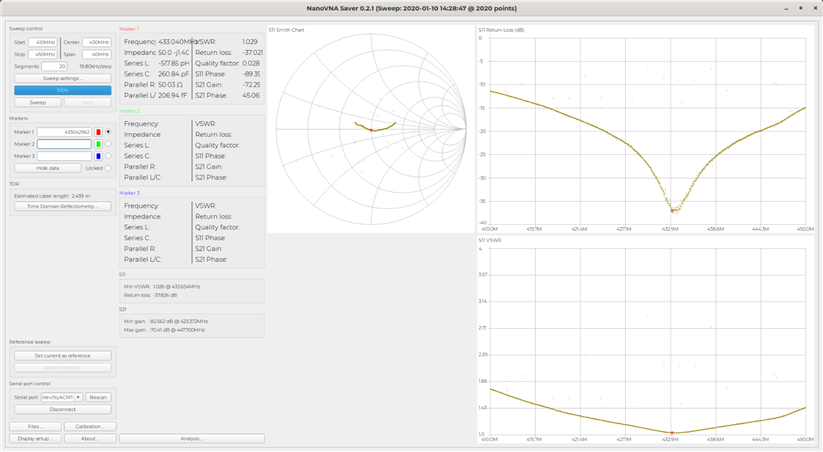

I have repeated several measurements, for the Return Loss (S11) and the Standing Wave Ratio (SWR). Since the start, the results were surprisingly encouraging: the graphs clearly showed the antenna resonating around the 418MHz. Although already pretty good, I wanted to shift the resonance frequency up by trimming the radiating element, taking off about 2mm at time and repeating the measurement. Iterating this procedure, I managed to get the antenna to resonate at 433MHz. Below you can see the last measurement taken, using the NanoVNA Saver, and the setup for the measurement.
As can be noticed from the setup above, although the monopole has the SMA connector, I connected the antenna using a SMA to IPEX adapter cable connected to an IPEX to SMA connector, which in turn is connected to a SMA to SMA cable and finally to the SMA connector of the NanoVNA. The calibration has been performed at the end of the SMA to SMA cable. This might seems odd, but I have done this way because the antenna will be used with the TTGO board, which only has an IPEX connector, so to connect my antenna to the board I have to use the SMA to IPEX adapter cable. Doing the calibration this way, I am measuring the antenna in the conditions that are the closest to the way it will be used (the only difference is that when in operation, the antenna won't use an IPEX to SMA adapter - adapter shown in the photo above).
With this setup, and with a final length of the radiating element of 16.3cm, those are the measurements taken:
The result seems good so far, even the impedance measured is very close to the expected one (although, being the NanoVNA very close to the antenna, and the whole measurement taken is a small room, where there are reflections, I suspect the reading might not be very reliable...).
