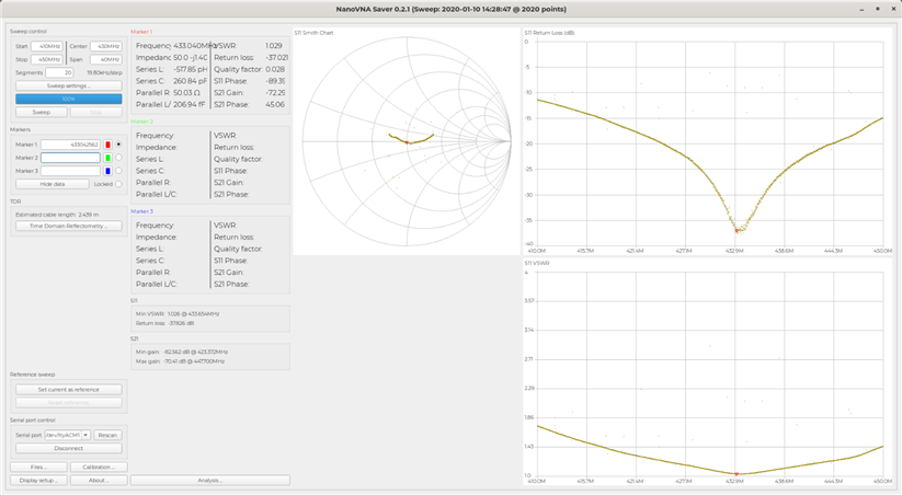

And now, lets use the full power of the NanoVNA to help tune this antenna! As mentioned in my first blog, my settings are less than idea for measurements, so I expect also the results to be "tainted" by this, but hopefully they will be good enough.
The NanoVNA is a pocket Vector Network Analyzer, with a working frequency range of 50KHz - 900MHz, and a price tag of merely £35! (If you are interested to know more about it, please check the link in the reference section).
Before taking measurements, the NanoVNA needs to be calibrated, using the calibration kit included (Short, Open and 50 Ohm Load). The instrument comes with a touchscreen, from which you can operate and show the measurements. The screen is nice, but rather tiny, so I preferred to install the NanoVNA Saver, a Python frontend for the NanoVNA that can be installed on my laptop and used to control the instrument (the NAnoVNA can be connected using the USB-C cable included).
The calibration procedure is quite straightforward, and only takes few minutes to complete. The idea behind the calibration is to make sure that the error introduced by the connecting cables are corrected by the software. To minimise the errors, all the measurements are taken under the same conditions, especially minding the position of the cables stays the same (thanks shabaz for the advice!). I have calibrated the NanoVNA for the frequency range 410-450MHz. The video shows how easy is to calibrate the NanoVNA, (this is an example, just to show how it is done).
I have repeated several measurements, for the Return Loss (S11) and the Standing Wave Ratio (SWR). Since the start, the results were surprisingly encouraging: the graphs clearly showed the antenna resonating around the 418MHz. Although already pretty good, I wanted to shift the resonance frequency up by trimming the radiating element, taking off about 2mm at time and repeating the measurement. Iterating this procedure, I managed to get the antenna to resonate at 433MHz. Below you can see the last measurement taken, using the NanoVNA Saver, and the setup for the measurement.
As can be noticed from the setup above, although the monopole has the SMA connector, I connected the antenna using a SMA to IPEX adapter cable connected to an IPEX to SMA connector, which in turn is connected to a SMA to SMA cable and finally to the SMA connector of the NanoVNA. The calibration has been performed at the end of the SMA to SMA cable. This might seems odd, but I have done this way because the antenna will be used with the TTGO board, which only has an IPEX connector, so to connect my antenna to the board I have to use the SMA to IPEX adapter cable. Doing the calibration this way, I am measuring the antenna in the conditions that are the closest to the way it will be used (the only difference is that when in operation, the antenna won't use an IPEX to SMA adapter - adapter shown in the photo above).
With this setup, and with a final length of the radiating element of 16.3cm, those are the measurements taken:
The result seems good so far, even the impedance measured is very close to the expected one (although, being the NanoVNA very close to the antenna, and the whole measurement taken is a small room, where there are reflections, I suspect the reading might not be very reliable...).

    This morning I have repeated the calibration, including all the adapters and cables, up to the antenna SMA (photos below), and measured the antenna Return Loss, SWR and Smith chart:
    The results indeed seem to verify your assumption that the SMA - IPEX adapter cable does not affect too much the antenna characteristics .It is interesting to notice the resonance frequency shift to about 430MHz, which kind of show how the SMA to IPEX connector cable effect is to kind of "shorten" the antenna...
