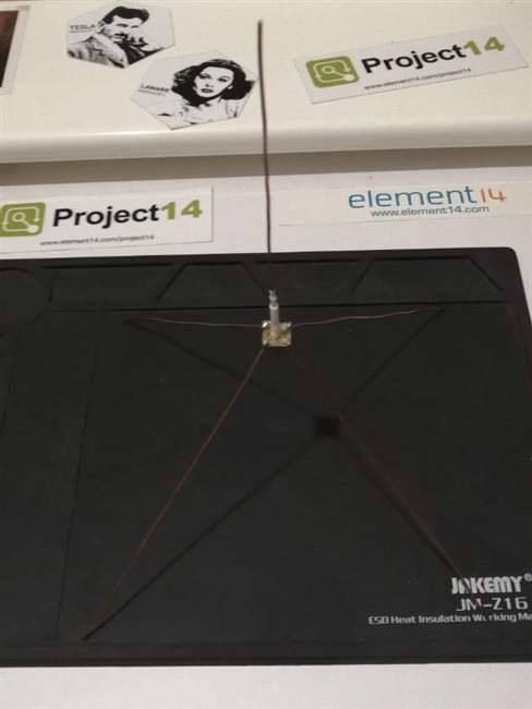

It is time to design the antenna. For the monopole, we need to design the ground plane. One way to achieve that is to use 4 radials, drooped at 90 degrees respect to the radiating element, and spaced 90 degrees from each other, in a "star" configuration. The lengths of the radials is the same as the radiating element: λ/4 (17.36cm). With this configuration, the antenna looks like:
As seen before, the monopole with ground plane made with radials at 90 degrees from the radiating element will present a 37 ohm impedance at the feeding point. I need to find a way to match the 50 ohm of the feeding transmission line, possibly avoiding building a matching RLC network! One observation comes to the rescue: if we imagine the radials drooped all the way down, forming a 180 degree, the monopole will actually become a "proper" dipole, which means its impedance at the feeding point is going to be about 73 ohm. This suggests increasing the drooping angle of the radials respect to the radiating element, the feeding point impedance should increase. This way, the 50 ohm impedance is reached for a drooping angle of about 135 degrees, as shown below.
So, looks like we worked out the structure of the antenna, including the length of the radials and the radiating element. A quick look to check what I have got available around reveals a bunch of panel mount 4 holes SMA connectors and several pieces of 16 AWG solid copper core wiring cable of different lengths:
First, I need to cut 5 pieces  of wire, making them all the same length: 17.36cm. Actually, I'm cutting the 4 radials a little longer (18cm), to give me a bit of extra length that I can bend to form a sort of hook around the SMA connector holes. The radiating element will likely need to be trimmed a bit, as in my calculations, I didn't take into account the difference of velocity of the EM waves in copper respect to the speed of light in vacuum. For the solid copper wire, I'm assuming a velocity factor of 0.95, which will make the new length 17.36 * 0.95 = 16.49cm (although I will not cut it yet, but I will trim it a bit at time, when tuning the antenna as close as possible to 433MHz).
Once all the wire pieces are ready, secure the 4 radials to the holes of the SMA connector, making sure they are positioned correctly and forming an angle as close as possible to the 135 degrees specified for the design. Using the helping hands, and fitting the largest soldering tip I have got for my soldering iron (and cranking up the temperature of the iron to 350C),  the radials are soldered in place. The little hook around the hole helps making both a more mechanically robust and electrically sound connection.
And now, the tricky bit: soldering the radiating wire to the center conductor of the SMA connector.This is achieved with the help of a little flux, Unlike the radials, for the central conductor there is no way to make any sort of mechanical connection to help strengthen the structure, so I have resorted to using some heat-shrinking tubing for the task. Notice, this tubing, although covering only a small fraction of the radiating element, is likely to influence the velocity factor, with the result that the element might end but needing to be a little shorter than the 16.49cm predicted. Since I have no idea on what the velocity factor is for the heat-shrinking tubing, I will leave it till the trimming at the tuning stage.
It is time to show the final result of this effort!
