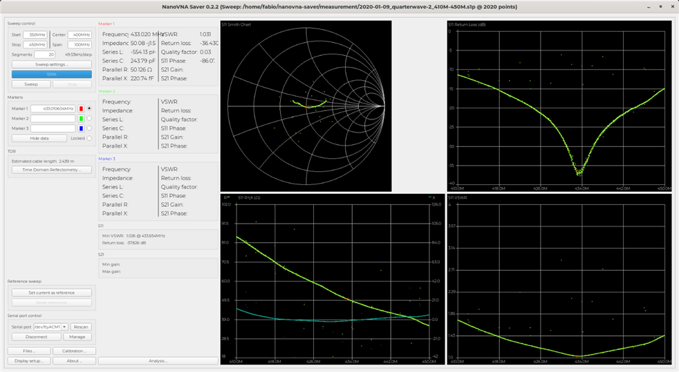

In the previous blog, I have built my quarter-wave monopole antenna, and measured using NanoVNA. Since I have got some other 433MHz antennae around, in this article I will focus on measuring their Return Loss, SWR and Impedance, to compare it to my own. Below is the array of antennae that will be measured.With the exception of the Molex and my own built, the others are all cheap antennas, got from Aliexpress and eBay. The antennae used are:
  • Helical Antenna
  • Molex Flexible Printed Circuitboard (FPC) Antenna
  • Center Loaded Coil Antenna
  • Small FPC Antenna
  • Quarter-wave Monopole Antenna
Before starting, I want to stress again I'm taking the measurements in a small room, with probably a good amount of reflection from walls and furniture, and using only a NanoVNA, so when I say "compare" I am abusing the word a little, as to be able to properly compare such diverse antennae would require better equipment and much more time!
Helical Antenna
This antenna is the one I got delivered as part of the TTGO ESP32 LoRa board kit. It is basically and helical antenna, soldered to a coax and terminated with an IPEX connector (for the measurement I will need the IPEX-to-SMA adapter). Because has been sold as the antenna for the 433MHz board,From what I can see,  this antenna does not have a ground plane.From the measurement, it looks like the antenna, despite being sold as tunes for 433MHz, resonate at about 395MHz, with a return loss of -7dB.
Molex FPC Antenna
The antenna chosen from the Molex kit is the 433MHz, with IPEX connector (so I need to use the IPEX-to-SMA adapter). Measuring this antenna I have had some strange results. I tried slightly changing position, rotating the antenna slightly, but no change: it looked like this Molex antenna, at 433MHz, was less than ideal, showing a return loss of -about -1dB and SWR 21.89! Since, in its "open" position, I wasn't getting any joy out of this antenna, I thought why not try folding it, as it is an adhesive antenna, so bending it should do no arm to the structure. I tried to fold it into a cylindrical shape, secured the end with some masking tape, then hooked it up again to the NanoVNA and... with my surprise, the results now were a lot better, showing a return loss of about -6.7dB and SWR 2.717. I cannot explain why, if left flat and open, the antenna does not perform at all, while once folded, seems to behave more.

This is another antenna I got of eBay, claiming to be a 5dBi center loaded coil antenna.It comes with a 1 meter cable, terminated with a SMA connector.I wasn't expecting it to perform in any good way, as this antenna is typically advised as a "multi band antenna, but I was pleasantly surprise by the results: return loss -6dB and SWR di circa 3. It seems the  antenna appears to have a resonance at about 420MHz.

Quarter-wave Monopole -36.43 1.031 tuned at 433MHz
Looking at the data, the only antenna tuned for resonance seems to be the one I built. It is worth mentioning that resonance is not a necessary condition for an antenna: there are many cases where antenna need not to be tuned for resonance, like for the one used for multi band operation. Of all the antenna, the Molex is the one that still puzzles me, because of the odd measurement when used "flat"... (please check the update below)
In my next and last blog, I will set up the TTGO boards and test which antenna performs best as distance coverage.
*Update on Molex antenna performance - 14/10/2020
Thanks to jc2048's comment below, I now know why the Molex antenna is performing so badly, and I have to say it is all my fault for just assuming it was a free air antenna. On the application document, it is stated clearly that it needs to be stuck on a layer of PC ABS material. After checking, I found a 4mm thick piece of clear polycarbonate, so I stuck the Molex antenna on it and measured in free space (no ground plane). The results are now consistent with the application document, as you can appreciate from the images below:
Note that, on the application document, the PC ABS layer thickness suggested is 2mm. I have used a 4mm thick layer, but the effect does not seem to degrade the antenna performance too much.

    Hi Jon, Thanks for the link, I wrongly assumed it was a free air antenna. Now all makes sense, also why folding it makes it work a lot better. I will have to go in the garage and see if I have a piece…

    Found some polycarbonate, but it is 4mm thick. Still, seems to work ok

    You've made a nice antenna there. Building it on the connector socket, in the way that you have, makes for a good, near seamless match to the cable.
    According to this document, the Molex antenna is designed to be stuck to a PC or ABS surface. You're operating it in free air without the dielectric alongside, so it's a bit of an unfair test.
