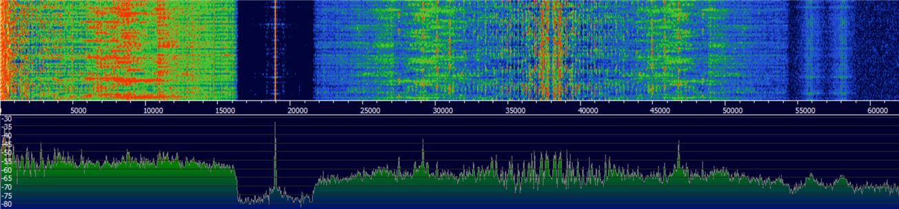

This is how the FM baseband spectrum of a stereo, RBDS transmitting station looks in theory:
[wikipedia]
And this is how it looks from a local FM radio station as I captured it with a software-defined radio (SDR):
Lets put it all together, mathematically the baseband of a stereo FM signal (without RBDS) can be expressed as:
