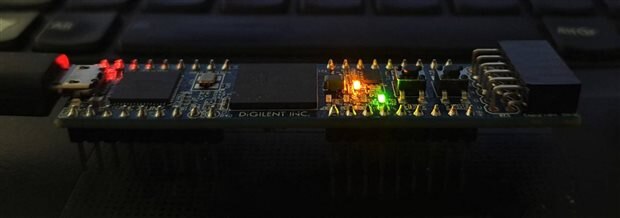

Powering up an LED is probably the simplest thing that can be done with an FPGA. To power up an LED I first need to select in Vivado the target FPGA chip model from a list and then create two files, a "constraints" file that describes how the pins of the board are connected to the FPGA , and the Verilog file. Before editing the constraints file I need to know how the FPGA pins are wired to the LEDs and buttons, so I download the board schematic from Digilent's board page:
(Digilent reference manual)
The wiring is defined through Tcl commands in an "XDC" constraints file. For my "Hello FPGA" I just need to write a single line:
set_property -dict {PACKAGE_PIN E2 IOSTANDARD LVCMOS33} [get_ports {led}];
This tells Vivado that the pin "E2" uses 3.3V and that it will be referred as "led" in the Verilog file. The Verilog file is also very compact:
module Hello(led);
    output wire led;
    assign led = 1;
endmodule
Here I defined a module called "Hello" (be aware that his is not the equivalent of function of a typical programming language) which outputs to the "led" wire (already defined in the constraints file as being pin E2). Within the module I set the wire to 1 (3.3 V), and the result of the design is:
We can see 4 glowing LEDs in the image, the red (power) and orange (FPGA programming done) are not user controlled, but LED0 (RGB) and LED1 are. You may be wondering why LED0 is on when I just set LED1 (led) to 1 in the Verilog code; a quick look into how LEDs are wired to the FPGA pins will probably help you figuring that out. Unassigned pins are pulled-down (the default behaviour for all pins can be changed in Vivado), and the RGB LED is turned on by setting each of the component pins to 0. To turn the RGB LED off I need to slightly modify the design:

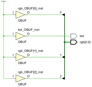

I added a 3 bit vector wire for the RGB LED. By setting rgb to 3'b111 (3 bits binary 111) I effectively turned off all the RGB components of the LED:
Vivado allows us to see the output schematic of our design, which in this case isn't particularly interesting:

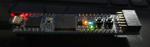

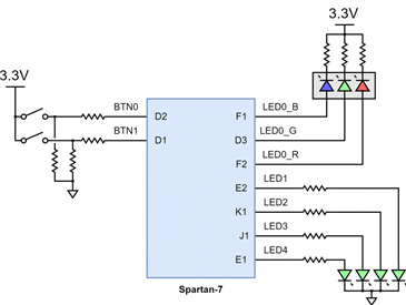

4.2 Button powered LEDs
A very simple modification to previous code allows us to control the LEDs through button presses:
set_property -dict {PACKAGE_PIN D2 IOSTANDARD LVCMOS33} [get_ports {btn[0]}];
set_property -dict {PACKAGE_PIN D1 IOSTANDARD LVCMOS33} [get_ports {btn[1]}];
set_property -dict {PACKAGE_PIN F1 IOSTANDARD LVCMOS33} [get_ports {rgb[0]}];
set_property -dict {PACKAGE_PIN D3 IOSTANDARD LVCMOS33} [get_ports {rgb[1]}];
set_property -dict {PACKAGE_PIN F2 IOSTANDARD LVCMOS33} [get_ports {rgb[2]}];
set_property -dict {PACKAGE_PIN E2 IOSTANDARD LVCMOS33} [get_ports {led[0]}];
set_property -dict {PACKAGE_PIN K1 IOSTANDARD LVCMOS33} [get_ports {led[1]}];
set_property -dict {PACKAGE_PIN J1 IOSTANDARD LVCMOS33} [get_ports {led[2]}];
set_property -dict {PACKAGE_PIN E1 IOSTANDARD LVCMOS33} [get_ports {led[3]}];
module LedButton(btn, rgb, led);
    input wire [1 : 0] btn;
    output wire [2 : 0] rgb;
    output wire [3 : 0] led;
    assign rgb[2] = btn[0] ? 0 : 1;
    assign rgb[1] = btn[1] ? 0 : 1;
    assign rgb[0] = 1;
    assign led[1 : 0] = btn[0] ? 2'b11 : 2'b00;
    assign led[3 : 2] = btn[1] ? 2'b11 : 2'b00;
endmodule
The Verilog code uses the "?:" ternary operator to set the state of the LED pins. When BTN0 is pressed, the red component of the RGB LED (rgb[2]), LED1 (led[0]) and LED2 (led[1]) are powered. When BTN1 is pressed, the green component of the RGB LED (rgb[1]) , LED3 (led[2]) and LED4 (led[3]) are powered. Pressing both buttons at the same time powers red and green components and all 4 green LEDs.

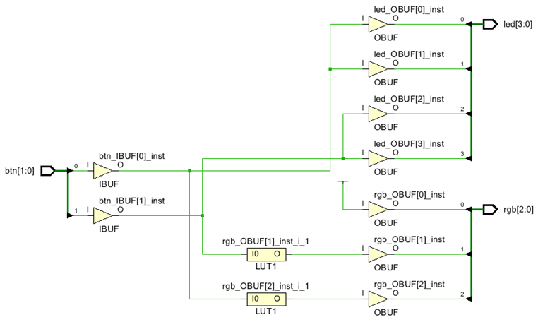

Vivado generates the following schematic:
When not pressed, button pins are set to 0, when pressed, to 1. Green LED pins take the same value than the button pins and we can see a direct connection between them. The RGB LED pins work differently, they require a NOT boolean operator, in other words, when a button pin is set 1, an RGB pin is set to 0, and vice versa.The schematic shows 2 LUTs (LookUp Tables) between input and output buffers, which in this design are configured to operate as NOT boolean operators. LUTs of course can be configured to perform any other kind of boolean operations, and they are the way FPGAs usually handle combinational logic.
Let's see the design in action:

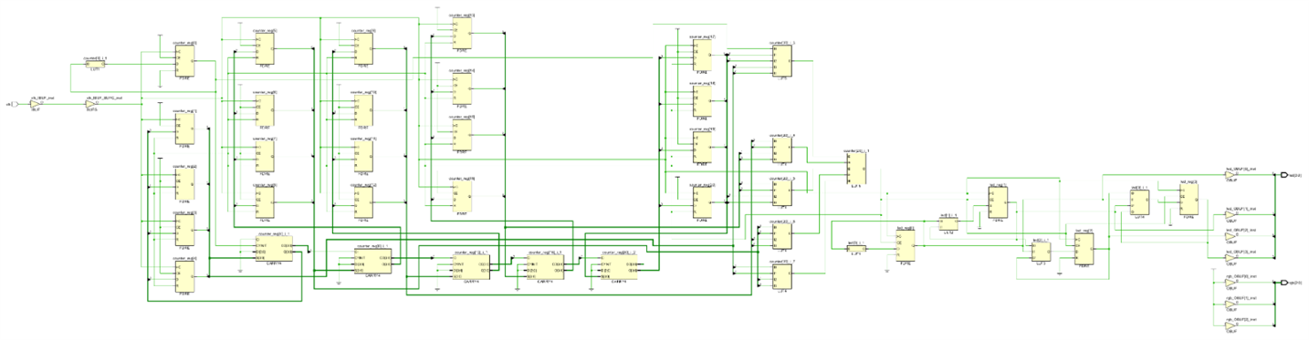

Here is the design in action:

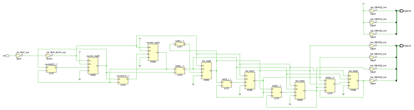

And this is its schematic:

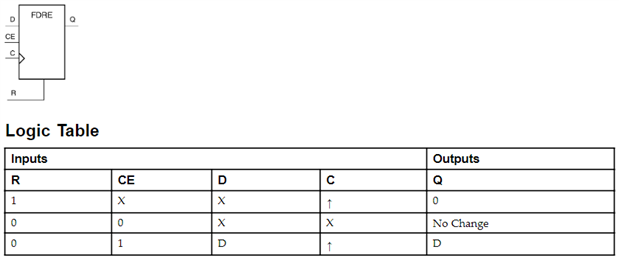

Very intimidating, isn't it? I’ll give you an intuition on how it works. We got 3 new blocks here, the BUFG, the FDRE and the CARRY4. The BUFG block is a high-fanout buffer that connects the signal to global routing resources. This is especially useful for clock signals as they must be fed into many other blocks with minimum delay between them. The FDRE block is a D flip-flop with clock enable and synchronous reset, its output is shown in the following table:
The flip-flop outputs its current state all the time to the Q pin. When reset (R) is set to 1, the state of the flip-flop is set to 0 at the rising edge of the clock (C). If clock enable (CE) is set to 1, the flip-flop state is set at the rising edge of the clock (C) to the data signal (D). The CARRY4 is a Fast carry logic with look ahead, and here is used in conjunction with FDRE blocks to implement a 21 bit delay counter.
Let’s take a closer look to how the design works.The clock signal feeds the clock input (C) of all the FDRE blocks of the schematic directly. The delay counter is made of 21 FDRE, 1 LUT1 and 5 CARRY4 blocks. The single LUT1 and CARRY4 blocks are responsible of incrementing the values of the counter. 4 LUT4 and 2 LUT5 are used to sample all the bits of the counter and compare them to 1,199,999. When the delay counter reaches this number, the counter[20]_i_1 LUT5 outputs a 1 and this has 2 effects. First it sends a reset signal (R) to the delay counter FDRE blocks, which causes them to reset to 0 at the next clock (C) rising edge; and second, it sets the clock enable (CE) of the 4 LED counter FDRE blocks to 1, effectively increasing in this way the LED counter to 1 during the clock rising edge (C). Notice that the LED counter is made of 4 FDRE, 1 LUT1, 1 LUT2, 1 LUT3 and 1 LUT4. These LUTs are configured to increment the counter, during the clock (C) rising edge only when clock enable (CE) has been set to 1 (once every 1,200,000 clock ticks).
If such a simple piece of Verilog code is synthesized into such large schematic, just imagine what kind of schematic the synthesizer would generate from higher complexity designs. Most of the times we don’t really need to know what kind of schematic is synthesized, but its good to have an intuition of how HDL code is converted into a circuit. Learning how each of these FPGA primitives operate is also useful for when they need to be use directly from an HDL. These primitives are presented as modules in Verilog and can be used like any other Verilog module. The drawback of using these primitives is that they are dependent of each specific FPGA and using them could make the code non-portable.

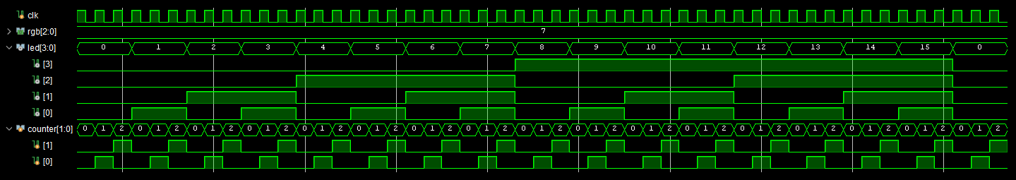

Let’s suppose that our Verilog design doesn’t behave as we want it to behave, what can we do? Manually checking the schematic is very time consuming and in many cases not a practical solution, because of the high number of primitives and states. An alternative is to simulate the design, simulations allow us to see how signals change with time, which can be very helpful in figuring out what went wrong in a design.
Let’s see how Vivado’s built-in simulator simulates the module if I set the DELAY macro to 3 (otherwise I would not be able to show in a single image the coordination of all the signals)!
As expected, the clk clock signal is the fastest changing signal. At every clk rising edge counter increases 1 until it reaches 2, at which point it resets to 0 and led increases 1. The moment led reaches 15 it wraps around and the whole process repeats.

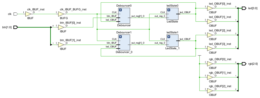

4.4 Debouncing
When a switch is toggled, contacts have to physically move to settle to their new position. This does not occur immediately, and before contacts settle to their final position, they bounce, causing the circuit to open and close several times. If you only care about the current status of a button, like in project 4.2, you can just ignore the bouncing effect, as it occurs too fast to be visible to the eye. But if you care about button pressing or releasing events, then you may require debouncing, or otherwise you could end up detecting multiple "fake events".
There are many ways to do debouncing, I decided to solve the bouncing problem like this: If the button changes its state, I generate a button "state change" event and reset a timer, and unless a defined amount of time has passed since last reset, any new event gets ignored as its likely caused by bouncing. Here is the code:
`define FREQUENCY 12_000_000
module Top(clk, btn, rgb, led);
    input wire clk;
    output reg [2 : 0] rgb = 3'b111;
    wire [1 : 0] event0;
    wire [1 : 0] event1;
    Debouncer #(0.1) Debouncer0 (clk, btn[0], event0);
    Debouncer #(0.1) Debouncer1 (clk, btn[1], event1);
    LedState ledState0(clk, event0, led[0]);
    LedState ledState1(clk, event1, led[2]);
    assign led[1] = led[0];
    assign led[3] = led[2];
endmodule
module Debouncer(clk, in, out);
    parameter waitTime = 0.05;
    input wire clk;
    input wire in;
    output reg [1 : 0] out;
    localparam waitTicks = $rtoi(waitTime * `FREQUENCY);
    reg lastState = 0;
    reg [$clog2(waitTicks) - 1 : 0] counter = 0;
    always @(posedge clk)
    begin
        if (lastState == in)
        begin
            counter <= (counter == waitTicks) ? waitTicks : counter + 1;
            out <= 0;
        end
        else
        begin
            counter <= 0;
            if (counter == waitTicks)
            begin
                lastState <= in;
                out <= (in == 1) ? 1 : 2;
            end
            else
                out <= 0;
        end
    end
endmodule
module LedState(clk, in, out);
    input wire clk;
    input wire [1 : 0] in;
    output reg out = 0;
        if (in == 1)
            out = ~out;
endmodule
In contrast to previous projects, we now defined 3 modules. Modules are in some way analog to classes of object oriented programming languages, and except for the top module, they have to be instantiated to be used. Instantiation syntax is again similar to the C++ syntax, the "Top" module instantiates 2 Debouncer and 2 LedState modules. To connect them I created 2 2-bit wires (event0 and event1) which are used to communicate the switch events from each Debouncer instance to their respective LedState instance.
Each of the 2 Debouncer instances debounces a single button as defined in the instantiation. The debouncer outputs a 0 when no event occurs, a 1 when the button is pressed and a 2 when the button is released. Parameters are constants typically used to specify the width of variables and time delays. Parameters are evaluated during synthesis, and can't be wire or reg data types. I defined waitTime as a parameter that stores the amount of time in seconds that have to pass before a new button event can be generated. I made the default value of the parameter 0.05, but this value is overridden to 0.1 during the instantiation of the module. Its important to note that Verilog synthesizable code does not natively support real numbers. To overcome that limitation I defined the localparam waitTicks and set its value to the waitTime converted from seconds to clock ticks. This was done by multiplying waitTime by `FREQUENCY, and then using the $rtoi() function to convert the result from real to integer. localparam is similar to parameter, its only difference is that its value can't be overridden at the instantiation.
The LedState instances receive events from Debouncer instances and set the state of the LEDs depending on the received button press events.
Here is a video of the the design:
And the schematic looks like this:
The schematic is very lean, because its encapsulating the content of the instances. Vivado allows you see the contents of the instance by either expanding it by pressing the "+" button at the top left corner of the block, or opening its content by double clicking it. As you can imagine, the Debouncer instances contain many cells and nets, so I'm not going to show them. One interesting aspect of the synthesized schematic is that the Debouncer instances connect directly to the LED wires and also appear to have one extra pin, caused by synthesizer optimizations. Vivado can also display the pre-optimized design using generic symbols that are independent of the target FPGA device:
Now this schematic is almost a perfect graphical representation of the Top module, Debouncer has only 3 ports now and the port names are identical to the names in the source code.

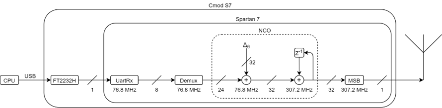

4.6 Xmas light show
And here I broadcast stereo FM music through a pin of the board: Xmas Audiovisual Show
