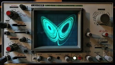

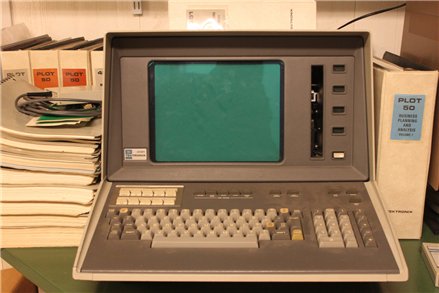

As a follow-up to Learning Verilog with the Digilent Cmod S7 blog post, and as part of the Project14 | Vision Thing: Beaglebone AI Your Vision Thing Project! I decided to use an FPGA to design a GPU to draw on a vector display [1]. Vector displays in contrast to raster displays can have the electron beam deflected in any arbitrary form through the control of their X and Y coordinates. One example of this type of display is the Tektronix 4051 [2], [3]:
[Dalby Datormuseum]
Another example of displays that use this technology are cathode ray tube (CRT) oscilloscopes:
As you may guess, that's the analogue oscilloscope that I'm going to use as a vector display, it's very old, so I hope it will make it until the end of the contest. You may think at this point that this technology is dead, and in the form of electron beams it somewhat is, but not in the form of lasers yet! Laser scanners [4] use galvanometers to tilt mirrors and deflect lasers:
[Wikipedia]
Laser scanners are used in laser shows, laser engravers, 3D printers and LIDARs among other things.
In this Project14 I'll experiment with vector display rendering. I'll mostly use an FPGA to perform low level graphics as their timing is very predictable and its clock frequency very fast.

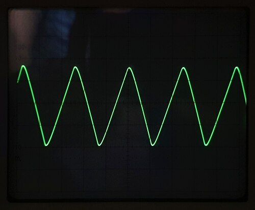

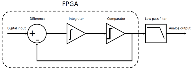

To draw in the oscilloscope display, I need 2 analog signals (or 3 if I want to use the “Z-axis”). Since the FPGA does not come with a DAC (although it comes with an ADC) I needed an external DAC. Probably the simplest solution would have been to use a DAC IC, but that would've been boring, so I decided to build my own DAC. There are a couple of ways to do this, but I decided to build a ΔΣ DAC [11], [12] . The principles of ΔΣ ADCs and DACs are the same. A continuous signal is converted (usually) to a 1-bit signal at a much higher sampling rate. The oversampled digital signal contains the original signal and a lot of high frequency noise, as result of noise shaping [13]. This digital signal signal can then be low-pass filtered to remove the noise and recover the original signal.
I implemented the modulator like this:
Through algorithms I generate two fixed-point values per clock tick, these values correspond to the X and Y axis of the electron beam position. Each of the values is fed into their own ΔΣ DAC and the output into the oscilloscope.Most of the ΔΣ DAC components run in the FPGA fabric, with the exception being the low-pass filter (ΔΣ ADCs are the other way around).
ΔΣ modulation can be implemented in many ways, but it’s a good practice to start simple and increase complexity as needed. I decided to use a first order ΔΣ modulator with 1-bit output and an RC low-pass filter. The sampling frequency and RC values will be tuned later as needed and depending on the FPGA design.
The Verilog ΔΣ implementation is very simple:

To test it, I built a triangle wave generator:

The code (made available in [14]) produced the following 1 kHz waveform in my scope:
Note that the waveform spikes are a bit round, this occurs because the low-pass filter bandwidth is not high enough and reduces the high frequency harmonics of the waveform.

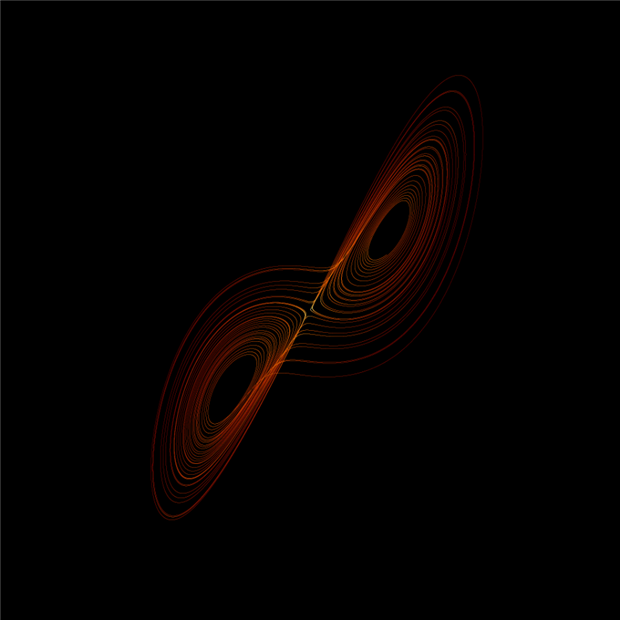

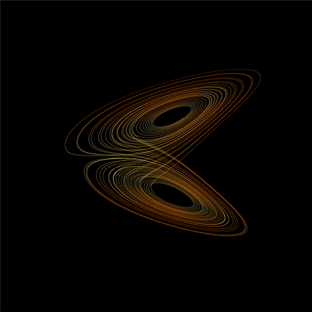

Having the ΔΣ DAC properly working I decided to go for something more challenging. Lissajous curves [15] have already been shown too many times on oscilloscopes, so I decided to solve ordinary differential equations [16] in the FPGA. One interesting ODE system is the Lorenz system [17], developed by Edward Lorenz while studying atmospheric convection, which can displays chaotic behaviour [18] with certain parameter values. The ODE system is defined as:
Where σ, β and ρ are the system parameters. Before writing Verilog code, I empirically explored how the system behaves. I set the system parameter to values that are known to produce chaotic behaviour (σ = 10, β = 8/3, ρ = 28), and recorded for a long time span the solution trajectories to empirically measure the position and radius of the smallest sphere that encloses them. The sphere was found to be approximately at (0, 0, 24.5) with an approximate radius of 34. I wrote a small Python program to plot the attractor from 3 different viewpoints and get a rough idea on what to expect from the FPGA implementation:
import sys
import numpy
import scipy.integrate as integrate
import matplotlib.pyplot as pyplot
sigma = 10.
rho   = 28.
beta  = 8./3.
dt = 0.00001
arraySize = 100000
loopIterations = 50
resolution = 1920
gamma = 0.25
def lorenz(xyz, t):
    x, y, z = xyz
    x_dot = sigma * (y - x)
    y_dot = x * rho - x * z - y
    z_dot = x * y - beta * z
    return [x_dot, y_dot, z_dot]
imageXY = numpy.zeros((resolution, resolution))
imageYZ = numpy.zeros((resolution, resolution))
imageZX = numpy.zeros((resolution, resolution))
t = numpy.arange(arraySize) * dt
initial = [8, 8, 23]
solution = integrate.odeint(lorenz, initial, t)
initial = list(solution[-1, :])
for i in range(loopIterations):
    print('.', end = '')
    sys.stdout.flush()
    solution = integrate.odeint(lorenz, initial, t)[1:]
    x = (( solution[:, 0]         * 0.015 + 0.5) * resolution)
    y = (( solution[:, 1]         * 0.015 + 0.5) * resolution)
    z = (((solution[:, 2] - 23.5) * 0.015 + 0.5) * resolution)
    for i in range(arraySize - 1):
        xi = int(x[i])
        yi = int(y[i])
        zi = int(z[i])
        imageXY[yi, xi] = imageXY[yi, xi] + 1;
        imageYZ[zi, yi] = imageYZ[zi, yi] + 1;
        imageZX[xi, zi] = imageZX[xi, zi] + 1;
imageXY = imageXY ** gamma
imageYZ = imageYZ ** gamma
imageZX = imageZX ** gamma
colorMap = pyplot.cm.afmhot
normalizeXY = pyplot.Normalize(vmin = imageXY.min(), vmax = imageXY.max())
normalizeYZ = pyplot.Normalize(vmin = imageYZ.min(), vmax = imageYZ.max())
normalizeZX = pyplot.Normalize(vmin = imageZX.min(), vmax = imageZX.max())
rgbImageXY = colorMap(normalizeXY(imageXY))
rgbImageYZ = colorMap(normalizeYZ(imageYZ))
rgbImageZX = colorMap(normalizeZX(imageZX))
pyplot.imsave('LorenzXY.png', rgbImageXY, origin = 'lower')
pyplot.imsave('LorenzYZ.png', rgbImageYZ, origin = 'lower')
pyplot.imsave('LorenzZX.png', rgbImageZX, origin = 'lower')
And the code output is:

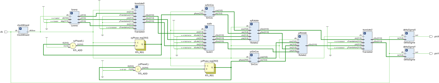

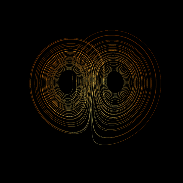

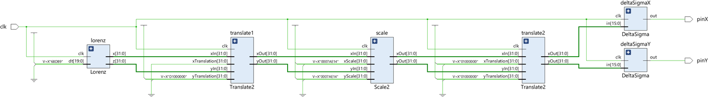

4.2 2D Lorenz System FPGA Implementation
The Verilog implemention uses 4 modules: Lorenz, Translate2, Scale2 and DeltaSigma, as it can be seen in the schematic:
I used the 12 MHz clock in the whole design. The Lorenz module uses Euler's method [19] to solve the ODE. It takes a dt parameter and outputs a 3D vector. Internally the Lorenz modules uses Q6.25 fixed point numbers and the parameters σ = 10, β = 8/3 and ρ = 28. I only take the X and Z components of the 3D vector and linearly transform them in 3 steps. First the 2D (X, Z) trajectories are centred to the origin (0,0) (translate1), then they are scaled (scale) so that the components of the vector fall within -0.5 and 0.5, and finally translated (translate2) so that they fall within 0 and 1. The linear transformations were implemented with a focus on simplicity and tweaking, if FPGA resources were limited, the transformations could have been implemented in a single step or with transformation matrices [20]. Finally the output of of the linear transformations is fed into two ΔΣ modulators which are connected to two RC low-pass filters.
This is the code (also made available in [21]) :

    Lorenz #
        .integerBits(integerBits),
        .fractionBits(fractionBits),
        .dtBits(dtBits),
        .dtShift(dtShift),
        .sigma(sigma),
        .beta(beta),
        .rho(rho)
    ) lorenz(.clk(clk), .dt(dt), .x(x0), .y(), .z(y0));
    Translate2 #(.bits(totalBits)) translate1(clk, x0, y0, 0, $rtoi(-23.5 * (2.0 ** fractionBits)), x1, y1);
    Scale2 #(.integerBits(integerBits), .fractionBits(fractionBits)) scale(clk, x1, y1, $rtoi(0.015 * (2.0 ** fractionBits)), $rtoi(0.015 * (2.0 ** fractionBits)), x2, y2);
    Translate2 #(.bits(totalBits)) translate2(clk, x2, y2, $rtoi(0.5 * (2.0 ** fractionBits)), $rtoi(0.5 * (2.0 ** fractionBits)), x3, y3);
    DeltaSigma #(.bits(deltaSigmaBits)) deltaSigmaX(clk, x3[totalBits - 1 : fractionBits - deltaSigmaBits], pinX);
    DeltaSigma #(.bits(deltaSigmaBits)) deltaSigmaY(clk, y3[totalBits - 1 : fractionBits - deltaSigmaBits], pinY);
endmodule

    parameter bits = 32;
    input wire clk;
    input wire [bits - 1 : 0] in;
    output reg out = 0;
    reg [bits : 0] sum = 0;
    always @(posedge clk)
    begin
        sum = sum + in;
        out = sum[bits];
        sum[bits] = 0;
    end
endmodule
And here is the video of the output:
4.3 3D Lorenz System FPGA Implementation
The previous design shows the Lorenz system trajectory, but the system evolves too fast to actually let us to appreciate its evolution. Moreover, using a fixed viewpoint it is not possible to appreciate the 3D shape of the trajectories. These two issues are what I tried to solve next. A naive approach to solve the first issue would be to reduce the dt, so that the system evolves slower, the problem of this approach is that it would make trajectories shorter or even reduce them to a single point, as there would be no phosphor persistence [22] or persistence of vision [23]. I solved this by redrawing the trajectory multiple times and slowly advancing the initial position of the trajectory on each redraw. The second issue was solved by continuously 3D rotating the trajectories.
The design uses the modules ClockWizard (by Xilinx), Lorenz (an updated version), Translate3, Scale3, SinCos, Rotate2, Translate2 and DeltaSigma:
ClockWizard is used to generate two clock signals, one at 25 MHz (clkSlow), and another at 250 MHz (clkFast), the slow signal is used everywhere except in the delta sigma modulator. The updated version of the Lorenz module redraws the trajectory once every 2^18 clkSlow oscillations, and at every redraw, the trajectory advances . It is also worth noting that this time we use all 3 components of the 3D vector. Analog to the 2D Lorenz system, the 3D vector is first translated (translate1) and then scaled (scale), but before getting to the final translation (translate2) I perform to rotations around 2 axis. The rotations angles vary continuously, depending on the values of the xyPhase and yzPhase accumulators. These values are fed into two SinCos modules, that uses a look-up table and a linear interpolation to compute the sine and cosine of the angle. the sine and cosine values are used by the Rotate2 modules to perform the rotations. Finally, just like in the 2D Lorenz system design, the X, and Y values are fed into delta sigma modulators connected to low-pass filters which are probed by the oscilloscope.
Code is available in Github ([24]), and this is the video of the output:
