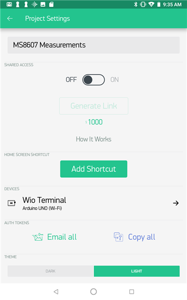

I created the project configured to use WiFi (I selected Arduino Uno for the device since the Wio Terminal isn't listed).

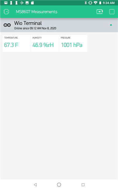

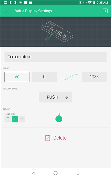

Then added 3 Value Display widgets to display the MS8607 measurements ( simply drag and drop the widgets on the project window).
The widgets are configured to use Virtual Pins.
Here is a screen capture of the project display window from the tablet.
Here is a quick video of the data tracking.  I perturbed the readings by touching the sensor but it seems it affected humidity the most.

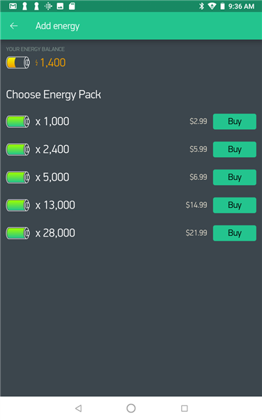

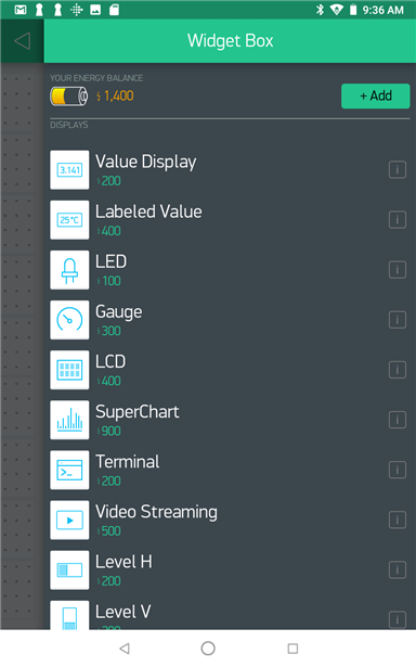

I've used Blynk before but it seems like the app has improved quite a bit (certainly has more widgets and supported boards).  It is free if you stay within your "Energy Balance".  You'll notice that each widget has a value that shows how much energy is consumed when a widget is used, e.g. each Value Display used 200 units.  You get 2000 units for free and need to buy energy beyond that.  If you delete projects/widgets you recover the "Energy" used so if you're using Blynk for prototyping it probably isn't an issue.  The pricing otherwise is indicated in the app.  Very convenient to use.  I'm starting to learn Kotlin with Android Studio so I'll probably create my own permanent apps.
