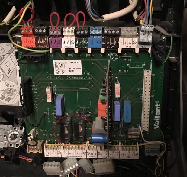

Previous month's theme was Simple Electronic Repairs Project14 | Earn a $100 Shopping Cart for Your Simple Electronic Repairs! . I didn't have anything to repair that time, but a coworker approached me one week before Christmas, because he noticed I was talking about electronics to another colleague. He has got an almost 16-year old Vaillant CNG boiler for a heating of his entire house (including a water tank). The trouble was that a control board couldn't switch the burner properly. He did a good job examining the control board and finding out, that after knocking on one of the two relays present on the control board, the relay switches the contacts and the heater is turned on. This was his daily job for a few weeks, in fact, turning on the electronics every day after coming from work, knocking on the relay, heating the house and water (thermostat was bypassed for obvious reasons, max. output was delivered to the heating system) and switching everything off in the evening.
The servicing company said that another board (probably used) would cost ca. € 400.
I requested a photo of the board and especially the relay and their surrounding:

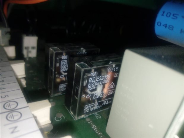

The relay is identified as EE Electronic E3206S (for switching 250 V, 10 A), working with 24 V DC and resistance of the coil 1100 Ohms. I haven't found a way to buy a new one from common distributors, but I found a seller on eBay that had two unused relays (probably in the past). It took about 2 weeks during the Christmas time to get it from Australia to Czech Republic.
Yesterday I visited my colleague with a soldering iron and a simple manually operated "pen style" pump and replaced both relays. I am glad the board was originally soldered using a lead solder, so I could do the work easily. I have no I idea whether I would be successful if the lead-free solder was used (need to do more research on that, I only have one bad personal experience).
After replacing the relays and plugging everything back again, a magical moment came. The boiler started as before the breakdown.
We are both happy that we gave a meaningful life to the board again, for about € 10, saving € 390 + price of the work.

    I can't find a datasheet for the relay to compare this value with an expected life.
    It wouldn't matter ....
    Given that your friend was able to 'knock' it into life, suggests the contacts are the issue, not the failure of the coil or the mechanism.
    If the load was slightly inductive, there would be some pitting, and this might be able to be polished out ... but it would come back again later.
    At least you know what the cause is, and it's a relatively easy fix, even if you need to do some tricky wiring next time to fit a different style relay.

    By the way, I forgot to add an important information. The regulator reported that the heater switched 27 000 times before failure. This is probably true, 16 years, meaning ca. 1 700 times switched per year. This is ca. 4,6 switches a day (during summer, only water is heated, but the boiler is operable for the whole year).
    I suppose the reported value is only for turning the heater on, which would mean 54 000 switches of the relay in total. Unfortunatelly, I can't find a datasheet for the relay to compare this value with an expected life.
