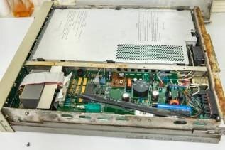

    pettitda over 8 years ago in reply to jw0752 +3
    I was able to clean up the board enough to sketch out the following schematic for this section. The board was very badly burned underneath the part, so not much chance of soldering another part on there…

    jw0752 over 8 years ago in reply to pettitda +1
    Hi David, Great job of figuring out the schematic. Sad to see that the conflagration did so much damage to the traces and the board. If you can determine the voltages needed for operation of the board…
    mcb1 over 8 years ago in reply to pettitda
    However it didn’t have enough resolution to see the markings on the top of the part.
    Or the orientation.
    I did note that the DC in went to the lower left, now that suggests it is Pin 6 (I've only seen comparators put volts in the middle).
    Hopefully that narrows the search.
    It doesn't resolve what the output voltage is, but with the feedback values, and some experiments you might be able to decipher it.
    If nothing else this collection of posts demonstrates how to go about identifying a part, and potential sources.

    pettitda over 8 years ago in reply to mcb1
    The only photo I found was in their FCC filings.  However it didn’t have enough resolution to see the markings on the top of the part.

    Nice work cleaning it up.
    Bit of resin and some solder and it'll be good as new ... image
    You need to find someone with another one that will take some detailed images and measurements ...
    The board was very badly burned underneath the part, so not much chance of soldering another part on there even if I did find out the part number.  Here's what it looked like going backward in time.
