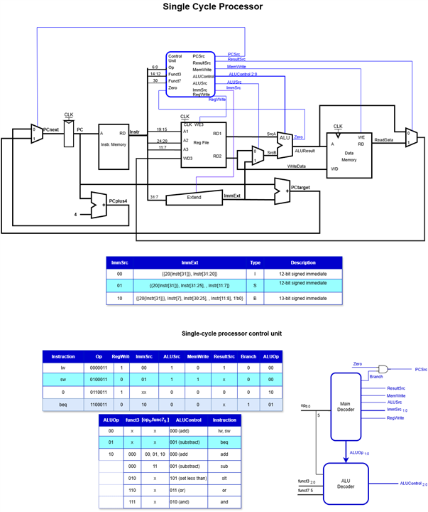

    For the competition, I'd like to design my own simplified RISC-V microcontroller in SystemVerilog for an AMD Spartan 7 FPGA. I've always wanted to really understand how a microcontroller works, and element14 has been fantastic in introducing me to FPGAs and providing development boards through various competitions. Documenting this journey and the results is also a great way for me to give back to the community for those opportunities.
  • javagoza
    javagoza over 1 year ago in reply to javagoza
    I'm diving into the fundamentals of processor design and building a RISC-V compatible single-cycle processor (RV32I). My main resource has been the book Digital Design and Computer Architecture by Sarah L. Harris and David Harris.
    I've already gone over the basics and am now working on the design in SystemVerilog. I've found that redrawing the architectural diagrams is a really helpful way to solidify what I'm learning.

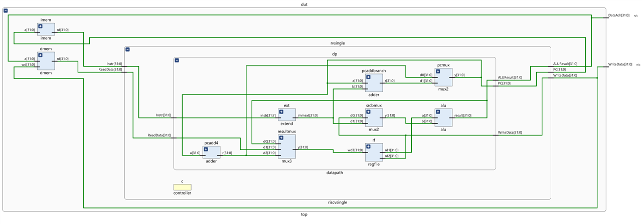

    Completed first version with reduced instruction set from RV32I
    Running sample code from Digital Design and Computer Architecture by Sarah L. Harris and David Harris book.

    Simmulation
    Schematic
    Dataflow Design

    Jan Cumps over 1 year ago in reply to javagoza
    This means it's alive and working, hé?
  • javagoza
    javagoza over 1 year ago in reply to Jan Cumps
    Indeed, it is! I've successfully learned how to design and simulate a very basic single-cycle RV32I processor in Vivado on the Spartan-7. It's a significant step for me!
    With this single-cycle design, I've learned that because all instructions must complete within the same clock cycle, the cycle time is limited by the slowest instruction. It also requires separate memory banks for instructions and data, and using three dedicated adders instead of the ALU for those operations.
    Now, I'm working on implementing the remaining instructions from the RV32I specification in single-cycle. Once that's solid, I plan to move on to a multi-cycle design and eventually a pipelined architecture. I've got the theoretical knowledge, and now the fun part of hands-on implementation begins!
