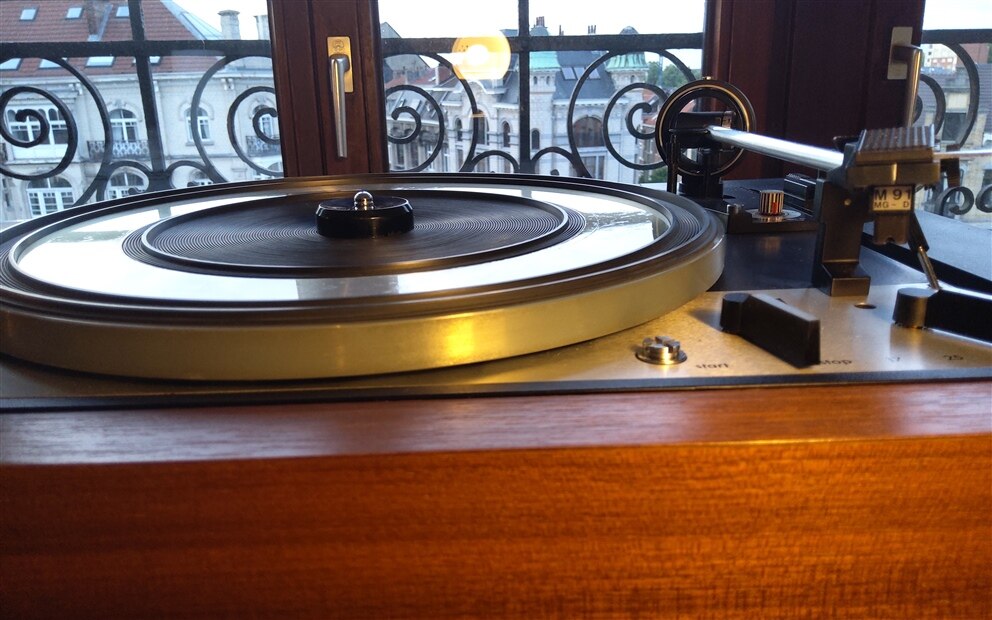

    the housing (with the turntable in place) after restore:

    As close as I can get it today. Mechanical (an that's 90% of the work), the table is functioning as new.
    I have to mount a stylus (I have it) and get a wall plug (of course, I don't have the most common part ever handy). So it's untested, but confidence is high.
    I've restored loads of vintage gear. Dual turntables (except when mistreated) usually can be revived. They are built well, and most aging symptoms have a remedy. Only exception is if someone tries to test an aged Dual and forces the levers. Those are usually dead.
    The table I have here has not been used a lot. I can see it because it doesn't have the wear you see on tables like this.
    expected damage:=
    • oil and grease sticky: always for a table that's not been maintained since purchase
    • controls iffy - or even frozen: same. And there are parts of this table that will be frozen even if maintained according to the service manual.
    • some plastic parts broken just because all of them are by now: plastic deterioration is a thing with 70s gear.
    what I think is late damage:
    • stylus bent. This is not because of use, but because of wrong handling. It was definitely not caused by use.
    • part of the lid broken: same: based on the glue used (and because the turntable itself is pristine) - this seems to be caused by recent mishandling
    Unexpected good:
    • one of the mechanical components, the "steuerpimpel" is almost never intact in a Dual TT. It's made of a plastic that easily degrades. But on my turntable it is in pristine condition. (the first ever Dual I serviced that had an intact one).
      That, and some other signs, like no rust at all, no scratches, show that it has been in a very good environment during its use.
      The physical damage that it has now (I am convinced) is because it's been mistreated when the owner's house was cleared out.
      The lid broke because they break when you don't protect them while moving.
      The stylus bent because the person who moved it did not know that you can lock a turntable's arm in place.
