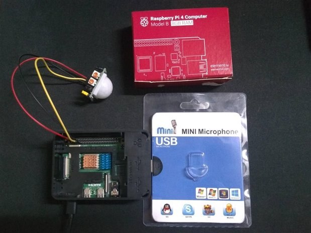

Here is a picture of the setup for this blog post
As part of the build/circuit, as you see in the picture above
  • the PIR sensor signal pin, the yellow wire is connected to GPIO 4 on the Raspberry Pi 4
  • and the USB mic is connected to the Pi's USB port
  • the SD card is flashed with 2021-05-07-raspios-buster-armhf-lite image

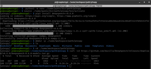

Now, before you run the python program attached, you will need to follow the setup steps below
- SSH into Pi4 and create a virtual environment called p14spy using the command
python3 -m venv ./some/pyenv/dir/path/p14spy
- go to the virtual enviroment
source ./some/pyenv/dir/path/p14spy/bin/activate
- install deep speech, I installed an older version , as the latest 0.9.X version is error'ing out
pip3 install deepspeech==0.6.0
- create a directory to download the DeepSpeech models
mkdir -p ./some/workspace/path/p14spy
cd ./some/workspace/path/p14spy

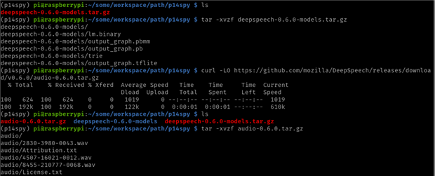

- use curl to download the DeepSpeech models, this is going to take some time , so go an grab yourself a coffee after running this command
curl -LO https://github.com/mozilla/DeepSpeech/releases/download/v0.6.0/deepspeech-0.6.0-models.tar.gz
this is more than a 1 GB download, and in my case took about 26 mins.
- once done unzip  the tar
tar -xvzf deepspeech-0.6.0-models.tar.gz
- also download a few audio samples which we will use to test that the install  and all the dependencies installed okay, and is working as expected.
curl -LO https://github.com/mozilla/DeepSpeech/releases/download/v0.6.0/audio-0.6.0.tar.gz
- unzip the tar
tar -xvzf audio-0.6.0.tar.gz

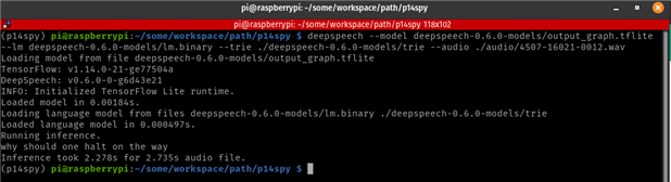

- now to check if you install is successful run deepspeech
deepspeech --model deepspeech-0.6.0-models/output_graph.tflite --lm deepspeech-0.6.0-models/lm.binary --trie ./deepspeech-0.6.0-models/trie --audio ./audio/4507-16021-0012.wav

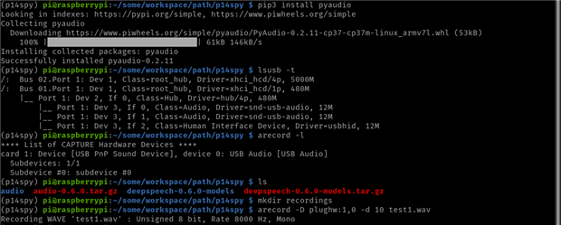

- In addition to the above setup, like in the first blog post Pi Spy Audio Recorder - part 1 , we will setup pyaudio using pip, and check if we are able to record audio using the USB microphone
pip3 install pyaudio
arecord -l
mkdir recordings
arecord -D plughw:1,0 -d 5 recordings/test1.wav

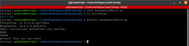

- Now we will write a quick python program to read the wav file we just recorded.
import deepspeech
import wave
import numpy as np
model_file_path = 'deepspeech-0.6.0-models/output_graph.tflite'
beam_width = 500
model = deepspeech.Model(model_file_path, beam_width)
lm_file_path = 'deepspeech-0.6.0-models/lm.binary'
trie_file_path = 'deepspeech-0.6.0-models/trie'
lm_alpha = 0.75
lm_beta = 1.85
model.enableDecoderWithLM(lm_file_path, trie_file_path, lm_alpha, lm_beta)
filename = 'recordings/test1.wav'
w = wave.open(filename, 'r')
rate = w.getframerate()
frames = w.getnframes()
print(rate)
print(model.sampleRate())
buffer = w.readframes(frames)
type(buffer)
data16 = np.frombuffer(buffer, dtype=np.int16)
type(data16)
text = model.stt(data16)
print(text)
In my case as part of the as part of the wav file I recorded saying "Project 14 spy nerd theme", but Deepspeech returned "project four ten spy nurse" image ..

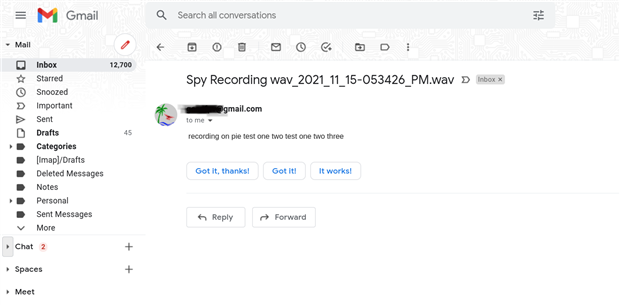

Now if you have successfully got to this point you are ready to download the python program attached below,  which will send you/the spy an email with the text in the email body of the spy recording on the Pi 4. And, if you want to refer back to the recording stored on the SD card the name of the wav file is in the subject of the email. Here is a sample email sent from the Pi4.
For a video demo, please refer to the video in the previous blog post(Pi Spy Audio Recorder - part 2 - PIR sensor and Email) as the setup remain the same, just replace the Pi Zero W with the Pi4 image - Demo Video for Pi Spy Audio recorder
