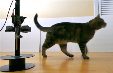

The theme of this project is spy nerd. I am a fan of spy novels, but I am not really into spying on people, so I thought I would have some fun experimenting with spying on my cats. That is about as nerdy as it gets.
I wanted to do something a bit original - something that you can't buy, which meant a nannycam was out. And of course since this is just for fun and not likely to be used regularly, the price needed to be low.
The simple description is several passive infrared sensors and a color sensor that can:
- detect cats or dogs
- detect people and differentiate them from animals
- detect the direction of travel of the animal
- identify which animal is detected
This sensor system requires an MCU to analyze the sensor data and deduce the above information.
To help the MCU, the sensors are arranged in a specific geometry. Two PIR sensors which will detect any hot body are used to figure out which direction the body is travelling by recognizing which one was triggered first. The third PIR sensor is aimed higher than pet height so it only detects people. This sensor can be used to confirm that the other sensors are seeing a pet and not a person. The final sensor is a color sensor that is used to figure out which pet is detected by their chacteristic color. We have 2 cats that have different coloring.

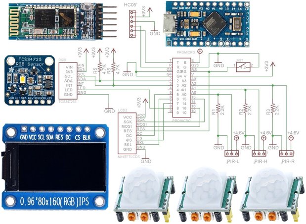

The Schematic
Here is the schematic of how the electronics are hooked up:

The project was a lot of fun even though it involved a lot more mechanical design than electronic design.
The PIR sensors and their shrouds work extremely well, very reliably detecting the cats and their direction. Both the PIR sensors and the color sensor are passive - they do not emit any harmful radiation or even ultrasonic noise.
The color sensor was a lot more problematic. Although the telephoto lens did a great job of allowing colors to be detected at a distance, it needs the lighting to be pretty consistent and the firmware needs to employ a lot of normalizing and other clever analysis techniques. Daylight is way different from artificial light and each light has a unique spectrum. The color sensor datasheet indicates it can do a decent job if you have a way of calibrating it. It might need a separate color sensor just to sort out what the ambient light composition is.
If you use one of these interesting color sensors, be prepared to mess around for quite a while tuning it to your application.
Training cats to walk in front of a sensor so you can tune up its performance is just wishful thinking. This made tuning up the color sensor extremely challenging, and it still isn't where it needs to be.
The mechanical design successfully attempted to utilize an empty filament spool as a stand, and now that I have a working way to adapt a spool to a shaft, I may find more uses for all my empty spools. The plastic shaft is from a Dollar Store toy.
Considering the system has an MCU, a color graphics display, four sensors and 8 custom plastic parts, the total cost of under $15 was a nice achievement.
It took some meticulous measurement work to ensure the color sensor chip was exactly where the lens was focusing the light, but 3D printing eliminated a lot of fiddling around with files to adjust position.
Overall I learned a lot and it is always fun to see how cats respond to new situations. I was very happy with the way the PIR sensors worked and that the telephoto lens worked so well with the color sensor.
