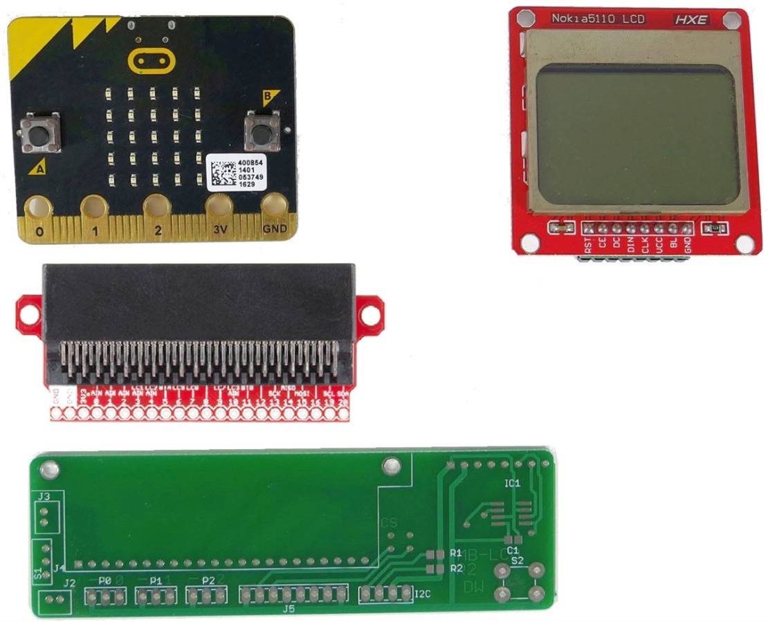

This Project14 blog is about turning a BBC micro:bit into a test instrument. I call this a micro:bit of sense system or µBOSS.
The micro:bit already has a nice set of sensors but they aren't very easy to read on the built in LED display, so I thought I would display all the sensor readings on an LCD, turning it into a test instrument that has the following capabilities:
  • Thermometer
  • Volt Meter
  • Compass
  • Digital Level
Additional features include a lithium-polymer battery and a rectangular 3D printed case that allows flat surfaces to be measured for levelness.
The electronic design is based on a custom interconnect PCB that hosts a micro:bit connector, an LCD footprint, a power switch, a analog input connector and a charging connector.
The main parts look like this:
The micro:bit is programmed to display 6 sensed parameters on 6 lines of text.
Here is a video demonstrating the completed system:
The LCD really allows the micro:bit built-in sensors to be fully displayed.
I have been perfecting the the connection and programming of an LCD with a micro:bit and this project is a good way to demonstrate the potential of an LCD to enhance a micro:bit.
There is a deceptive amount of work involved in getting everything connected properly, programmed properly and fit properly in a slim package, but that also makes it more satisfying when it all works.
