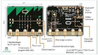

Tid Bits
The micro:bit is an open source hardware ARM-based embedded system. It is half the size of a credit card.  It features a 32 bit ARM Cortex-MO processor, built in light and temperature sensors, motion sensors (accelerometer and compass, and magnetometer sensors,  wireless communication via radio and bluetooth, USB connectivity, 2 programmable buttons, 25 programmable LEDs, 2 programmable buttons, and 25 external connectors along the edge of the board. The micro:bit is designed to play nicely alongside other SBCs such as the Raspberry Pi.  It's a microcontroller that's easier to program then the Arduino, provides much of the same flexibility as the Raspberry Pi, and is supported by multiple programming languages including the Arduino IDE, C++, and Python.
You can use it in your test equipment build as a supporting wearable device and take advantage of its radio and bluetooth communication, sensor control, I/O, and ease of use.  Because it plays nicely with other SBCs, it's got a lot of intriguing uses for your own diy test instrumentation,
