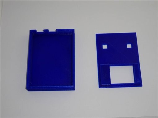

The first step was to print a case to house the Micro:bit and display.

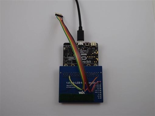

The second step was to provide the interface for the second module.  The second module needs the I2C pins to program the DAC and an Analog pin to read the current sink voltage plus power pins.
Micro:bit pinFunction
19SCL I2C clock
20SDA I2C data
0Analog In 0
3V33.3V power
GNDGround
Unfortunately, the LCD shield that I'm using only provides the breakout of the pins that the shield uses so I needed to solder wires directly to the shield connector pins.

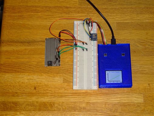

For now, I've decided to implement the second module on a breadboard so I won't print a case for it yet.

Hardware setup:
Video of Curve Trace:  Linear trace of current through a fixed resistor
Summary:
I basically just verified that I could get the hardware and software interface working for a Micro:bit Curve Tracer.  It still needs some work to get it functioning as I'd like.  I would like to add remote logging via Bluetooth in addition to just using the LCD display for output.  Remote control via Bluetooth would be nice also.  I need to add some configuration code to allow scaling for different voltage and current values.  I also need to add calibration values to allow running with different power sources (I am using the 3.3V supply as my DAC and ADC references and the supply value changes with power source - i.e. USB vs battery).  And I need to package the second module.  But all that will have to wait for another day....
