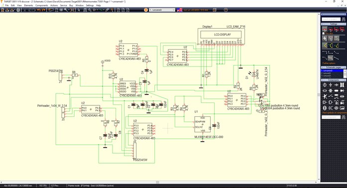

The schematics
It won’t be surprising how I started drawing. I found the schematics of the PSoCRegistered 4 CY8CKIT-049 4200 Prototyping Kit, removed what wasn’t necessary and added all the components from the breadboard.
Just a few notes about the design:
J1 is a power connector and the idea is to power the device directly by 2 AA or AAA alkaline batteries.
J5 is a connector intended for UART. I might find it useful in the future, but it is not implemented at the moment.
There are two push buttons and one LED. The LED has no function and only one of the buttons starts the measurement. The other button has no function. Both buttons have unpopulated pin header in parallel with them. My idea was to embed the device into a box, but leave the possibility to control the thermometer without the box, too.
Here comes the full schematics. I know, it is kind of chaotic.

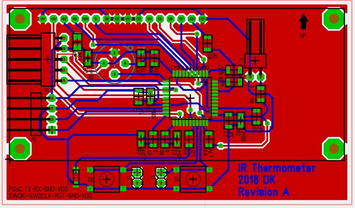

PCB

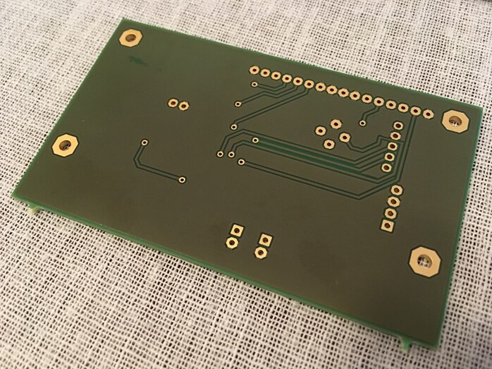

And the PCB I drew based on the schematics. My first PCB sent to a PCB manufacturer ever image

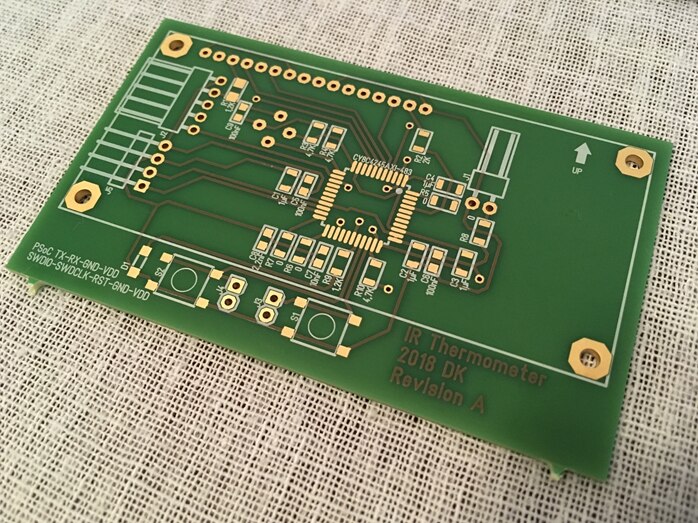

I ordered the PCB at a smaller Czech company to show some support to local companies. My friend helped me to prepare the data (especially for the pool service, which makes the PCB cheaper). I thought exporting should be easy, but it is worth asking the manufacturer about formats etc. to avoid additional costs of manual adjustments at the manufacturing facility.
One week passed and this is what I got:

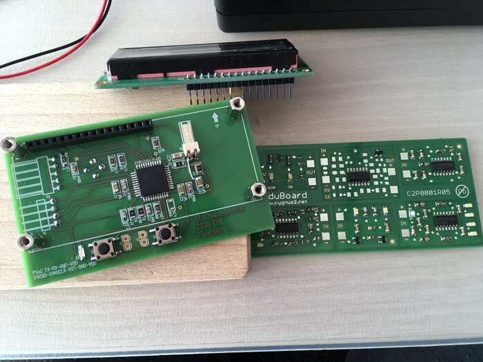

I also knew that I wouldn’t be able to solder the chip with my current soldering iron. So, this was a perfect excuse to buy a new one, with a finer handle and a tip. Plus, better solder and flux. I have seen many videos on YouTube and they have one thing in common. Professionals looking for a professional outcome use a good quality soldering iron, solder and flux.
By the way, have you seen this series of soldering in avionics industry? Must see for everyone looking for a professional soldering result. https://www.youtube.com/watch?v=0SnOW2VdCTI . I don’t say all should do it this way, but it is worth knowing all the steps.

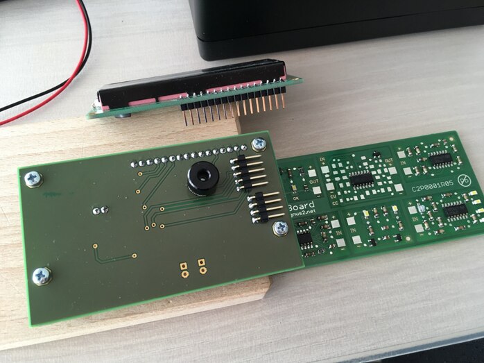

Here is my soldering. On the left is the thermometer PCB, on the right is a simple practice board bought for a few Euros. I highly recommend practicing after longer periods of not soldering.
As you can see, there is a jumper wire between the power connector and ground of the remaining board. I made an error concatenating signals, which was discovered after assembly image

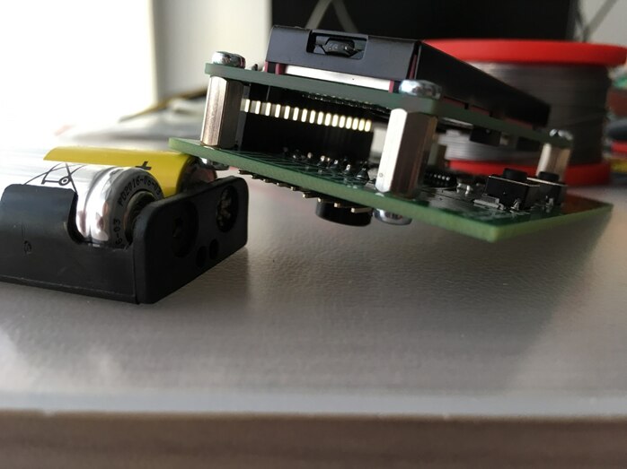

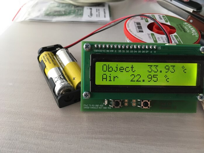

And last, finalized assembly of version 1.

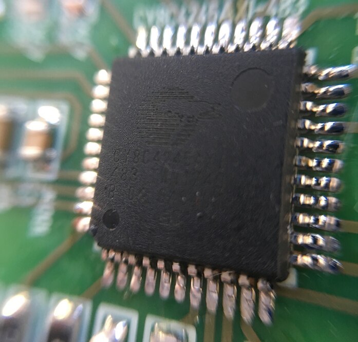

Did it work on the first power up? No – it took me a week to figure out I rotated the chip by 180 degrees. The chip has two circular markings at the edges and when I soldered the chip, I haven’t noticed it. The smaller one is the correct (and mentioned in the datasheet). Fun fact: according to the datasheet is the chip label irrelevant to the chip orientation.
Fortunately, I was able to remove the chip using a common hot air gun (not for soldering) and solder it again.
Did it work on the second power up? No – it took me another week to find a missing ground connection.
