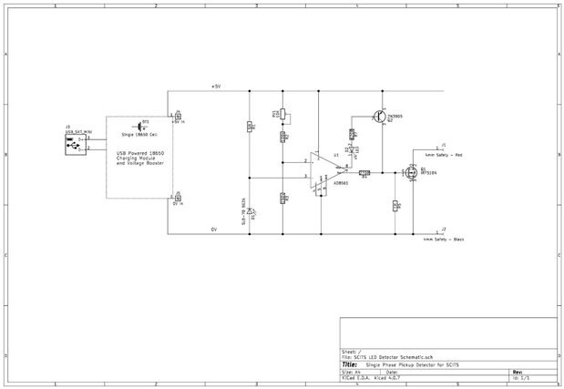

I have been trying to build up a Pick-up Indicator Test System (PITS) to detect the overcurrent indicator on protection relays I test, for the project14 test instrumentation.
Once  I figured out that there are some photo diodes that respond better to green LEDs than others, I managed to get the circuit working. However, I then decided to add an output indicator off the negated output of the AD8561 comparator chip I was using. After adding this, both outputs of the comparator remain low and the LED is on all of the time.
When I drop out R6, the 10k resistor to the pnp transistor base, the circuit starts to work again.
Anybody have any ideas what I am doing wrong? The only thing I can think of doing is to increase the size of R6, I had originally calculated this as 14k for a 1mA base current, but from my limited selection, 10k was the closest I had.
I also find that when turned on, the MOSFET has a resistance of 780 ohms, which seems a little high to me?

    jc2048 over 7 years ago +9 verified
    Your transistor is upside down - you've got the collector and emitter swapped. A transistor will work like that, but the gain is very much less than if you use it the right way round so you'd only ever…

  • three-phase
    three-phase over 7 years ago in reply to 14rhb +4 suggested
    Hello Rod, Many thanks for your help. I have read through the data sheet for the AD8561 and it does not say much about the outputs and if they are differential or inverse from one another. I have just…

  • jc2048
    0 jc2048 over 7 years ago in reply to three-phase
    If it turned out you did need the hysteresis, the datasheet has a section explaining how to implement it.
    BTW there's nothing wrong with having the LED drive and MOSFET drive separate, indeed from a design point of view it's probably better - I just thought it was neat that with a 5V rail you could use the 3V drop of the LED to do the level translation up to the transistor and combine the two.

    0 dougw over 7 years ago
    I would flip Q2 (emitter to +5).
    That opamp may not drive high enough to fully turn on the FET.
    Switching R5 to be a pull-up instead of a pull down should help, but it may need to be adjusted to get the optimum thresholds.

  • three-phase
    0 three-phase over 7 years ago
    With the helpful answers, I have made some adjustments and have a rudimentary system functioning.
    I have increased the pull down resistor to a 680k in series with 300k. Testing this, the resistance of the MOSFET dropped to 22.1 Ohms with the comparator turned on. So I think for a more final version, I will get a 1M resistor as suggested by Rod.
    I then utilised the circuit identified by Jon and can get the LED to light when the comparator is turned on. An added bonus is that the voltage to the gate on the MOSFET has now increased to 4.51V from 3.38V and the resistance of the MOSFET is down to 1.3 Ohms when it is on.
    Many thanks to jc2048 and 14rhb for your timely assistance, much appreciated.
