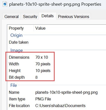

  • Found a solution for creating icons!
    Step 1: Create the icons in a graphics program, using any anti-aliasing capabilities it has.
    Step 2: Save as a PNG file; it could be a file per icon, or join all the icons in a row etc. I joined them all in a row. My icons here are 10x10 sized, and there are seven of them, so the PNG file was of size 70x10 pixels.
    Step 3: Go to LVGL Image Converter site: https://lvgl.io/tools/imageconverter
    Step 4: Select your PNG file to upload, and then choose RGB565. Click Convert, and it will generate a C file that will be saved on your machine.
    I used this 70x10 pixel PNG file:
    Here is the output:

    The array could be copy-pasted into the project source code. There are 1400 bytes in the C code that was generated, i.e. 2 bytes per pixel. I don't know the ordering, but it shouldn't be too hard to figure out. This amount of bytes would be better saved to external Flash though, or the extra space in the ESP32. It's too wasteful to save in this format for the Uno R4 board. It could be compressed easily, since there are only 12 colors used in the entire PNG file, so 4 bits per pixel could be used instead of 16, so that's a quarter of the size, i.e. down to 350 bytes, plus the 12 16-bit colors (24 bytes), i.e. 374 bytes total for all the planet icons.
  • Possible planet icons (Mars is distinguished by being red!). It would be good for someone familiar with graphics to design these, since some anti-aliasing etc would help!

  • Also, how is it possible to display planets?
  • I've been playing with this too - trying to get Starmap to run on a CYD - "Cheap Yellow Display". The big hurdle for me is how to load the star catalog into the ESP's memory... I'll be watching updates to the hpsaturn's repo Slight smile
