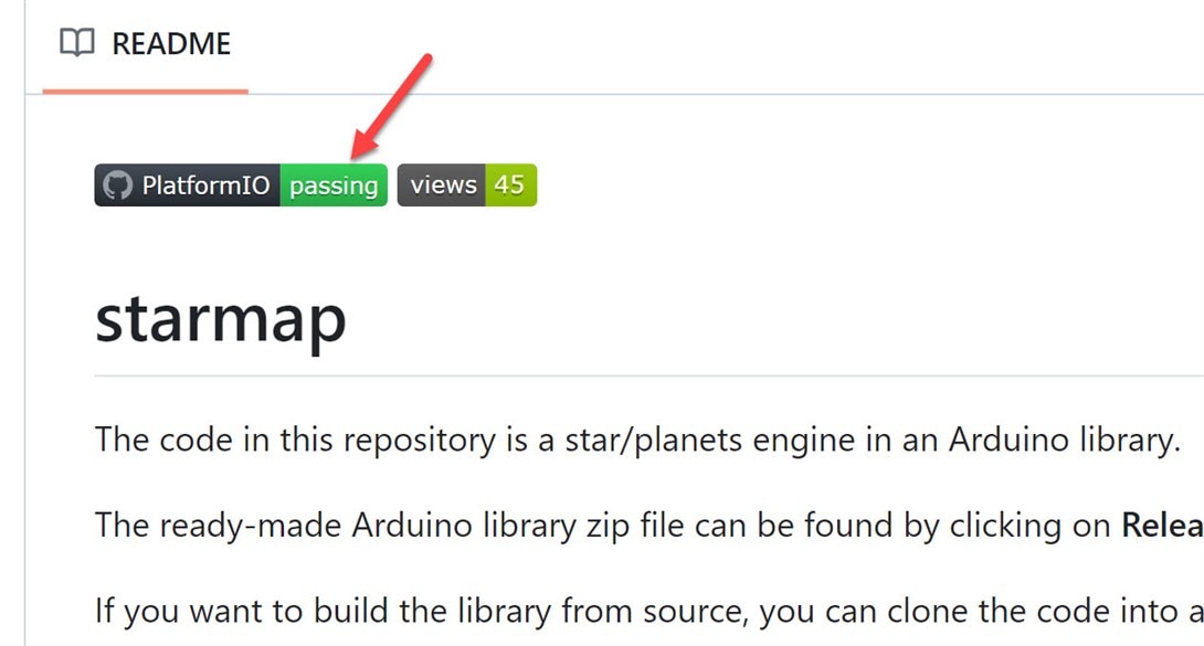

Although the starmap library zip file is provided, you may wish to improve the library, or run tests on Linux. If you're only interested in running the code, you can skip this section.
Here's how to use the source code.
The github repository needs to be installed on any Linux machine (it could be a Raspberry Pi). I created a folder called development, and then placed the repo content there:
