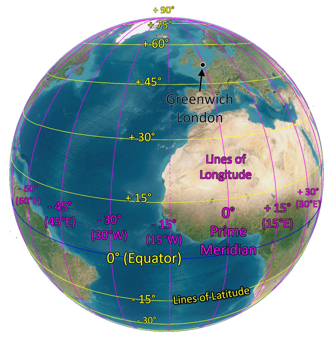

In the introduction of a book called Longitude, Neil Armstrong mentions how Pope Alexander IV drew a vertical line from North to South, and assigned all lands to the two top maritime powers of Europe: all lands to the west to Spain, and all to the right to Portugal. The problem was, no-one knew where the line fell!
The problem of identifying precise longitude was of high importance, because sailors would routinely perish, because of the difficulty of determining where land was.
Latitude (how far up or down the globe) was not too difficult to figure out, because it could be determined in several ways; by the season and length of the day, or measuring the angle of the sun, or you could search for particular stars (for instance the North Star) and measure its angle to the horizon. In brief, a quick way would be to measure the angle of the sun from your visible horizon, and subtract it from 90. Then, a correction is needed because the earth tilts up to plus or minus 23.4 degrees over the course of the year; it's seasonal (about +23.4 degrees in mid-June, and -23.4 degrees in mid-December, and is close to zero mid-March and mid-September), is easy to calculate, and is called the sun's angle of declination. You'd need to subtract the magnitude of the sun's angle of declination (Python example code to calculate it), to get an accurate result.
However, longitude starts at an arbitrary man-made position (it happens to be in Greenwich, London). There are many stories of ships traveling the wrong distance east or west around the globe, and (if not crashing into rocks), poor longitude estimates resulted in overshooting or undershooting land, and, with depleting food, and risk of scurvy, the captain deciding to turn around, and traveling for days or weeks, only to then realize that the first direction must have been correct. Just on one voyage, two thousand sailors on four warships died for want of better navigation, and eventually, the UK government issued a reward (worth millions in today’s money) for a solution. It went unclaimed for more than half a century.

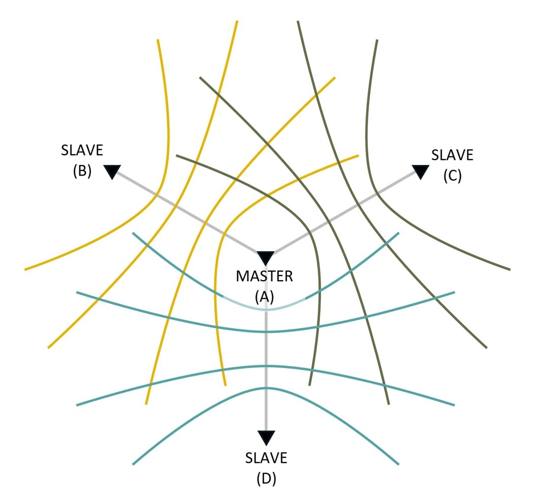

This opened up a whole range of possibilities, collectively known as hyperbolic navigation systems. If you have two transmitters transmitting in phase, or transmitting pulses simultaneously, then if a receiver is exactly halfway between the two transmitters, then the signals arrive in phase (or pulses arrive simultaneously). If, however, the receiver is at a different location, then there will be a phase or delay difference. The difference remains the same if the receiver is at any location which traces a hyperbola. The diagram below shows why.
The concentric circles emanating from one transmitter site indicate the positions where signals arrive at fixed times. If you try to intersect those circles with those from the other transmitter location, such that the difference between the pairs of ranges always remains a fixed distance, then hyperbolae are traced out. All the hyperbolae in the diagram below, have the same fixed difference of phase or pulse, the colors are just to identify separate lines or ‘lanes’, but if the receiver is on any of these lines, the phase difference is the same. For any given delay or phase difference, it is possible to plot a set of hyperbolae.
What the above means is that if you have a way of measuring the phase difference or pulse arrival delay between the two transmitters, you can place yourself on a set of hyperbolae. You won’t know which of the hyperbola lines you are on, however.
Various things can be done to try to identify the particular hyperbola out of the set. One method is for the two transmitters to sweep through phase relative to each other. That results in the hyperbola lines bending as the phase changes so that the receiver sees a time-varying signal strength, an increase in received signal when they are on a hyperbola, and a decrease when they are in between two lines. Then, timing can help identify which hyperbola you’re on. Another method is to switch to a lower frequency, so that there are fewer hyperbola lines temporarily, so that the receiver can coarsely resolve, before switching to a higher frequency.

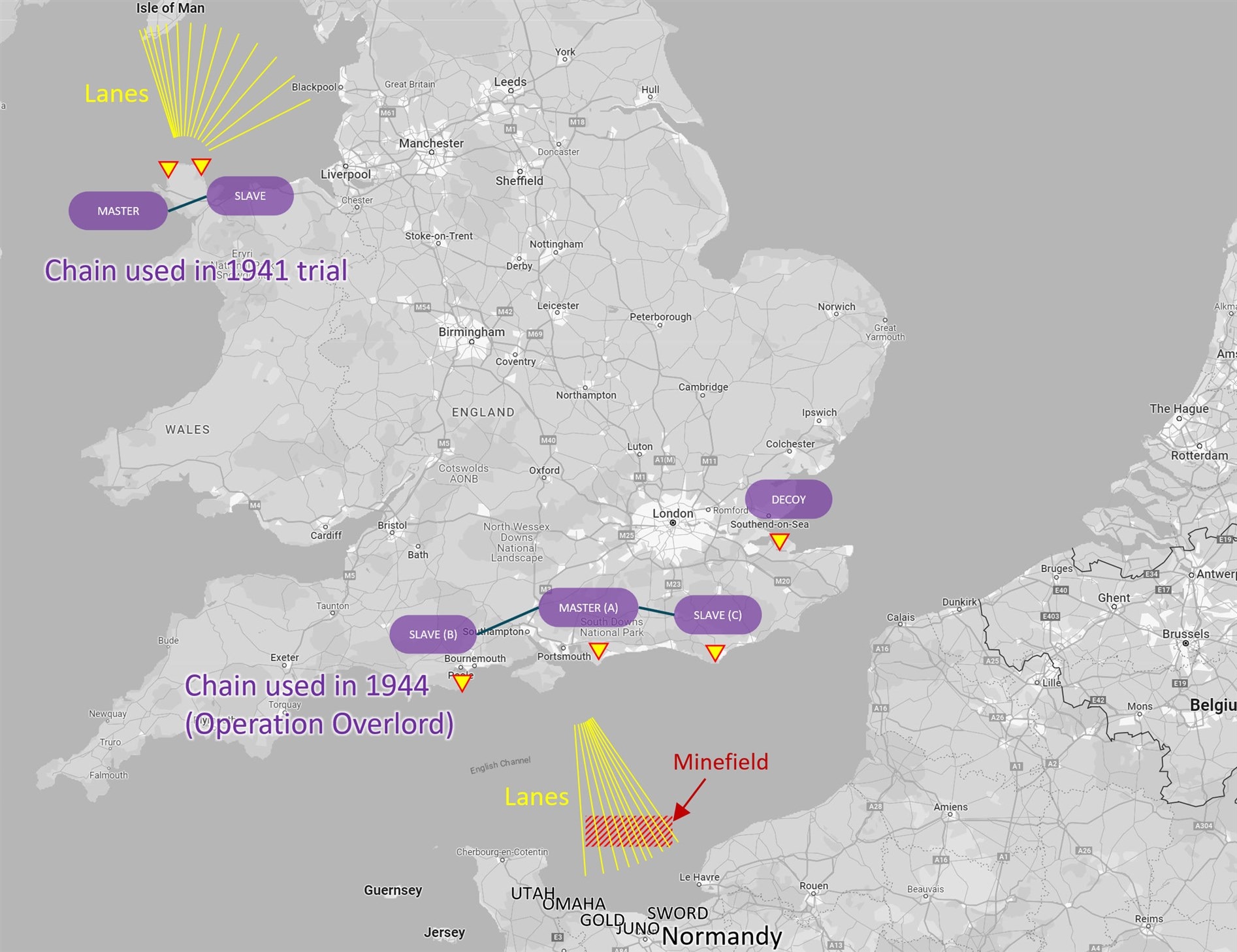

Just as shown in the earlier diagram, hyperbola lines could be drawn at any phase relationship, for instance when the signals are in phase, at zero degrees.
The lines were used as ‘lanes’ during Operation Overlord, creating invisible paths through the English Channel towards Normandy. Minesweepers followed those paths, allowing ships and landing craft to follow.
The receiver didn’t use an oscilloscope but instead used a center-zero meter that would display the phase shift. The lanes were separated by several hundred meters. A tiny movement (a few feet) off one of the lanes would cause a phase shift from zero, which would move the meter needle significantly. By seeing the number of deflections, the lines could be easily counted. After WW2, further improvements to the system were made, so that lane counting became unnecessary. By the time the system was fully mature, the transmitter sites were transmitting signals at different frequencies, over a 20-second period, repeatedly, and the sequence was quite complex. A very good collection of information about the Decca system can be found at Jerry Proc’s website.

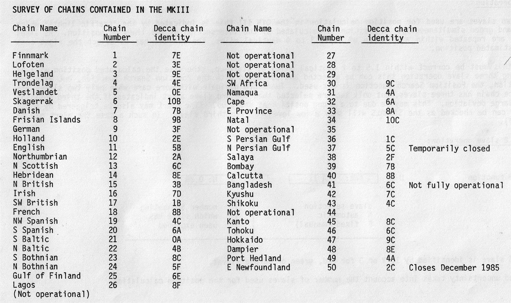

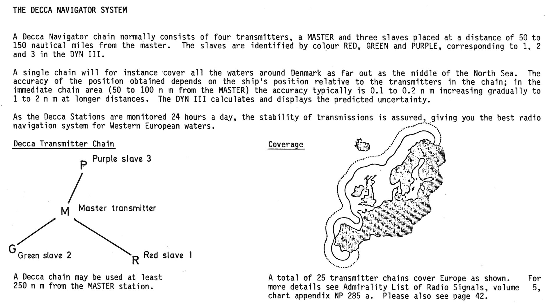

By the 1980’s or so, there were about 50 chains deployed. The diagram below shows the European chains; 25 were deployed there. The circled values are unique chain numbers. The slave transmitters within each chain had color-code identifiers (red, green, purple).
Image source: Philips

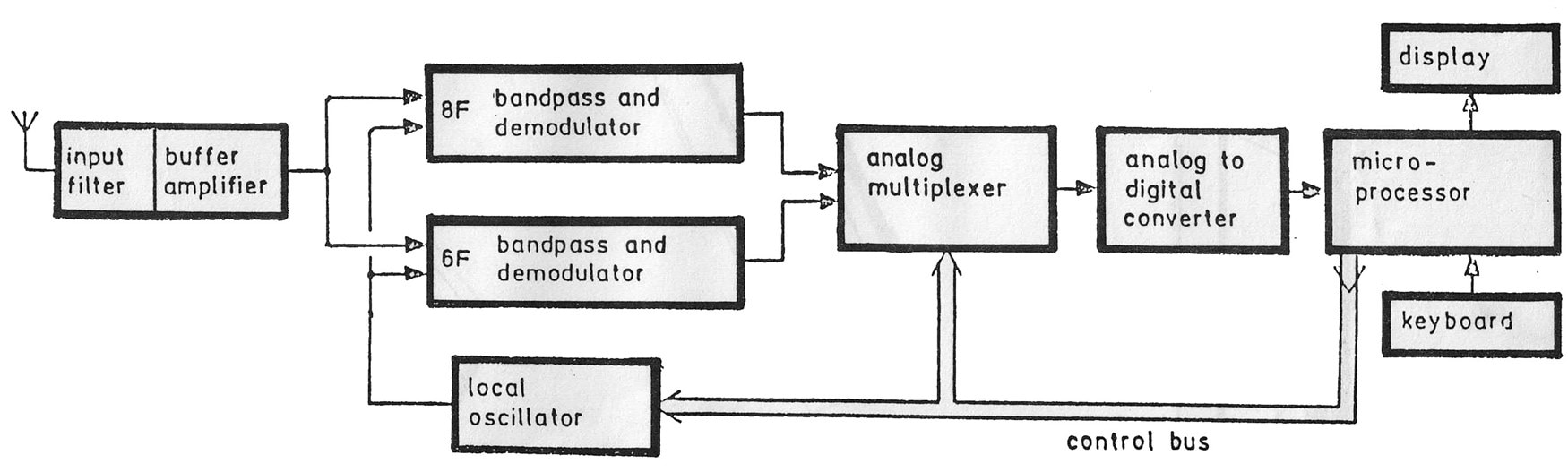

The user manual contains the following hardware block diagram; you can see that there are two receivers, one at the 6f (master) frequency, and the other at the 8f (slave) frequency. However, I’m not sure why the diagram does not mention the 9f and 5f frequencies for the other slave transmitters. Perhaps the box labeled 8f can be tuned to the other frequencies.

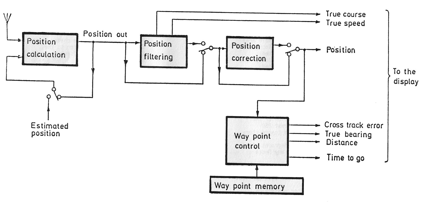

There’s also a software block diagram, although that doesn’t reveal as much as I’d like either:

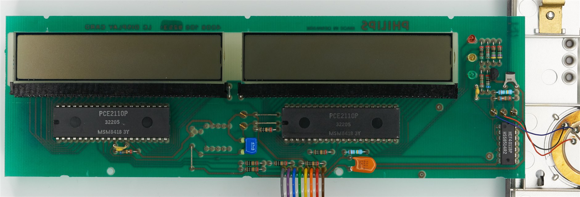

The top half of the enclosure houses a PCB containing two LCD screens and drivers for them, plus a piezo beeper. The touchpad keyboard is not accessible without peeling off the front panel, which I didn’t do.

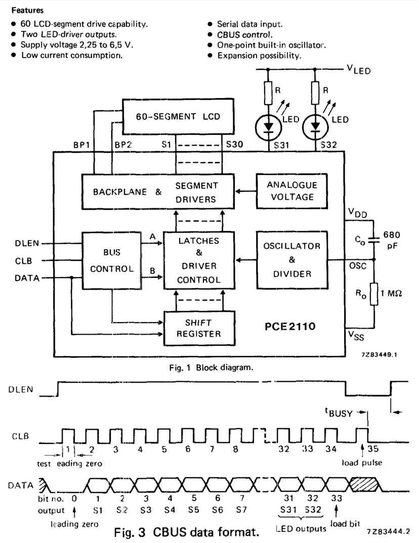

The LCD driver uses an old simple serial interface called CBUS, which is very SPI-like.

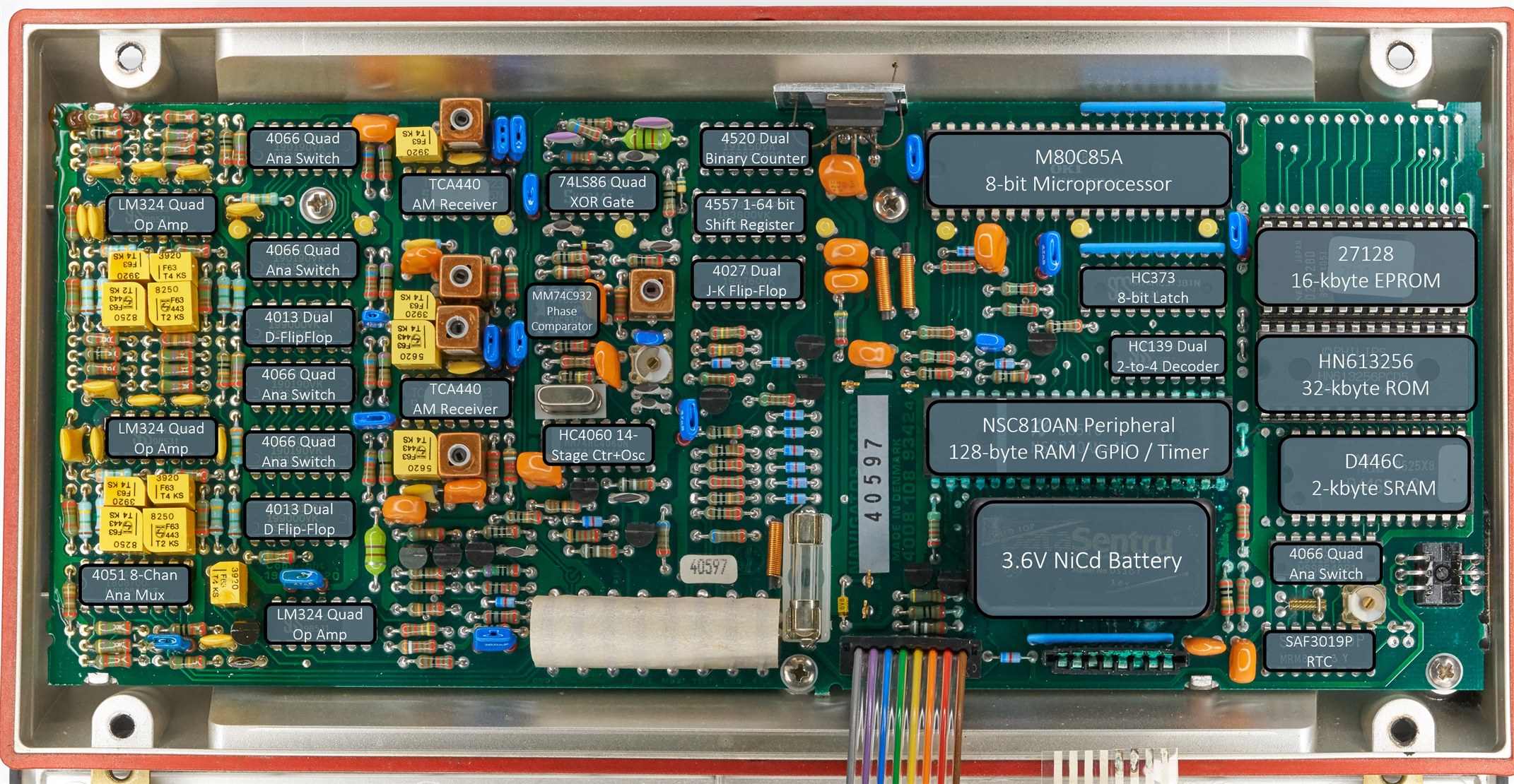

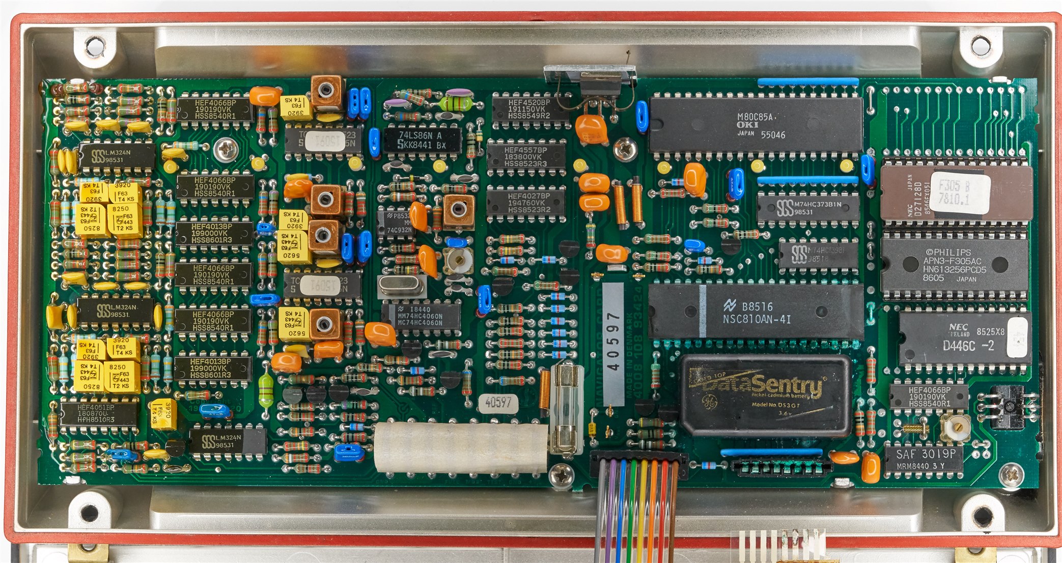

Back to the main board, here is an annotated view of it:

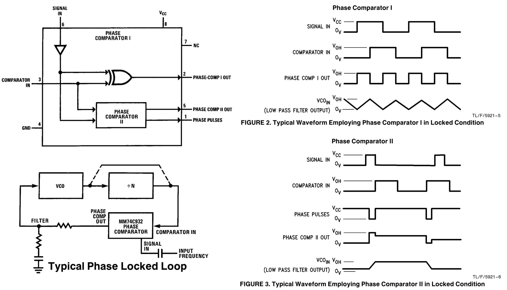

There are quite a few interesting parts on it! There’s lots of CMOS logic. The main crystal (5.24288 MHz) oscillator is at the center of the board. I’m guessing the parts at the center of the board form a frequency synthesizer, but I have no idea, and I couldn’t find a circuit diagram. The MM74C932 DIP-8 chip above the crystal is a phase comparator IC.
There are two TCA440 RF receiver ICs. One is likely used for the master signal, and the other for one of the slaves, i.e. different slave reception may be sequential.

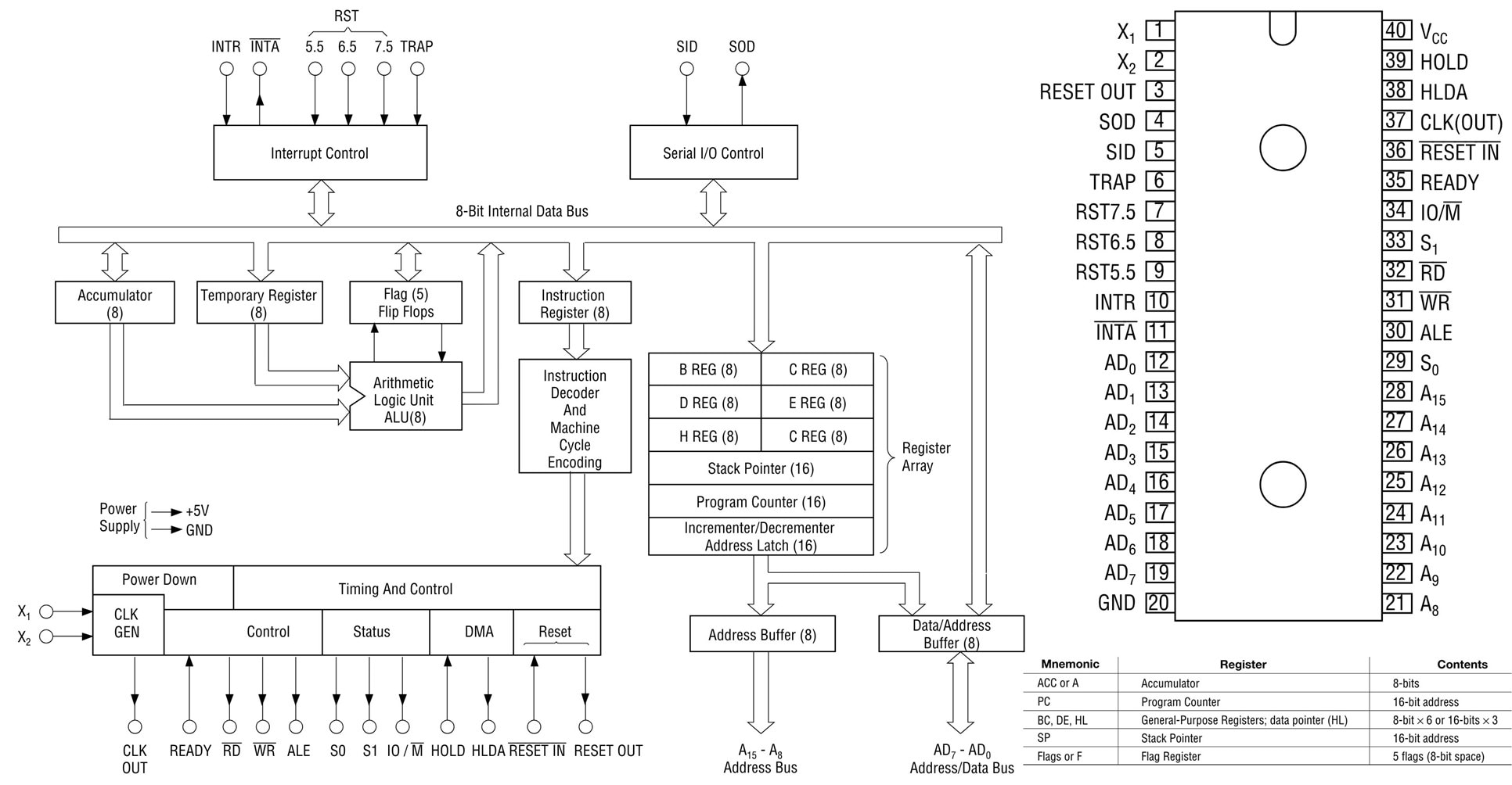

The M80C85A chip at the top-right of the board is an 8085 microprocessor.
Interestingly, there is both an EPROM (27128) and a mask ROM (HN613256) on the board. I’m guessing the mask ROM contains tables chain data, such as locations, chain IDs, and frequencies, and the EPROM contains the firmware. Both the EPROM and ROM are in sockets, so I removed them and read out the information (if you’re curious what’s in there, the files are uploaded to the Elektrotanya website, search for ‘decca yacht’).
There are not many text strings (the 7-segment LCD digits only show numbers), but there was some text at the end of the EPROM.

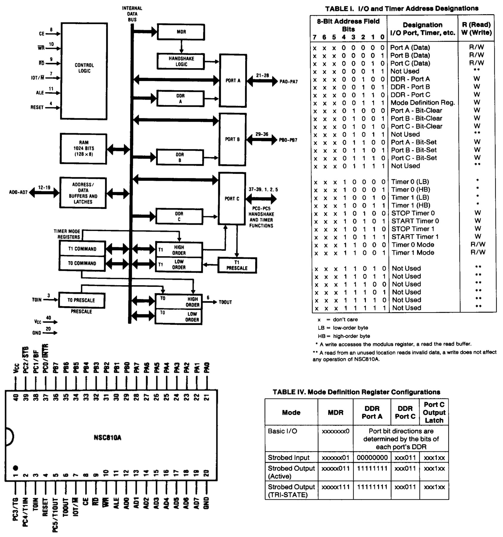

The NSC810AN chip contains several useful peripherals for a computer system.

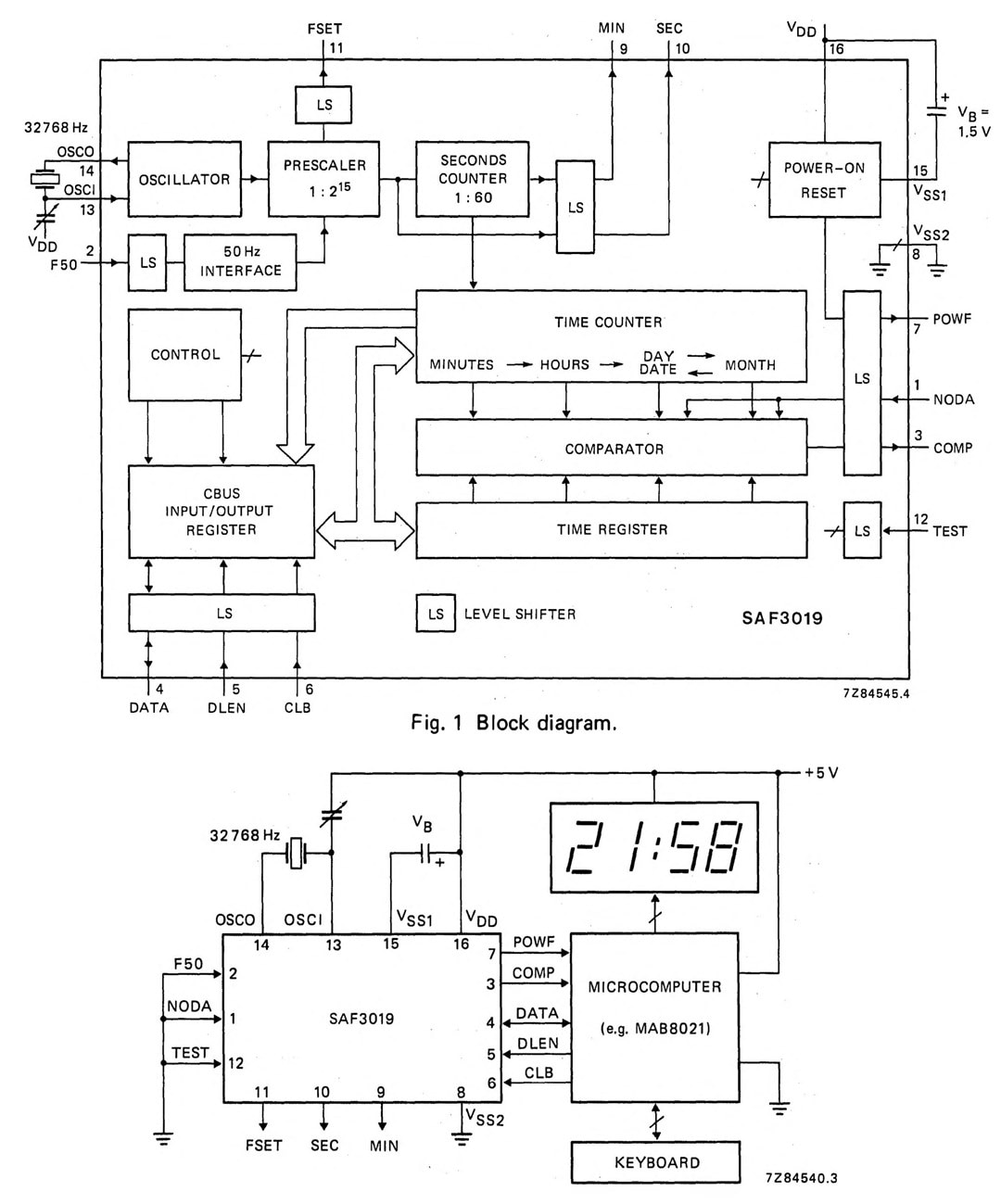

The lower right of the board contains the real-time clock chip (SAF3019) and a 32.768 kHz crystal.
