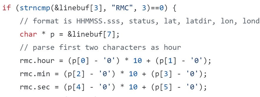

  • Oh, I see. Well spotted.
    I'll have to run some tests for longer. This was the code in the Teseo library that I wrote. I'll modify it to print the output for a while and see if I'm parsing it incorrectly; maybe I've made an incorrect assumption about the time format string.
    EDIT: I've checked the raw footage (which ran for a bit longer) and I can see that the gap between 19:11 and 19:12 was 60 seconds. So perhaps there's some bug related only to the transition from 10 to 11. Weird. Anyway, I'll experiment a bit to get to the bottom of it.
  • To be honest, updating live location doesn't matter unless you are traveling so that makes sense. I meant the time shows 19:10 around 2:25 and 19:11 around 2:50, 1 minute has passed within 30s in display. There's no way GPS messages return time like that. Could be a bug in gps message parser.
  • The entire demo portion of the video (from 1 min 58 sec, to the end of the video) is unedited : ) It really is that fast! : )
    I've just not used a GPS module for ages, so I don't know if the ST module is exceptionally quick, or if most GPS modules nowadays perform as well as it is doing. Maybe it's a good antenna on the board (and it's repeatable; I have tested two more copies of that GPS receiver board, built on PCBs, and they appear just as sensitive).
    All the powered-up photos and video were taken yesterday, and all contain the genuine time. The lattitude/longitude values are what come out of the GPS module, but for the video have a deliberate small fixed offset added, because it was landing right on my home : ) Any value that arrived from the GPS module automatically had the fixed offset added.
    The lat/lon values are not updated on the display every second, for no reason other than that's just the way I coded the example .ino file. It could easily update every second if needed. I simply decided to update the entire chart every five minutes (since the star positions will not change over that period, even if traveling extremely fast. I tied the lat/lon indication to the chart update, but it doesn't need to do that, it could be easily modified to update say every second.
    The time however updates every two seconds, again an arbitrary decision, since the display only shows hours and minutes anyway. Any new satellites that are detected, are updated every two seconds too. All these values can be modified in the .ino file
