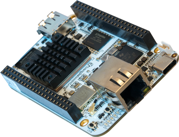

INTRODUCTION
As of December 2019, the BeagleBone AI (BBAI) software is presently in an early community development state.  It requires a certain combination of a kernel version, code tweaks, and trial and error pin settings to get the packaged examples working.  The official system reference on GitHub has many "TBD/TODO" statements for the critical functionality of the board.  Several tables are for the BeagleBone Black which are not matched to the BBAI chipset.  The time-tested BeagleBoard code libraries at the time of hardware release are still developed for the past architectures.  So, I converted my hours of research here in hopes to save some time for other BeagleBoard beginners like myself with the desire to explore the BBAI.
Way below are some key references to keep your eye on as the BBAI develops.  Last, for document versioning of this blog, I'll use this convention to keep track of changes to this blog:  Whole versions for when new software is added, decimal versions when I change the instructions only, and no version increments if I'm just correcting my Kentucky English.
