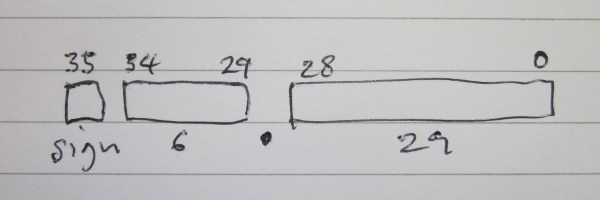

One of the first things I needed for the project was a real number representation. Verilog does not support real numbers, so they must be implemented by the designer. The most common ways to represent real numbers are floating-point [5] and fixed-point numbers [6]. Floating-point numbers are what floating-point units (FPU) use, these numbers contain a sign bit, mantissa bits and exponent bits. There are standards like the IEE754 [7] that have standardized floating-point number formats such as the single precision (32 bit) and double precision (64 bit), but their implementation in hardware is quite complex and slow so I discarded them. Fixed-point numbers are on the other hand relatively easy to implement. Fixed-point numbers are treated internally as integers, except that they represent the numerator of a defined power of 2 denominator. Let’s take a closer look at how fixed-point numbers represent real numbers.
There are many notations to specify fixed-point numbers, but I’ll use the Q-notation [8]. A Q5.10 fixed-point number represents a 16-bit number that contains an implicit sign bit, 5 integer bits and 10 fractional bits. Q15 represents a 16-bit number with an implicit sign bit, no integer bits and 15 fractional bits. A “U” prefix indicates that there is no implicit sign bit, such as in the 16-bit fixed-point UQ6.10 and UQ16. UQ6.10 represents a 6 integer bits and 10 fractional bits fixed-point number, while UQ16 represents a 0 integer bits and 16 fractional bits fixed-point number.
It might be easier to understand how to work with these numbers with some examples:
The Q3.4 number “0011.0111” represents the number 55 / (2 ** 4) or 55 / 16 (or 110111 / 10000 in binary) or 3.4375. One way to think of fixed-point numbers is as the integer numerator of a fixed denominator.
To perform an addition, you would just add the numbers, it doesn’t matter where the fractional digits begin, the result is would be the same. For the FPGA (or a CPU) its just an integer addition. Here is an example:
0011.0111 + 0001.0110 = 0100.1101 would be in decimal 3.4375 + 1.375 = 4.8125 or (55 + 22) / 16 = 77 / 16. It’s the same when working with signed values as it’s a two’s complement [wiki].
Multiplications are a bit different:
0000.1000 * 0010.1100 = (8 / 16) * (44 / 16) = (8 * 44) / (16 * 16) = (8 * 44 / 16) / 16 = 22 / 16 = 1.375
As we can see, now it matters the number of fractional bits. So, to perform multiplications you treat the fixed-point numbers as integers (8 and 44 in the previous example) but after multiplying you must divide by 2 to the power the number of fractional bits (2**4 in the previous example).
It may look as if divisions and multiplications by powers of 2 are computationally expensive, but they are not, you can perform them using logical [9] or arithmetic shifts [10], which are bitwise operations that shifts the bits of the operand.
Subtractions and divisions are not much different to additions and multiplications, but other operations, such as logarithms, powers or trigonometric functions are much harder to compute.

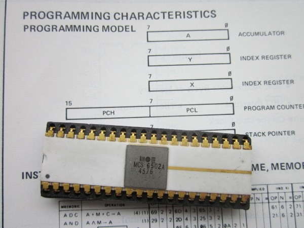

    jc2048 over 7 years ago in reply to clem57 +4
    History. This is the first microprocessor I ever owned.

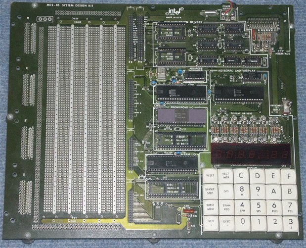

    dubbie over 7 years ago in reply to jc2048 +4
    Well, I do not have the first microprocessor I ever used but it was the 8085 in an SDK board. Programmed in machine code as far as I remember, hexadecimal machine code entry, 7 segment LED display output…
    "...but after multiplying you must divide by 2 to the power the number of fractional bits..."
    But be careful with any resulting sign bit.
    I'm not familiar with Q format, probably because I'm essentially self-taught on using FPGAs. I just do little drawings like this
    This is a 36-bit number with a sign bit and 6 bits ahead of the binary point for something I'm playing with at the moment (more sine generation). The bit numbers above are there to make it easy to see how to manipulate the different parts of the number.

    clem57 over 7 years ago in reply to jc2048
    Curious jc2048 , why are they labeled from high to low bit numbers instead of low to high?image
  • jc2048
  • jc2048
    Well, I do not have the first microprocessor I ever used but it was the 8085 in an SDK board. Programmed in machine code as far as I remember, hexadecimal machine code entry, 7 segment LED display output, 256 bytes of RAM. Ah, those were the days. I wanted to use one in my final year project but they only had three I think and they were given to other students. I had to make my TV to computer monitor conversion out of TTL chips instead. Lots of soldering but it did work!
    Dubbie
