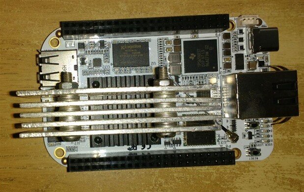

While experimenting with the device, I found that the board would shutdown without warning. The reasons is...
Now I tried a number of combos like us the USB tether, connect with display(yes I have the cursed microHDMI cable) and use standalone but every time, it just overheats if I do anything.
Idle temps are high too. Was wondering if I got a bad board or is it everyone?

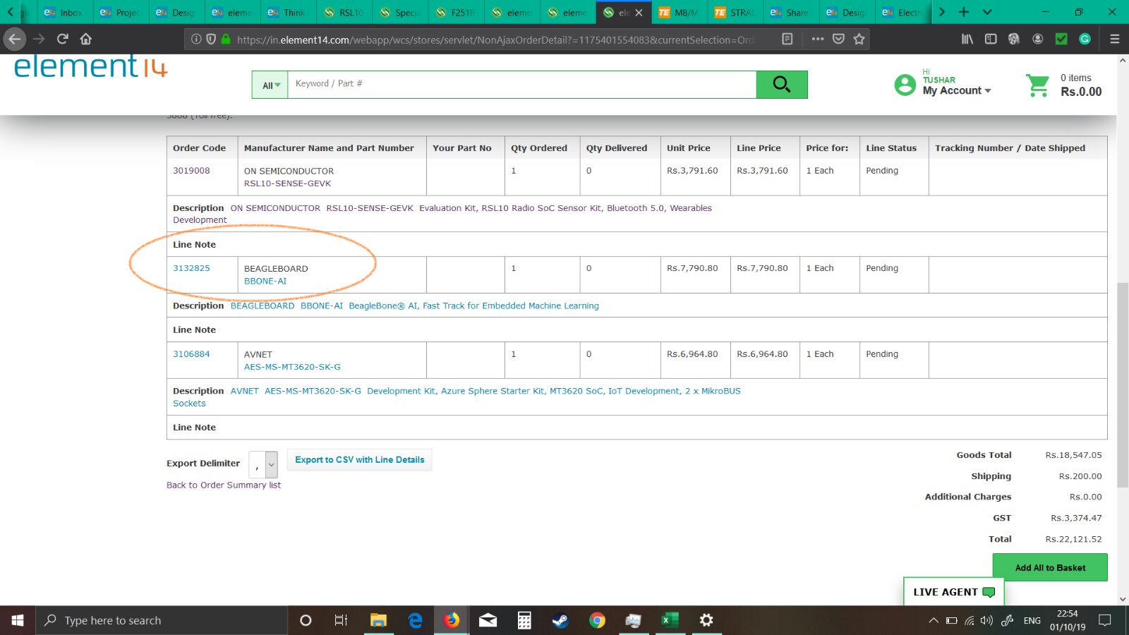

    After seeing all of you in so much trouble I decided - Why you should have all the fun so iI bought this kit too, to get into the same trouble pool.. After all, we all are community members. Cheers to…

    Hi ipv1 , I looked into this and this is a known issue: BeagleBone AI - Frequently Asked Questions (FAQ) They recommend adding a larger heat sink and cooling via fan.

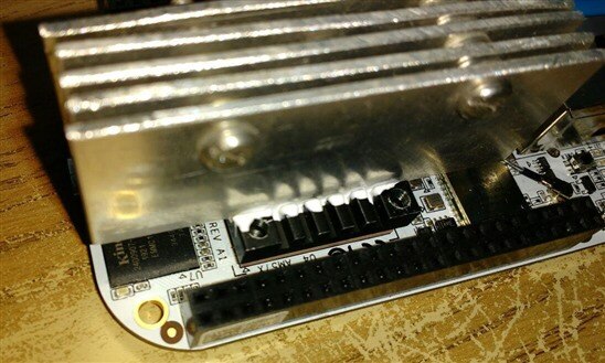

    14rhb over 7 years ago in reply to 14rhb +6
    Hi shabaz - I've made a first prototype which seems to fit quite well. Packing out the top spacing by one extra washer was enough to get it to grip the existing heatsink fins. I'll make a bracket over…

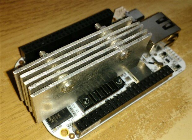

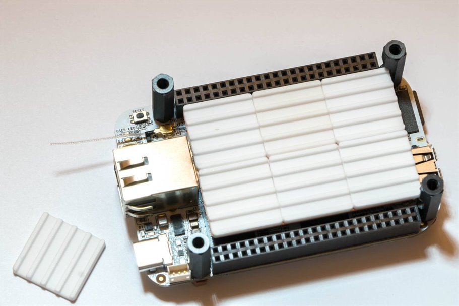

    I went with some ceramic tiles. Looks a bit like the space shuttle heat shields : )
    I'll try powering it up tomorrow. I'm not sure it will be super-effective due to how it was interfaced. It consists of a 60x40x1mm copper sheet, with six 20x20x2.5mm heatsinks20x20x2.5mm heatsinks attached with thermal tape. Then it was attached to the existing heatsink on the BB-AI using more tape. The 60x40 sheet almost does not fit the BB-AI, the plastic standoffs need some dremel'ing with a grinding wheel. I had to do that because I couldn't make the heatsinks smaller, it seemed impossible to cut or sand them, they are really tough. Also, the plastic standoffs needed some trimming in a few places at the junction with the PCB, otherwise they are really close to some components.
    A bit sad that I cannot see the guts of the BB-AI any more : (

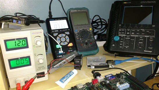

    Good to know, I will try with mine next days. First I will see a real temperature curve while using the board, to have an idea. Then probably adding a small fan is the faster solution I can afford here with the stuff I already have around. Like a CPU fan over the big square cooler. Does it has sense?
    shabaz over 7 years ago in reply to clem57

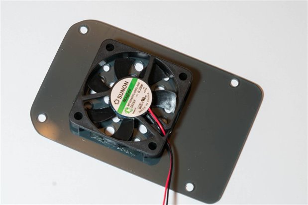

    It's misuse of those mounting holes : ) I wanted to put a cover with fan glued to it on the underside:
    shabaz over 7 years ago in reply to balearicdynamics

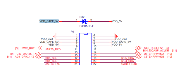

    A CPU fan could work well I think! Looking forward to seeing your results! Are CPU fans 5V or 12V? I've wired the fan I'm using (5V) to the connector P9 on the BB-AI, pins 2 and 8 (GND and VDD_5V respectively), I just directly soldered the wires to the underside of the board.
    shabaz over 7 years ago in reply to mudz
    Hi!

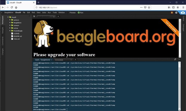

    No idea yet, but I will try to power up later today, and follow the information people have been posting about how to monitor the CPU temperature.

    mudz over 7 years ago in reply to shabaz
    I hope this low wattage fan won't affect power adaptor supply. Hoping for the best.
    balearicdynamics over 7 years ago in reply to shabaz
    As far as I know, CPU cooling fans are working 5 volts.
    Thank you I will keep the same scheme.
    Enrico
  • mudz
    Just noticed there is also a plate behind fan with hole, there might be a problem for air flow. I'm afraid fan might not work at its full efficiency.
    balearicdynamics over 7 years ago in reply to mudz
    These fans are super low power, but don't bet too much on small fans over the desktop board CPU. In that case, they have not serious problems of powering. I am using one of the two macbook pro old model fan that are very low consuming.

    14rhb over 7 years ago in reply to balearicdynamics
    I'm using a 40mm fan out of my junk box which runs at 12v....not sure where I salvaged it from. Fairly sure it wasn't a PC though as it is too small for the usual case-cooling fans.
