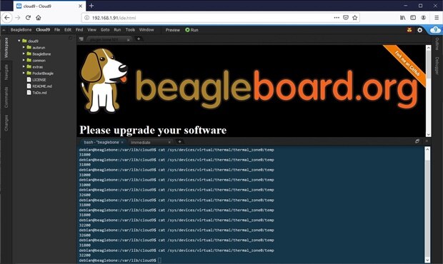

    Parcel arrived with my USB-C cable so onwards:
    Some thermal paste and a 12v fan and I'm finally powered up image
    Temperature measured using gdstew help in Reading BeagleBone AI Temperatures and comes in after 10 minutes at a stable 32 degrees centigradeimage

    clem57 over 7 years ago in reply to 14rhb
    Fantastic work with reducing the heat 14rhb.

  • 14rhb
    14rhb over 7 years ago in reply to shabaz
    Thank you Shabaz,
    It has been powered for a few hours now, I upgraded the Debian OS and I am now installing OpenCV. The temperature is still reported as 34-35 degrees C...the slight increase probably due to the ambient air temp rising slightly through the day.
