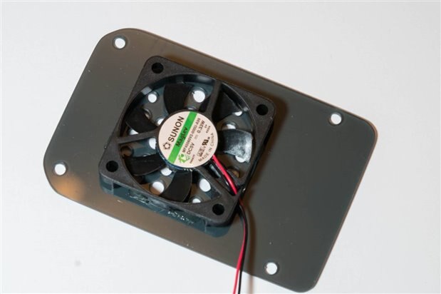

    shabaz over 7 years ago in reply to clem57
    It's misuse of those mounting holes : ) I wanted to put a cover with fan glued to it on the underside:

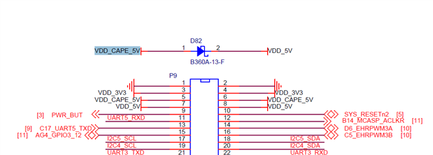

    shabaz over 7 years ago in reply to balearicdynamics
    A CPU fan could work well I think! Looking forward to seeing your results! Are CPU fans 5V or 12V? I've wired the fan I'm using (5V) to the connector P9 on the BB-AI, pins 2 and 8 (GND and VDD_5V respectively), I just directly soldered the wires to the underside of the board.
