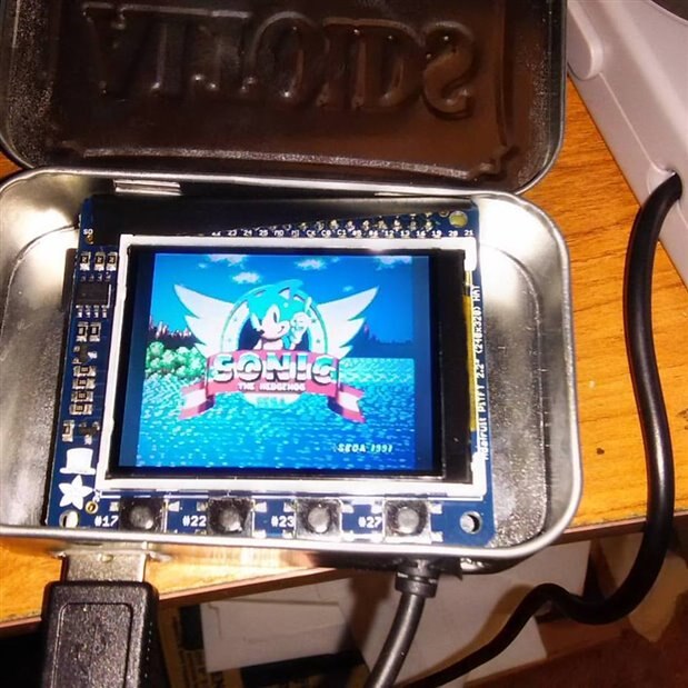

    The Tin Man Heart is one of my photos. image I put a Raspbery Pi Zero and Adafruit PiTFT 320x240 2.2" TFT Display HAT in an Altoids tin.

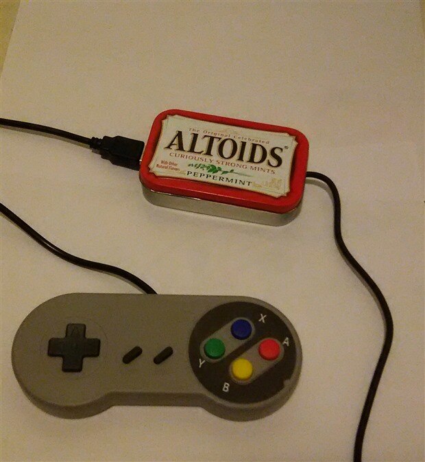

    Here is another one that I made with a different cable config.

    It would be interesting to see if someone else could make a better version of a RetroPie gaming console in an Altoids tin. While the Adafruit display fit inside of the Altoids tin, the buttons that are located under the display are not necessary. One limitation of my original design was that the audio was provided by a USB speaker. It was my intention to put a small speaker inside the Altoids tin but I ran into some issues with creating an audio output for the speaker.
    dougw over 9 years ago in reply to ninjatrent
    I've seen mini USB speakers that would fit in a (second) Altoids tin.
    Or I have purchased replacement cell phone speakers which are much smaller - two could be run from one of those class D amps that is less than a square inch and 3.4 mm high.
  • ninjatrent
    ninjatrent over 9 years ago in reply to dougw
    Thank you for the suggestion. I just found an I2S 3W Class D Amplifier Breakout at Adafruit that will work. It has a built in DAC and will fit in the tin with a small speaker.  https://learn.adafruit.com/adafruit-max98357-i2s-class-d-mono-amp/overview
    There is another method of getting audio from the GPIO. https://learn.adafruit.com/adding-basic-audio-ouput-to-raspberry-pi-zero
    I might try the I2S Class D amp and a small speaker. If I do make a second version I might also use a small NTSC/PAL TFT Display wired to the video pins on the Pi Zero instead of the Adafruit PiTFT I used before. Thank you again for the suggestion. The Class D Amp, I2S DAC, and small speaker would be a great solution.
