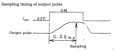

Based on the datasheet information on sampling timing, I made a quick Arduino sketch i order to test the sensor and the circuit.
The resulting sketch is as follows:
int sensorPin = A0;
int sensorValue = 0;
int ledPin = 2;
int delaySampling = 280; // wait 280 us before sampling after turning on LED
int delayLed = 40; // wait 40 us after sampling before turning off LED
int delayCycle = 10000 - delaySampling - delayLed; // 10ms cycle

Measurements
I performed two measurements for initial testing.
The first test, was to use the sensor as is, measuring the dust concentration in the room.
The second, was to trigger an extreme condition using a smoking matchstick.
The change in value is clearly indicating the smoke was detected. Looking further in the datasheet, following graph is provided.
The maximum value in the graph matches the result when using the smoking matchstick, meaning a density larger than 0.6mg/m3.
As for the dust, it would seem there is an approximate concentration of 0.05mg/m3 in the room I was testing.
I'll be testing the sensor further and porting the Arduino code to the Launchpad (which should be straightforward with Energia ?!).
I'm curious to see the results when measuring in different rooms (who has the dirtiest room).
