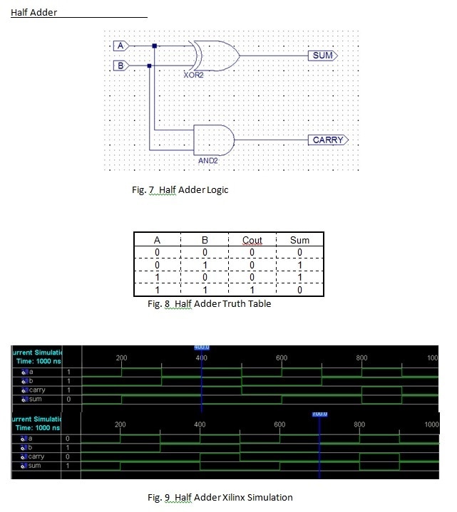

    We did this circuit in one of our digital practicals at Uni a while back (that was converted to VHDL) , build a half adder and full adder (half adder with carry). Our add with carry features two XOR, two…
  • Stuart_S
    Stuart_S over 1 year ago

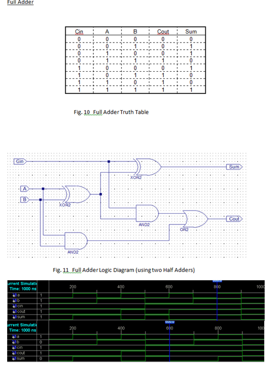

    We did this circuit  in one of our digital practicals at Uni a while back (that was converted to VHDL), build a half adder and full adder (half adder with carry). Our add with carry features two XOR, two ANDs and an OR -which appears as one of your bit adding modules. Maybe there's an exercise here using De-Morgan's theorem to reduce the chip count.  image
                                  Half Adder
                         Full Adder
    I've included the truth tables and simulations for reference and support
