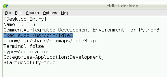

But, unfortunately, the default installation does not allow access to the IO pins, so the first step here is to change things so that we do have access.
Thankfully this can be done very easily by just changing the settings of the "IDLE 3" desktop icon.
To do this, simply right-click on the IDLE 3 icon, then choose "Open With...", toggle to see Accessories, and then select Leafpad and click OK.
This pops up an editor showing several lines of text.
For the line that starts with "Exec", after the = sign add "sudo " (just the part within the quotation marks, including the space)
This will run the Python IDE as "root", giving it full access to the machine.
Now save and exit, and you are ready to blink the LED!

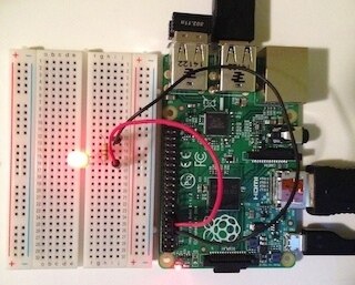

To connect the LED:
- put the LED into the breadboard
- connect one side of the 470Ω resistor to the short lead of the LED
- connect a wire from the long lead of the LED to pin 11 (GPIO17) on the Raspberry Pi
- connect a wire from the other side of the 470Ω resistor to pin 9 (GND) on the Raspberry Pi.

In my example I use a little loop and a timer to turn the LED on and off 10 times.
It's actually quite easy to use once you know the basics image
