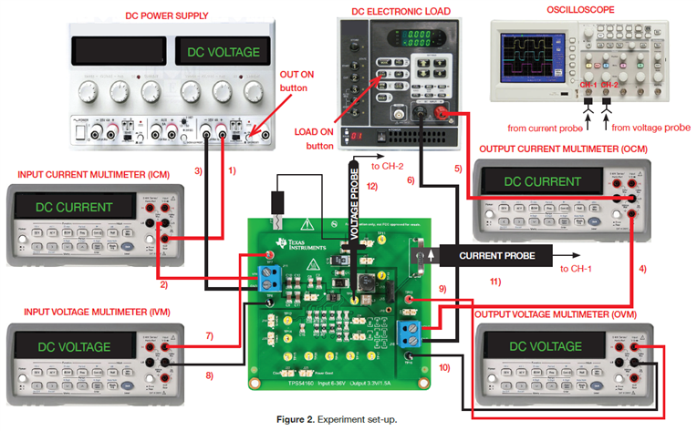

The tutorial advises this Lab setup:
I'm replacing the input current meter with the display of my power supply. The input voltage I've measured with the DMM.

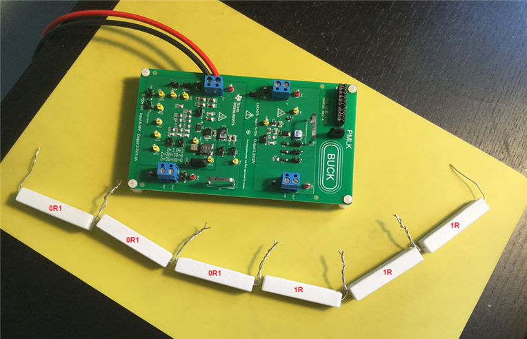

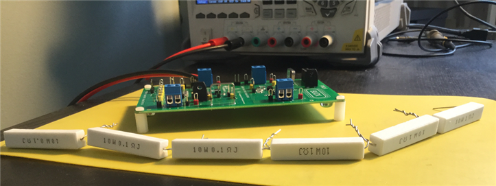

The load is a string of 0R1 and R resistors that form 3R3 in total. That's 1A of output current for this 3V3 circuit.

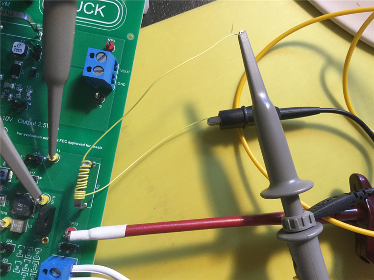

My biggest miss is a current probe. This is used in the circuit to measure the current racing trough the inductor.

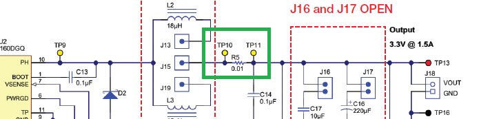

I first tried if I could put two oscilloscope probes on TP10 and TP11 of the circuit.
Then I tried to use the Math function of my scope to show the difference between the two.
It turns out (as expected really) that I don't get enough drop over 0R01 resistor R5 to get a signal that's above the noise floor.
What works better is the second thing I tried: wind a coil of isolated wire around R5 and try to steal the current that way.

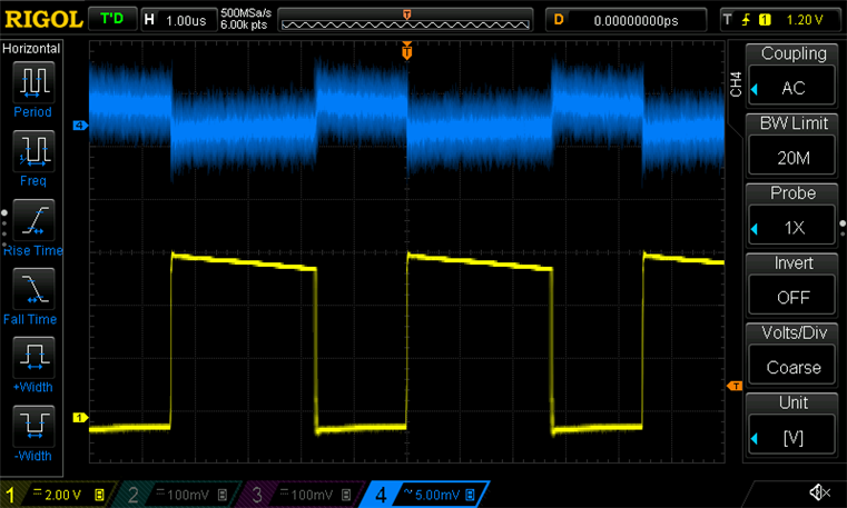

This works way better. I can get a view of the current in the circuit's switching node on my oscilloscope.
Way too course to do a good measurement but it does the job of visualising what happens.
The switch node current is the blue trace on the capture below:

I measure output voltage with the DMM, and output current by putting my DMM over one of the load resistors in the chain + Ohm's Law.

    Hi Jan, my compliments! Very well documented experiment. This is perfect as STEM. I have an ignorant question. In the scheme both two input and output current multimeters have only the current signal connected…
    Jan Cumps over 9 years ago in reply to balearicdynamics +1
    Enrico, Enrico Miglino wrote: ... In the scheme both two input and output current multimeters have only the current signal connected and not the ground (or negative). Can you explain this detail please…

    The 2 current probes required for this board are off-circuit. It's one of those inductive oscilloscope add-ons that you clamp on a wire and that shows the waveform on your oscilloscope.
    With this amplifier:

    Just a note instead. I have used 1 Ohm 150 W resistors to calculate the current. I thought that it was a very crap method instead I see that you too are using something similar. So is it reliable ? It seems I have not adopted a so bad solution...
    Enrico
    In the next blog you can see that I stepped away from this method and used a current meter in series with the output. The drift of my resistors was way too high to get a decent current sample..
    After running warm (not even hot) my 1R power resistor measured up to 2R. So I had to change strategy.
