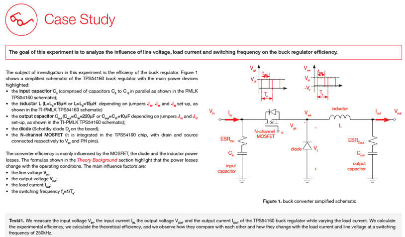

Goal of Experiment 1:
The goal of this experiment is to investigate how the efficiency of a buck regulator depends on the line and load conditions and on the switching frequency.
The document reviews the parameters that play a role in efficiency, shows the components that have a loss independent of load and components that have load dependent losses.

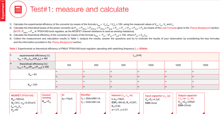

The exercise is to measure input and output power with varying load, for an input voltage of 6 and 24 volt and calculate efficiency.
Then you have to compare that with the efficiency calculation. You get enough help in the doc to get that calculated.

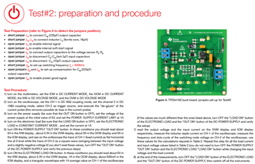

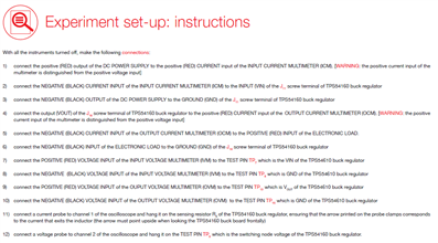

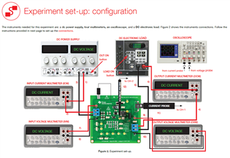

Then follow the steps to set everything up and perform the exercise (click to enlarge).

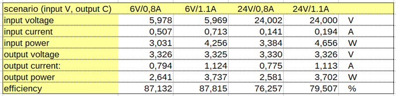

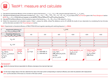

You record both calculated and measured values in a table, for those efficiency and loss tests.

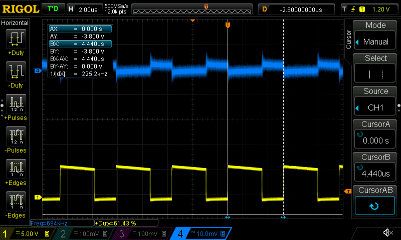

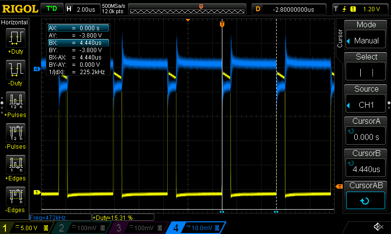

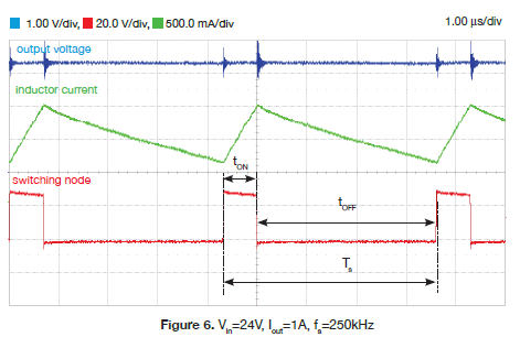

Here's a few of my measurement recordings and some scope captures:
  • Input 6 Output current 0.8 A
  • Input 24V Output current 0.8 A

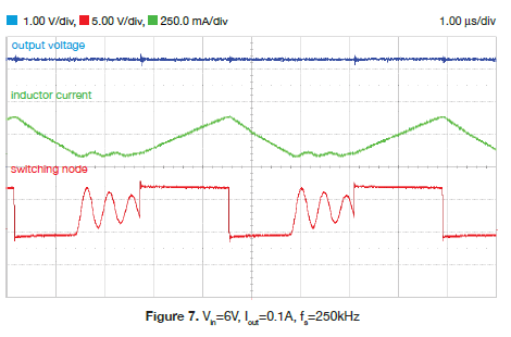

Here's what the manual shows for 24V 1A. It's obvious that my current measurement method (blue in the capure above vs. green in the TI manual) is not up to the game.

    Jan Cumps over 9 years ago in reply to jc2048 +2
    i think not having the DC component is ok in this case, where I'm trying to visualise current (edit: current waveform) and ripple trough the inductor. If I have some time next week-end, I'll try to put…
    This is the best signal I can snoop with my naive air coil tap: The yellow line is the voltage inducted into the coil I wound over the current shunt, amplified by a µCurrent in nA mode. I'm misusing the…
  • jc2048
    jc2048 over 9 years ago +1
    It's obvious that my current measurement method (blue in the capure above vs. green in the TI manual) is not up to the game. I don't know - it's quite good for something that you've improvised. But you…
    I was using the probes in 10X - so 20 pF is close.
  • jc2048
    jc2048 over 9 years ago in reply to Jan Cumps
    I estimated 2.1MHz from the trace, calculated about 320pF using the formula you give for a parallel LC circuit at resonance, and then knocked off 20pF for the scope probe (which wouldn't normally be there). [It's perhaps worth noting that the ringing frequency with the scope probe present is different to what it will be without the probe being there.]
    As well as the diode and the MOSFET, there's also a contribution from the pcb, particularly with a multilayer board with a plane close under the switch-node copper.
    As you now show, the diode capacitance figure varies according to the reverse bias, so you can't do a simple calculation with a single figure (particularly not when the figure you're giving is the worst-case for 40V of reverse bias).
    I doubt you'll find anything on the internal MOSFET.
    Good discussion there that you link to. It's just basic physics, really - once the coil can't keep the diode on, the remaining residual energy sloshes back and forth between the coil and the parasitic capacitance until it has all been dissipated. The extra thing, that isn't necessarily obvious, is that if the supply rails are well decoupled then, to ac, it looks like there is a short between the rails, so the diode capacitance to ground, the MOSFET capacitance to the input voltage rail and the coil connecting to the output rail, all look like they are in parallel.
    Now you're in a position to work out what the total resistance in the LC circuit is. [It won't just be the coil resistance. The diode and MOSFET semiconductor materials will have some resistance too that's effectively in series with their capacitances. There's also the ESRs of the decoupling components, though that won't be much if they're ceramic caps.]
    According to the doc:
    The ringing is determined by the resonant loop formed by the inductor and by the parasitic capacitances of
    the MOSFET and of the diode
    Period of ripple is 500 ns (1 graticule): f = 2 MHz
    The inductor is 18µH.
    The N-channel MOSFET is inside the TPS54160 - couldn't find the parasitic capacitance of that FET  yet
    The diode is a Schottky B260-13-F: 200 pF typ/max according to the specs (according to the TPS54160 datasheet, the typical capacitance of a B220 is 120pF).
    from Bourns B220 - 260 datasheet
    Stole this formula from wikipedia: image
    my calc-fu says approx 350 pF parasitic capacitance.
    discussion about the ringing in discontinu mode: https://groups.google.com/d/msg/sci.electronics.design/uClujub7998/lbTFGZgyzegJ
  • jc2048
    Very nice - they're the kind of pictures that would resonate with any true engineer.
    So, about 300pF, then?
