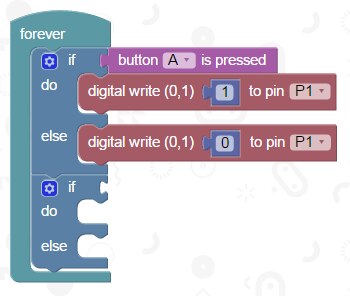

  • Select two 'if/do' tiles from the Logic commands menu, add an 'else' option to both by clicking the blue cog icon, and connect them in a 'forever' loop.
  • The first 'if/do/else' tile will be used to send a message from your BBC micro:bit to the device it's connected to.
  • Drag in a 'button [A] is pressed' tile from the Input commands menu and attach it next to 'if'.
  • For 'do', got to the Pins menu and attach a 'digital write (0,1) [1] to pin [P0]' tile. Set the pin to [P1] in the right dialog box.
  • Add a second 'digital write...' tile next to 'else', also changing the pin to [P1] and setting the value in the left dialog box to [0], like so...
  • When you press button A now, your device will send a current through pin P1. Otherwise, there will be no current through this pin. When your device is connected to your partner's BBC micro:bit via the crocodile clips, this is how they will communicate.

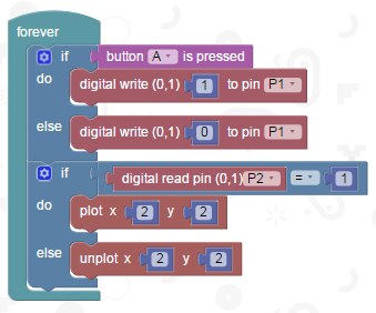

  • Next you need to tell your device what to do when it receives a message from your partner's BBC micro:bit, in the form of the aforementioned current. For the purposes of this project, we're just going to create a simple telegraph - meaning that when your BBC micro:bit receives the message from the connected device, it will flash up a light on the LED.

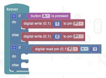

  • In the second 'if/do/else' block, attach a '[0] = [0]' tile from the variables menu.
  • In the left dialog box, attach a 'digital read pin (0,1) [P0]' tile and set the dropdown to P2.
  • Change the value in the right dialog box to 1.
  • Your device now knows that when it receives an active current through pin P2 - via the second BBC micro:bit - it needs to perform an action.
  • From the LED commands menu, attach a tile that reads 'plot x [0] y [0]', attach next to 'do' and change value in both of the dialog boxes to [2].
  • Next to 'else' attach a tile that reads 'unplot x [0] y [0]' and also set the values in both dialog boxes to [2]
  • Now, when your device receives a current through pin P2, it will flash the LED at co-ordinates X2, Y2.

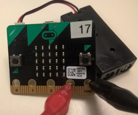

  • To connect the two BBC micro:bits, take your first pair of crocodile clips and attach each end to the GND pin on both devices.
  • Attach your second pair of crocodile clips to the 3V pin on each device.

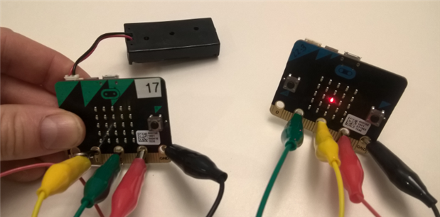

  • Take your third pair of crocodile clips and attach one end to Pin 1 on your first BBC micro:bit. Connect the other end to Pin 2 on the second device.
  • Do the reverse with your fourth and final pair of crocodile clips. attaching one end to Pin 2 on the first device, and the other to Pin 1 on the second.
  • Your devices are now ready to communicate! Make sure your code is downloaded to both devices, and hit button A to start communicating!
