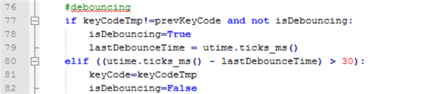

First and foremost, the sound that is played at each switch is a particular frequency hard coded. Feel free to change them to whatever notes you want.
With creating music, speed of the note playing is important. I found that my debounce routine was causing noticeable delays. You could tweak this to adjust the speed.

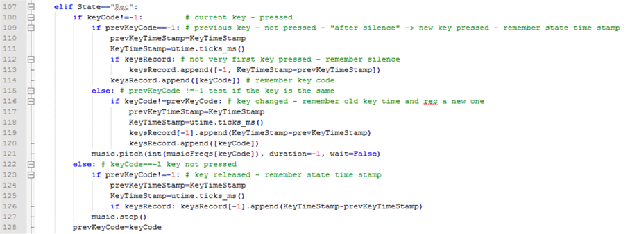

Below is where the recording process takes place.
The rest of the code is commented fairly well if you want to see what is going on in it.

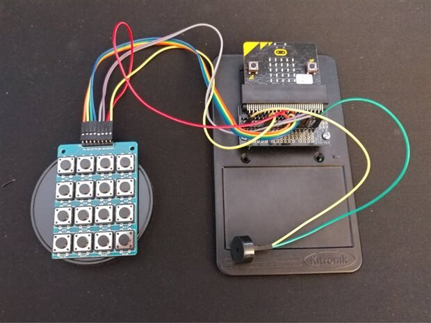

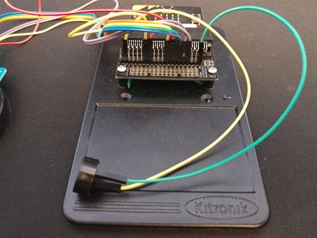

Gather your parts.
I used a 4x4 matrix keypad for this project. You can use any type of matrix keypad as long as it has sixteen buttons.
I then used female-female project wires to connect the pad to the Micro:bit breakout board.

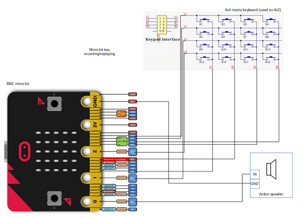

STEP 3
Wire up the schematic to the breakout board.

Simultaneously pressing “A” and “B” keys will switch mode to the “Rec” displaying on the LED indicator as a circle interchanging with its half (to reserve two upper lines for the storage indicator).
As you press keys their keycodes and successive relative time intervals are stored in the memory. “No input” is coded as “-1” and its duration is stored too so any key press uses 2 elements (coding pressed key and released keys relative time intervals).
To replay recorded sequence press button “B.” “Replay” mode is started and keys are replayed sequentially until the last stored key release event, ended by “A” or “B” key press and continues in infinite loop (until “A” or “B” button key press).
