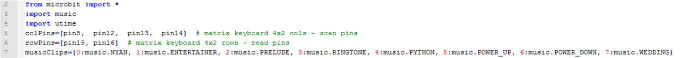

A little bit about the code:
Note the import music definition. It allows access to standard melody sound clips. See the musicClips variable for the name of each sound it plays.
Import utime is used for timing the sequences.
The rest of the code is commented fairly well if you want to see what is going on in it.

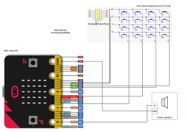

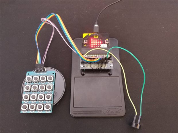

I used a 4x4 matrix keypad for this project. You can use any type of matrix keypad as long as it has eight buttons.
I then used female-female project wires to connect the pad to the Micro:bit breakout board.
STEP 3
Wire up the schematic to the breakout board.

Setup
Plug USB 5V power to the Micro:bit.
It will be in the button play mode. You should see a play symbol triangle alternate with a hyphen.
In this mode, buttons K1 to K8 play eight different melodies numbered 0-7. Press the different buttons to hear the melodies. As soon as you press a new button, the old melody will stop playing.
Simultaneously pressing “A” and “B” keys will switch mode to the “Rec” displaying on the LED indicator as a circle interchanging with its half (to reserve two upper lines for the storage indicator).
As you press keys their keycodes and successive relative time intervals are stored in the memory. “No input” is coded as “-1” and its duration is stored too so any key press uses 2 elements (coding pressed key and released keys relative time intervals).
To replay recorded sequence press button “B.” “Replay” mode is started and keys are replayed sequentially until the last stored key release event, ended by “A” or “B” key press and continues in infinite loop (until “A” or “B” button key press).
