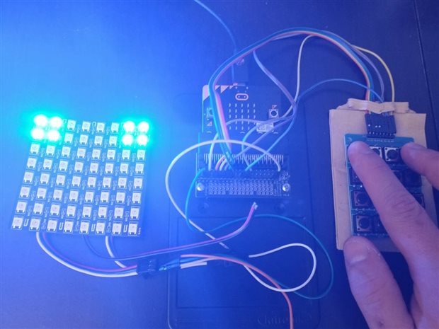

Lighting up two groups of LEDs with two buttons. They are bright! (Images & video: Me)

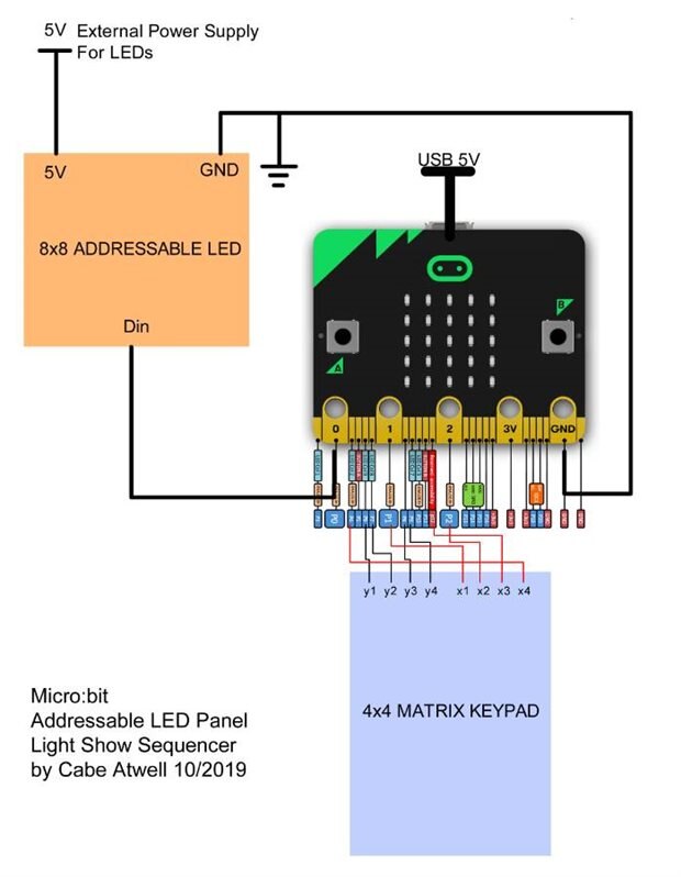

The schematic is fairly straight forward. Wire it up like the drawing.

Setup
The software works as follows:
- Power it up.
- Immediately press buttons to light up any LED according to buttons pressed.
- Press the “A” button and start a recording sequence.
- Press your combination.
- Press “A” again to end the sequence.
- Press “B” to play back your light show.
