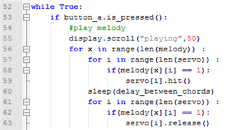

A little bit about the code:

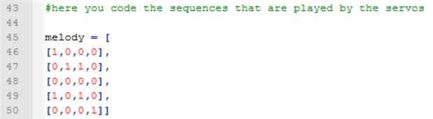

● The main part of the code to pay attention to is how you set the tap sequence.
There is an array variable called “melody” that sets the melody, so to speak, of the tap sequence. You can change it here or even add extra lines.
● You might want to change what scrolls on the display before the tapping starts. It does take some time to scroll.
In this code section you can change the work "playing" to something else, like  "GO" or "X." It'll get to the taps faster.

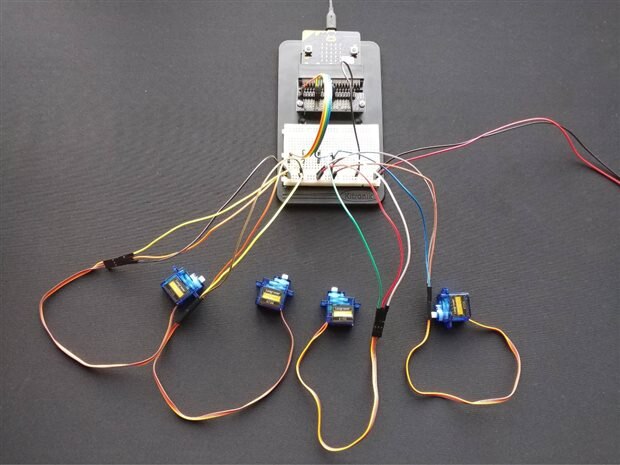

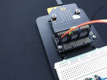

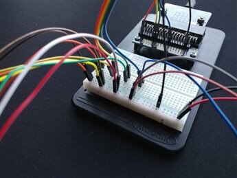

I used the breakout board for this project. It’s great for testing and setting up where space and reliability isn’t an issue.
But for an initial build of the project, let’s use a breadboard.
Lay the Micro:bit and Kitronik Inventor’s Kit on a table. Insert the edge-card end of the Micro:bit into the Inventor’s Kit socket and stick a breadboard to the bottom part of the Inventor’s Kit.
STEP 3

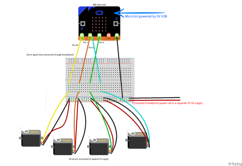

Wire up the schematic to the breakout board. Below is how I assembled the system.

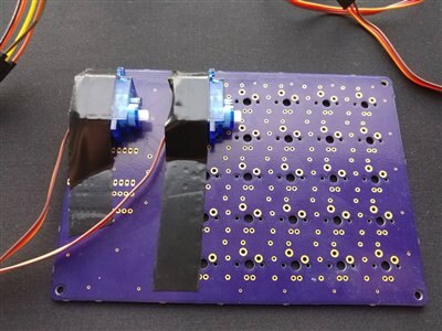

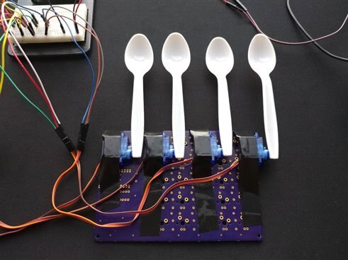

I attached the servos to a spare PCB I had laying around using good old electrical tape. I wanted the surface they were on to be flat and ridged. It worked out ok. But, I would have preferred a 3D printed mount of some sort.

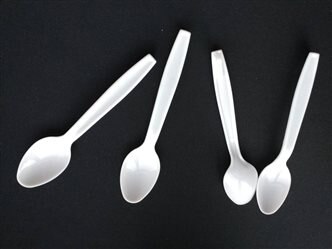

For a tapping sound that was a bit louder, I glued the servo arms to the bottom of a spoon. I found this was a bit louder than just using the plastic arms that came with the servos alone.
Attach the spoons to the servo actuator shaft. I found that I had to make different height surfaces for the spoons to tap on. I used stacks of dominos under each spoon, adjusted the number of for each. It’s a bit brute force, but it works.
Crude, but does the job.

Plug USB 5V power to the Micro:bit.
Also, power the additional 5V supply that is attached to the breadboard.
At this point, you’ll hear the servos power up.
STEP 6
Press the “A” button, and the screen will scroll “starting,” then the servos will move.
The spoons will play the sequence defined in the code and end.
It waits for the next press.
