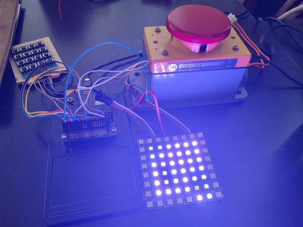

My last countdown timer did the job, but it was a very small effect. So, I brought back out my 8x8 LED Matrix to give it a bright update. It’s very bright! Super-bright!
Instead of images to wipe away, I made the setup change color as the time counted down, and the LEDs were eaten up in a spiral just like the last version.
How the system works:
Once again, when powered, the Micro:bit waits for the user input.
When pressed, the LED matrix panel will light up, and an animation effect will begive to erase the LEDs in a spiral pattern, while it also changed color. Then the system will be ready for another input.
Again, I don’t have a very sensitive button for this project. In my project, I ended up using a button I salvaged from a demolished factory. In my original plans would have been a contact switch with a travel almost nonexistent. However, my salvaged button travels about 2.54 cm (an inch). I give it a gusto press, and the sequence starts.
I added another function, a cancel button. Pressing “B” on the Micro:bit itself will cancel the sequence. Also, pressing “A” will also trigger the sequence, in case you want to do that.

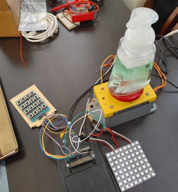

I am thinking a foot pedal push button might be a good option for simplifying this project. You can then put any soap bottle on the button and use it. The one I selected here is watertight. Might work out.

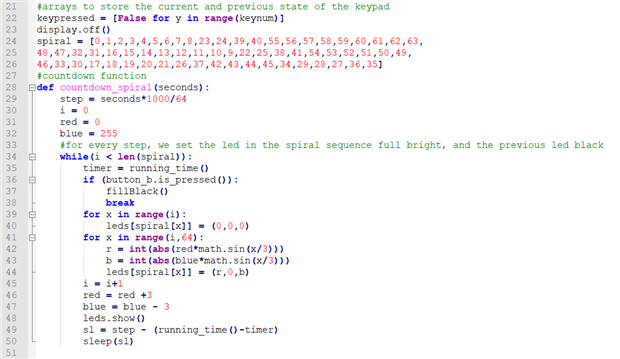

A little bit about the code:
Ok, so this was a little bit inelegant. Brute force, mapping out the LEDs for the animation sequence, but it works. image

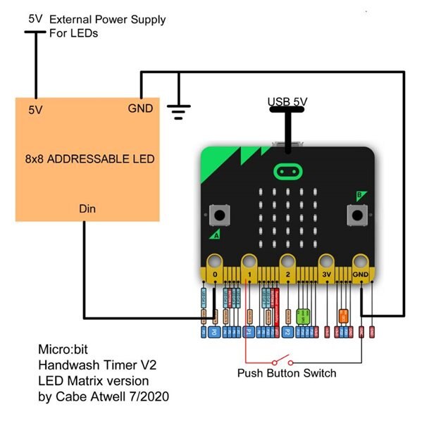

The schematic is the simplest I could make for a first version. Wire it up like the drawing.

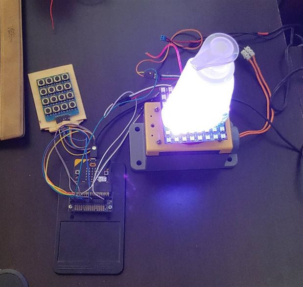

    Catwell over 6 years ago in reply to genebren +1
    Thanks! I am thinking the next version should focus on lighting up the soap container instead. Not sure what to do with that yet. More color changing, flashing, "breathing." I suppose I wouldn't need as…
    genebren over 6 years ago in reply to Catwell
    I like the idea of lighting up the container.  And yes, I think that you could get away with few LEDs in the that approach.  Flashing or 'breathing' is a good effect, especially if the flash rate is used to indicate time, or time remaining.
  • Catwell
    Thanks!
    I suppose I wouldn't need as many LEDs to get the same effect...
