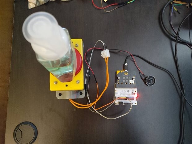

Again, I don’t have a very sensitive button for this project. In my project, I ended up using a button I salvaged from a demolished factory. In my original plans would have been a contact switch with a travel almost nonexistent. However, my salvaged button travels about 2.54 cm (an inch). I give it a gusto press, and the sequence starts.
I added another function, a cancel button. Pressing “B” on the Micro:bit itself will cancel the sequence. Stops the countdown, in other words.
Only issue I had was the sound level from direct connection to the speaker. I know this could be remedied with using a powered speaker or amplifier. But, that’s an issue for a future version, I’m sure.

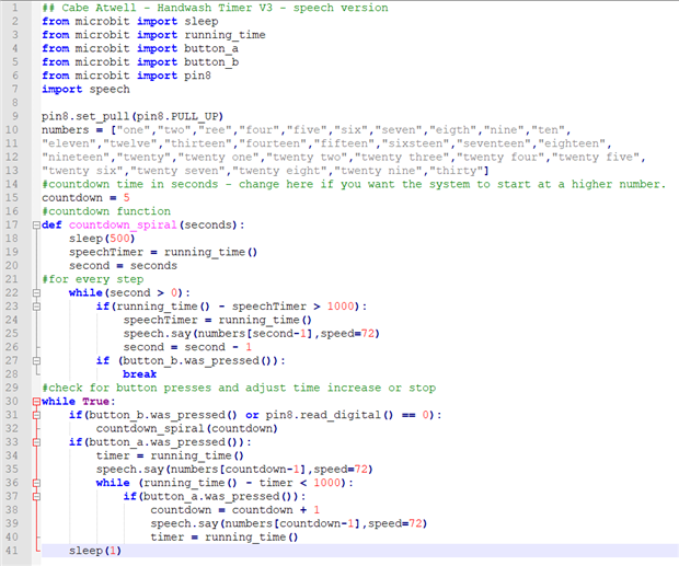

Load the code onto the Micro:bit.
I am providing the hex file you need to drag and drop onto the Micro:bit, and the python code as two separate files. For the below process, just use the hex file.
Plug the MicroUSB cable into the Micro:bit, and plug the other end of the cable to a PC or MAC.
At this point, you are going to copy over the code to the Micro:bit. I am providing the program (code) in this post that needs to be copied over. When the Micro:bit plugs into a computer, it shows up as a USB flash drive. All you have to do is copy the file over to the Micro:bit, like it’s a USB Flash Drive, and the Micro:bit will reset, and the program is active.
You can remove the Micro:bit from the computer at this point. The program will start running, and without the rest of the circuit, it will not function.
A little bit about the code:
Yes, the countdown time only goes up to 30. However, do we need to wash hands for longer than that? image

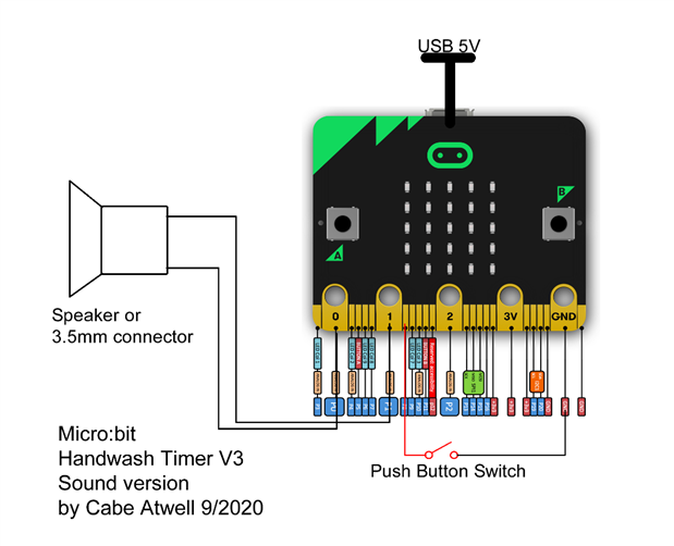

The schematic is the simplest I could make for a first version. Wire it up like the drawing.

Place the soap on the button!
STEP 4
When you turn the system on, it’ll start up immediately.
Press “A” to increase the time to whatever you want. I set it for 5 seconds to start.
Dispense soap, and the sequence will start.
Step 5 optional
Press “B” to stop the sequence at any time.
