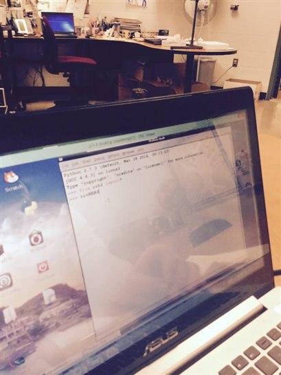

After reviewing the basic Python library turtle commands with t = turtle.Pen() such as t.forward, t.left, t.right in the shell I let William attempt to write a script for drawing a square. But I did not show him the script that I had wrote earlier as I wanted him to come up with a script on his own and also, he is not familiar enough with the Python syntax to declare a "range" yet. My objective during all of this was to talk about creating a function; in our case square(). This was necessary because when using the Raspberry Pi robot I built it relies on functions from the RRB2 Motor Shield library such as forward(), backward(), left() and right(). To put these types of commands in context and to better explain them I felt it was thus necessary to relate the creation of a functions to drawing a square in Python.
This is what we ended up with without much guidance:
This code produced a square according to the function: square(). Just as planned! Oh, and of note, all this experimentation was being done on the Raspberry Pi since it has Python pre-installed on it; and just as I planned, it was being mirrored to my laptop desktop using VNC viewer:
The photo above shows William putting in dat work on the Python shell!

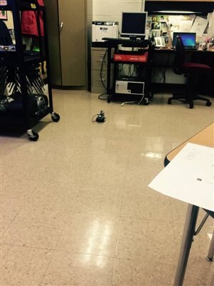

It was fun driving the robot around in the shell, and also realizing that we were working with seconds whenever we plugged a command into a RRB2 function. For example: rr.forward(5) would cause the robot to drive forward for 5 seconds. Here is a photo of the robot in action:
Yes, that's the mighty turtle bot driving off into the distance! Into that mess of wires next to a desk.
