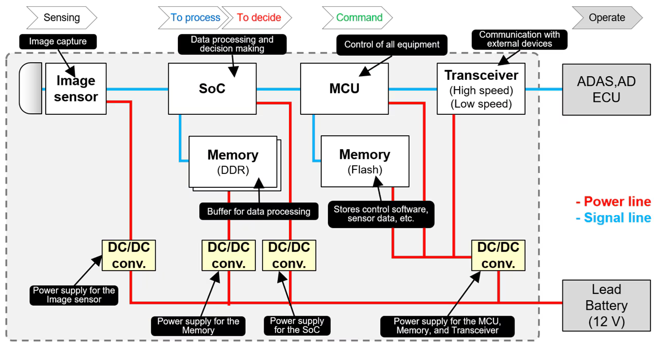

Internal architecture of automotive camera modules
Sensing camera and driver monitoring camera: These modules capture, process, and transmit visual data reliably under automotive operating conditions using an image sensor, a lens assembly, a processing SoC, supporting MCU, memory, a serializer/transceiver, and regulated power stages. Signals are processed by a SoC that performs real-time computations required for ADAS and autonomous driving functions. Supporting SoC is a microcomputer that issues control instructions, such as braking or steering commands, to external ECUs when system logic requires intervention. Communication with the rest of the vehicle network is handled by a transceiver, while DDR memory serves as a buffer for image data during processing, and flash memory stores firmware and sensor related data. Power to each component is supplied by a DC/DC converter that regulates the voltage from the vehicle’s primary supply to the precise levels required by sensitive imaging electronics. This architecture ensures stable performance even under fluctuating electrical and environmental conditions.
Figure 1 Internal architecture of a sensing camera and a driver monitoring camera (Source: Panasonic)

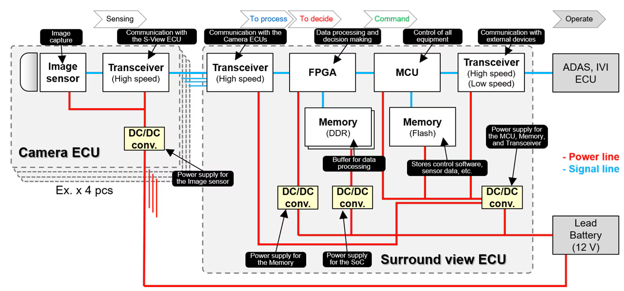

Surround view camera: The circuit configuration of surround view cameras differs in complexity because these systems rely on multiple camera units installed around the vehicle to generate a unified panoramic image. Each camera contains its own image sensor, but the combined image data must be communicated to a dedicated surround view of ECU, requiring high-capacity transceiver circuits to manage the larger data throughput. Within this ECU, an FPGA performs high speed image integration, synthesizing inputs from all sensors into a single omnidirectional representation. Despite their distributed structure, surround view cameras still share the core elements found in sensing and driver monitoring cameras, such as image sensors, SoCs, MCUs, memory subsystems, and regulated power stages, but their synchronization, bandwidth, and processing demands are significantly higher to ensure seamless real-time stitching and display.
Figure 2 Internal architecture of an automotive surround view camera (Source: Panasonic)

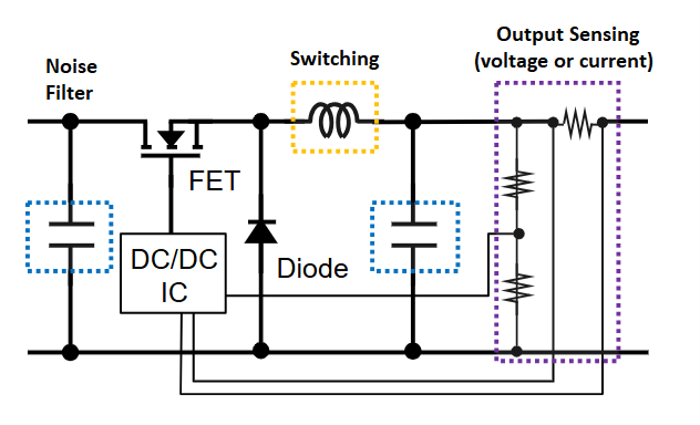

The Ripple and Noise Challenge: Camera modules integrate high speed CMOS sensors, SoCs, transceivers, memory, and DCDC converters. These components switch at high frequencies to support HDR imaging, real-time object detection, and multicamera fusion. Highspeed switching inherently generates ripple current and high frequency noise on the supply rails, which can distort image signals, cause timing jitter, or corrupt data being transferred to ADAS ECUs. Low-ESR capacitors are essential at the power input stage because their low impedance at high frequencies allows them to absorb ripple currents and deliver fast transient response, preventing noise from propagating into sensitive imaging circuits.
Filter Vulnerability and High Frequency Behavior: Camera modules often include LC lowpass filters to protect SoCs, sensors, and microcontrollers from supply noise. Ideally, at higher frequencies, the capacitor side of this filter should present near zero impedance to shunt switching noise to ground. However, if ESR is too high, the capacitor’s impedance stops decreasing with frequency, allowing high frequency interference to leak into image processing and communication paths. Low-ESR capacitors overcome this vulnerability by maintaining low impedance across the higher frequency spectrum used in modern camera power stages, ensuring that noise is effectively grounded and that imaging performance remains stable even during rapid load changes.
Figure 3: Application of Low-ESR capacitors in DC/DC converter of an automotive camera system (Source: Panasonic)
Solving low-pass filter challenges in automotive camera systems using Panasonic Low-ESR capacitors
A capacitor’s ESR determines two key performance parameters: ripple current handling and filtering effectiveness.
Ripple Current Handling: When a high ripple current (Iripple) flows through the smoothing capacitor with high ESR, it will cause higher capacitor heating (Pdissipation = I2ripple × ESR) and increased radiated noise. Consequently, the image processing logic works harder; CMOS sensors experience higher supply perturbations, and the video signal appears less stable. Placing a Low-ESR capacitor at the DC/DC output keeps ripple low during high-speed processing steps, improving pixel-data integrity and minimizing localized heat generation. This cooler capacitor operation enables it to survive longer, especially at the high ambient temperatures demanded by AEC-Q200 specifications.
Filtering Effectiveness: The automotive camera’s circuit uses a Low-Pass Filter suppresses internal noise and noise from external equipment. In an LC or RC filter, the output voltage is determined by the voltage divider relationship between the resistor or inductor and the capacitor's impedance. Ideally, at high frequencies, the capacitor's impedance should be near zero, effectively grounding the noise. Placing Low-ESR electrolytic capacitors at the input LC or RC filter lowers the total impedance, maintains the filter’s ideal attenuation slope over a wider frequency band, and reduces high-frequency bus noise coupling into the sensitive image-capture and voltage conversion circuitry.
