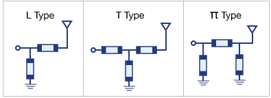

For maximum power transfer and optimal performance of a chip antenna, the impedance of the antenna and transmission line must be matched. A typical matching circuit consists of a network of capacitors and inductors near the antenna. A few options are shown in Figure 4. Placement and orientation of the matching components are very important as they affect the magnetic field, which can couple with other components and can generate RF noise.
Figure 4: Matching Circuit Options

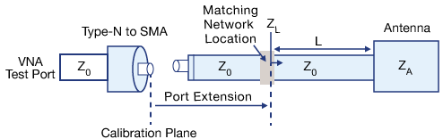

A measurement set up using a Vector Network Analyzer, as shown in Figure 5, is used to measure the performance of a chip antenna along with the matching circuit.  We measure antenna parameters such as return loss, peak gain, efficiency, input impedance, and polarization at various feasible mounting locations.
Figure 5: Antenna Matching Setup
The following are steps are taken into consideration when matching antenna impedance with a transceiver:
  • Calibrate the vector network analyzer (VNA) as close to the matching network as possible
  • Align the measurement plane with the calibration plane by using a port extension, if necessary
  • Measure the unmatched impedance at the frequency used
  • Decide the values of matching network components and incorporate the components
  • Verify the matched impedance, and adjust, if needed
