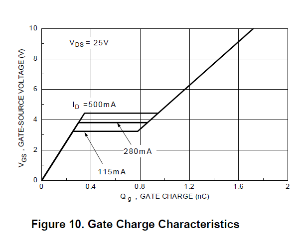

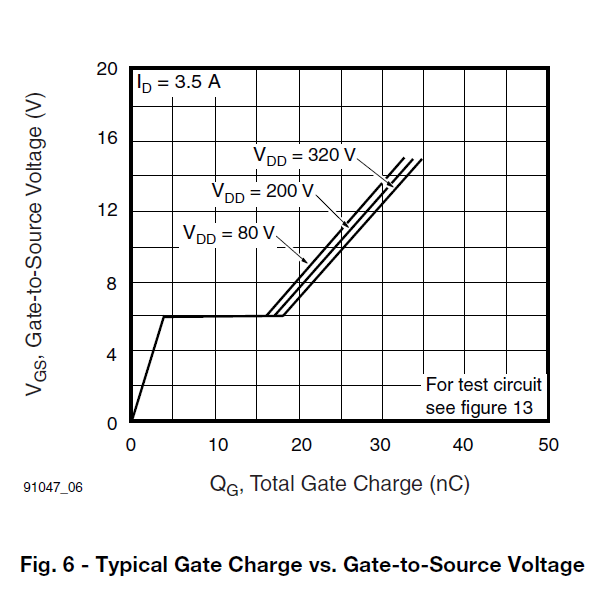

If you've ever designed with a MOSFET, I'm sure you've seen the kind of curves that are usually present in the datasheet showing the relationship between the total gate charge and the gate voltage. Here's one such graph from a datasheet for a Vishay IRF730 device:
They always have the same sort of shape to the curve, though the position of the plateau, halfway up, varies in both voltage and the amount of charge to get there, and then past it, for a particular type of part.
The IRF730 is a power MOSFET. As a comparison, here's the curve for a small-signal 2N7000 part (from a Fairchild datasheet)
For this part, the charge values are much lower.

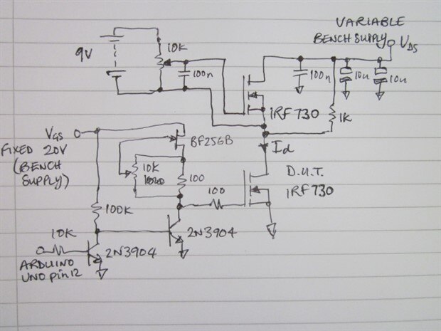

The Circuit
The circuit I've ended up with is based on the ones shown on datasheets. They vary somewhat, but the essentials seem to remain the same between the different manufacturers. The drain current is normally supplied by a similar part to the one on test, configured to deliver a constant current. The gate drive for that part has to be relative to its source which sits on the drain of the device under test and will move up and down. To deal with that, I decided to simply use a 9V battery to generate the gate voltage. I imagine the reason for using a similar part to the one on test is so that the timing matches and they start as quickly as each other. Also, their capabilities will match in terms of current and breakdown voltage, etc.

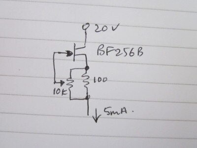

The gate drive for the device under test necessitated a little bit of simple design. Datasheet circuits usually just show a current generator, which is fine if you are a semiconductor manufacturer with cabinets full of test equipment but I don't have that so I'm going to have to make one. It needs to respond reasonably fast, so rather than use an op-amp I decided to try a JFET. I had some BF256BBF256B n-channel parts, so used one of those - here's how it's configured.
The potentiometer allows the gate to be set to a negative voltage relative to the source. The zero-volts current was just over 8.6mA, but I adjusted the pot down from there to give a fairly precise 'round figure' of 5mA in order to make the time display on the oscilloscope relate nicely to the charge value. In terms of charge delivery, that will be 5nC per microsecond.
Here's the full circuit

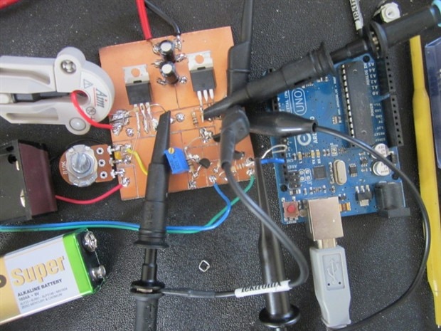

For controlling the timing of the test, I used an Arduino Uno. The program sets pin 12 high for 10us and then low for 500us, a 2% duty cycle. I turned off interrupts whilst it was high so that the timing interval would be consistent. The long off period means the test can be done with reasonably high drain currents and drain voltages, up to 3A and 30V (giving a maximum instantaneous power of 90W), without heat dissipation in the MOSFETs being too much of an issue.
When pin 12 is low (or if the Arduino is either powered off or not connected), the first transistor is off, the second transistor is on and the gate current is directed to ground leaving the Vgs of the test part close to zero and the DUT off, with more or less zero gate charge. When pin 12 goes high, the constant current is then redirected to the gate. The oscilloscope triggers at the same point. From that point on, the display is then equivalent to 5nC per microsecond and if I apply a probe to measure the gate voltage we should see the same curve plotted as on the datasheet.
Here's the test circuit built on a scrap of pcb material.

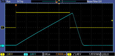

Before I start experimenting with the MOSFET, I'm going to try running the constant current into a 4.7nF capacitor [measured 4.77uF] in place of the MOSFET gate. If it works, I should see a linear ramp as it charges up to about 10.5V at the end of the 10uS. Here's the trace I got - the yellow trace is the signal from the Uno controlling the test.
That looks quite reasonable. Not quite straight, but good enough for what I'm doing for this blog.

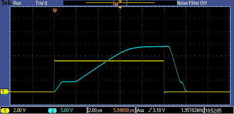

This next trace is with the current applied to the gate of the test part. The drain current is set to 1A and the drain voltage to 10V. The yellow trace is the 10uS pulse from the Arduino, the blue trace is Vgs.
That nicely shows the shape of the Vgs voltage versus the total gate charge curve. Ignore the top end when the Vgs gets above 15V - that's the FET constant-current generator starting to fail as it runs out of voltage.

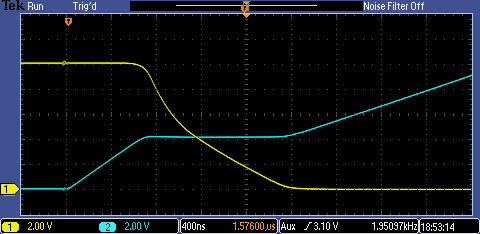

This next one shows the Vgs again, and this time the yellow trace shows the drain voltage and how it falls as the transistor turns on.
Each division across is 2nC, so the plateau starts just under 3.5nC, which ties up with the datasheet. The Vgs is much lower though - theirs is around 6V, whereas mine is just over 4V. A little of the difference is down to the drain current - this curve is for 1A, whereas theirs is for 3.5A - but mostly it's just a reflection of the wide variation in threshold voltage.
The end of the plateau is quite different in my case - mine stops at around 10nC - but that's for a Vds of only 10V. Their curves are for much higher drain voltages.

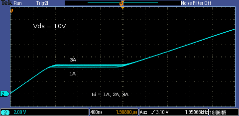

Next experiment was to vary the drain current and see what effect it has on the charge curve
The effect is quite subtle, but It lifts the plateau a small amount as the current increases.

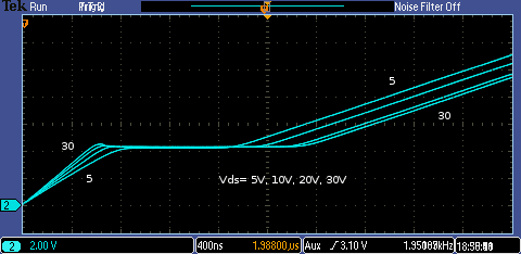

Now, here's what happens if I keep the current at 1A and change Vds.
I was pleased with all those. Sometimes experimenting doesn't go very well, but this time it worked quite nicely.
Although I'm mostly just replicating what's on the datasheet, it has given me a better appreciation of how the Vgs versus total gate charge curve changes with drain voltage and drain current. Sometimes datasheets just show a curve taken with a single value for each which hides from you the effect of changing either if you're not too familiar with how the devices work.

    The idea for this blog originally came from the datasheet itself, where they show this test circuit. I simply took that and fleshed it out. The top transistor is acting as a floating current source…
  • jc2048
    jc2048 over 2 years ago in reply to maxjack123
    The top transistor is acting as a floating current source. I presume the warning about using the same type part is so that the characteristics are broadly matched - it'll react at the same sort of rate and be able to handle the same kind of power as the DUT. I can't advise you at all as to the pros and cons of moving away from that. I was just curious about what was going on with the gate charge thing and thought it would be interesting to try it myself.
    I deliberately chose a power MOSFET that had a low max Id (by virtue of being a high voltage part) so that I could safely do the experiment with a well-protected bench PSU, yet get results that would be (approximately) comparable with the datasheet.
    I'm not an expert in all this semiconductor stuff, but I think characteristics like this are very dependent on the test, so a tradition would have grown up of people doing it the same way to get comparable figures [along with the datasheet showing how the test was done, or specifying the voltages and currents used for the test].
    Presumably the method would work for a SiC part. As long as the gate is isolated from the channel, then you'd be measuring in a similar way: the test is essentially looking at the capacitance between the gate and the channel, but it's a capacitance that starts to change as charge flows into the channel and spreads, which is why the plateau on the voltage exists. But, as I said, I'm hardly an expert (more of a glorified hobbyist).
