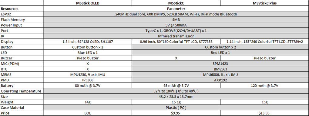

I made a spreadsheet of the differences in the models.
The newer models use smaller higher resolution TFT displays rather than the OLED on the original version.  They also offer somewhat larger batteries and different sensors - like a PDM microphone and RTC.

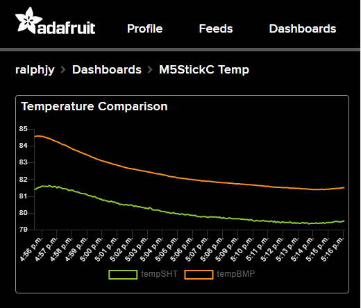

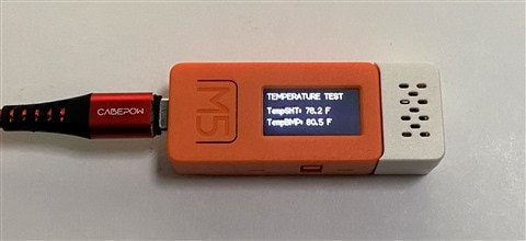

I next set up to run with the ENV II Hat as it would in my application.  There are actually 2 temperature sensors in the hat, so I decide to log them both (the SHT30 is supposedly more accurate than the BMP280).  I am publishing MQTT data to Adafruit IO.

I was surprised by the temperature data because both sensors were reading about 10 degrees F too high.
I was also somewhat surprised by the long settle time (~20 minutes) and the difference between the 2 sensors (>2 degrees F).

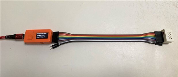

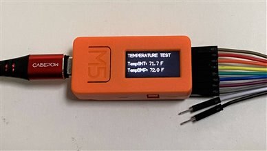

I somewhat suspected that PCB in the hat was getting heat from the M5StickC module, so I tried adding 8 inches of wire between the module and the hat.
And here are the measurements:
So, around an 8 degree F delta between the two cases and the difference between sensors is <0.5 degrees F in the extended case.   The extended data is much closer to what I would have expected.
Apparently, I won't be able to run with the hat directly attached.  Quite disappointing.
Otherwise, I'm happy with the convenience of the M5StickC.  I know that the battery is too small to run for an extended period, but it should be sufficient for my application - if not I'll add an external power pack.
I'll probably use M5StickC Plus modules and individual SHT30 sensors.  I'll need to experiment with how much distance I need between the module and the sensor.
