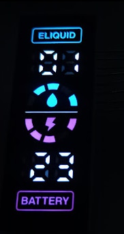

  • scottiebabe
    scottiebabe over 1 year ago
    Does it have a fancy display?
  • beacon_dave
    beacon_dave over 1 year ago in reply to scottiebabe
    I think you may be getting addicted to these eVapes... Smoking
  • scottiebabe
    scottiebabe over 1 year ago in reply to beacon_dave
    Had to see what it looks like. No idea what to use it for though.
    dougw over 1 year ago in reply to scottiebabe
    Pretty cool. What is the arrangement? Two 2 digit displays plus two 5 position indicators?
  • scottiebabe
    scottiebabe over 1 year ago in reply to dougw
    It is wired like this, plus more
    Nice way to make efficient use of the signals....
