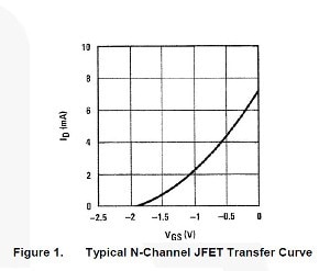

This is what a typical curve might look like. I've taken this from an old app note [1] because the JFET I'm going to be measuring doesn't have any curves at all on the datasheet.
There are several parameters we might be interested in that we could take from the curve. One of those is the zero-voltage current (the drain current when the gate-source voltage is zero), though that could be easily measured in other ways. Another parameter of interest is the negative voltage where the current falls to zero. A little less obviously, we could get the incremental transconductance from the slope of the curve at a particular gate voltage.

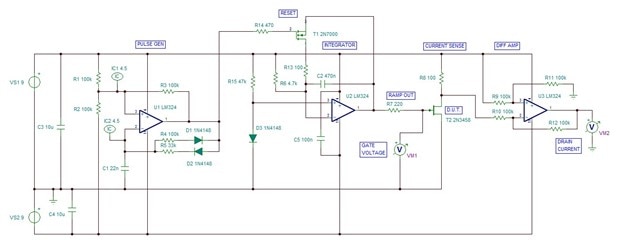

Here's the circuit I came up with. The JFET I've got as the 'device under test' [DUT] was just an arbitrary choice from the ones in the simulation library. The BF256BBF256B part I'm testing doesn't seem to have a spice model.
The heart of it is an op-amp integrator that generates the ramping voltage that's applied to the gate. That voltage is a downwards ramp, from zero to about -6V. To reset it, I have a simple pulse generator that turns on a MOSFET across the integration capacitor. That periodically discharges the capacitor. It's not all that elegant, but I'm only throwing it together for an experiment.
On the output side, the drain of the JFET has a resistor to convert the output current to a voltage and then there's a differential amplifier to shift it down so that it's ground-referenced for the 'scope probe to measure.

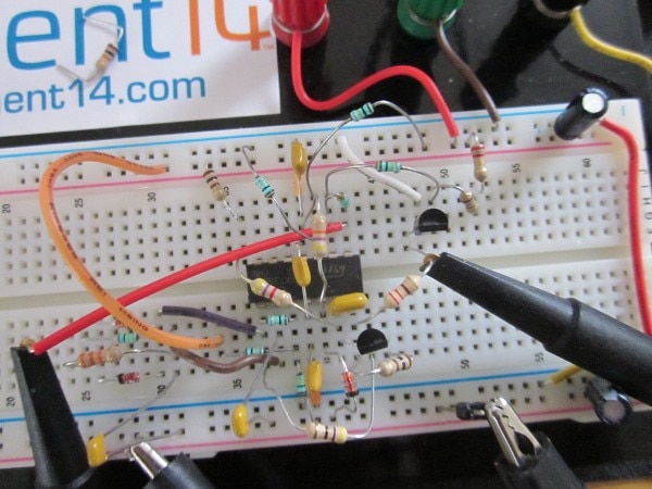

Here it is built on a breadboard:
I had a couple of problems with it. One simple one was that the reset didn't take the ramp back to zero voltage, but left an offset of about -100mV at the gate. That was a shame as it stops us looking at the zero-volt current so, instead of taking the non-inverting input to ground, I lifted it with a diode drop.
The other problem was that the integrator 'sang' a bit. There was a low level of 1MHz oscillation on the ramp. I dealt with that by increasing the size of the integrator capacitor by a factor of ten (and dropping the charging resistor by the same factor) [originally I had 47nF and 47k for the two]. That has the effect of rolling-off the gain faster, which I suppose is why it cut out most of it, but you can still see the effect slightly along the top of the ramp waveform. That might well be down to using the breadboard [capacitance between the strips of contacts], but I can live with it for the purposes of this blog.

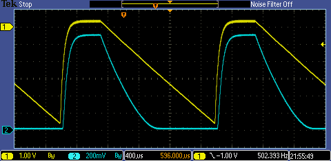

This shows the gate ramp voltage [yellow] and the drain current [blue]. You can see where the pulse generator does the reset back up to just above zero. The drain current is 100mV = 1mA, so on the following trace we have 2mA per division.

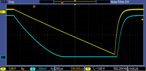

Here it is in more detail.

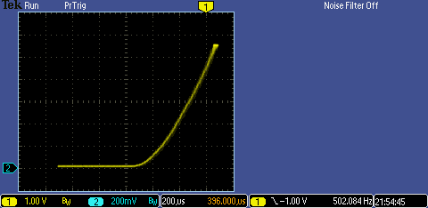

Finally, this is what it looks like if I get the 'scope to plot it XY, where we see it in the more traditional form. The spread at the top is due to the slight oscillation I just mentioned.
The scale up is 2mA per division, so the zero-volt current is about 9mA. That's in the middle of the range given by the datasheet [6mA to 13mA]. The cut-off is harder to measure because my circuit isn't very good (there's a small offset on the current measurement) and it's difficult to see where it gets to zero. It looks like it may be around -2.7V.
The one feature that's slightly surprising is the transconductance. By eye, the transconductance at zero looks to be roughly about 4.5mS (9mA/2V), but that's the minimum value given on the datasheet. Perhaps it's down to the drain voltage (the datasheet uses 15V, but I've only got the 9V of the supply, less a volt for the current sense).

    Apart from the whole exercise, I find that each of the separate blocks in the test gig are little gems. The way to create that reset, lifting the level in the integrator, re-referencing the output to ground…
