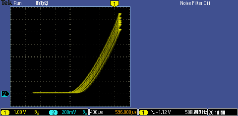

    I have a bag with nine BF256B JFETs left in it, so I tested them all to get an idea of the spread of values we might see. Here are all nine curves composited together with Gimp (there really are nine traces…
    there, some of them have identical curves).
    The zero-volt currents range from just over 8mA to about 11mA and the cut-off voltage from somewhere
    around -2.5V to just over -3V. Something I hadn't appreciated was that the two relate in the way that
    they do.
