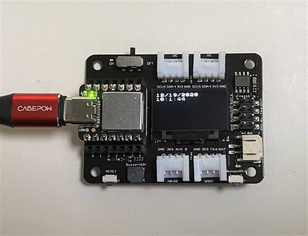

I posted earlier about a couple of SAMD21 mini modules that I'm using SAMD21 Mini Modules .

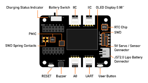

Last month Seeed Studio released an Expansion board for their XIAO module  https://www.seeedstudio.com/Seeeduino-XIAO-Expansion-board-p-4746.html  .
I've been using their Grove shield for the XIAO and it's handy for prototyping sensor programs and it also has battery management for portability https://www.seeedstudio.com/Grove-Shield-for-Seeeduino-XIAO-p-4621.html  .

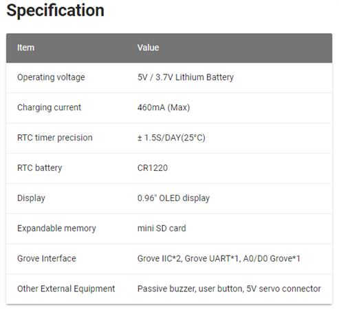

I was able to get a couple of the Expansion boards at the special introductory price of $9.90.  The Expansion boards offer quite a bit of functionality as shown in the spec:

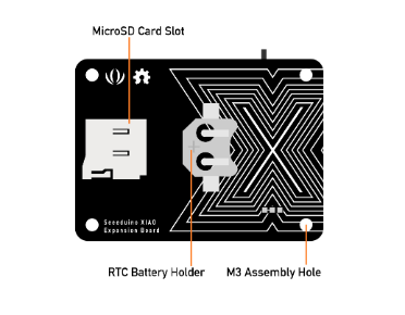

The RTC and microSD card will make it useful for prototype datalogging and it also includes a LiPo battery interface.

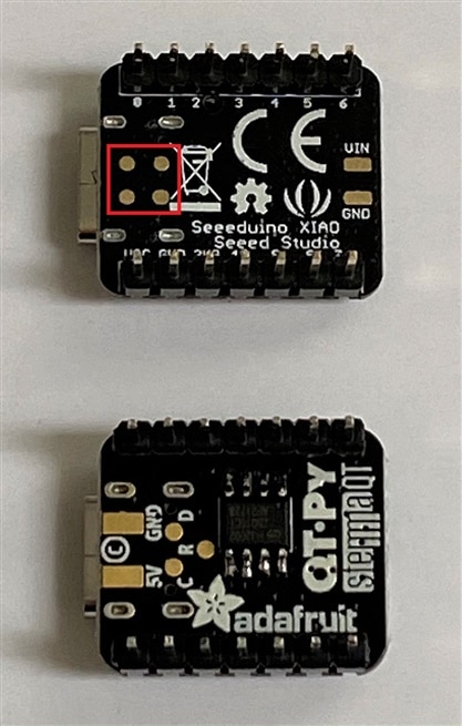

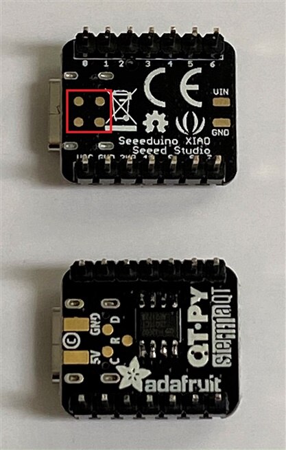

One feature that they added are pogo (spring) pins to bring the SWD (software debugger) signals from pads on the bottom of the Xiao board to a header on the Expansion board.
It's a nice feature that I might use but I realized that I won't be able to use this board with the Adafruit QT Py unless I remove those pins because the QT Py has 5V and GND pads there - see below.  Since I have two boards I'll probably modify one to use with the QT Py.
The first thing I decided to try was the RTC.
Here is the code:  (After setting the time I commented out that part of the code)

After trying the code out, I powered down the board and to my dismay I discovered that the RTC did not retain the time information.  A bit of quick probing with a DMM and I found that the GND pad under the battery holder that is the negative terminal contact was covered with flux.  I guess it's hard to clean because I had to use tweezers and tissue soaked with alcohol to get it clean (a Q-Tip or brush won't fit).  Now it all works but I had to reprogram the time.

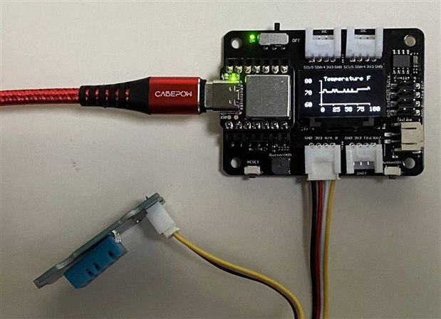

Next I decided to try out plotting a sensor on the OLED.  I had used the U8x8 library for the RTC display but need to switch to the AdaFruit SSD1306 and GFX libraries for graphics.  I've been using a Grove DHT11 Temperature and Humidity sensor for some other experiments so I decided to try that out.
I found some charting code by Kris Kasprzak - FREE Functions to draw graphs on OLED displays https://www.youtube.com/watch?v=13PFOwcK3-I , so I appropriated the line chart from that.  The code does not do continuous plotting, so I'll need to modify that later.
Xiao_Temp_Plot.ino
  This program plots DHT11 Temperature Data

    Hi, Thanks for the info and code! Have you figured out a way to do continuous monitoring (either clear the trace and start over automatically or continue by scrolling)? I followed the link that you gave…
  • ralphjy
    ralphjy over 5 years ago in reply to gimondan +1
    Hi Dan, It's been a while since I wrote this, so I had to look back at where I left off. It appears that after I started work on the SD card logging that I didn't revisit continuous plotting. From the…
  • gimondan
    gimondan over 5 years ago in reply to ralphjy +1
    Hi Ralph, Thanks for the reply! Didn't see your quick edit until today. Below is how I changed the code and it worked!! if (x > 100) { x = 0; display.clearDisplay(); display.display(); Redraw4 = true;…
  • gimondan
    Hi Ralph,
    if (x > 100) {
         x = 0;
        display.display();
        Redraw4 = true;
        DrawCGraph(display, x++, temp, 30, 50, 80, 40, 0, 100, 25, 10, 30, 5, 0, "Temperature C", Redraw4); //Temp C parameters
    Haven't attempted the scrolling version yet but I will let you know when I do.
    Thanks again!
    Dan
  • ralphjy
    Hi Dan,
    From the way the code is set up, it appears that clearing the screen and restarting after a number of x samples (100 in this case) should be straightforward.  I think you just need to change the xlo and xhi parameters that are passed to the DrawCGraph function and also set Redraw4 = True on the first iteration.  I'll need to try that to verify there isn't anything else that needs to be done.
    Scrolling is a bit more work because you need to redraw all the points for every point after the width of the plot is reached.  Probably makes sense to create rotating buffers.
    The general problem for graphs on small displays like this one is how to display the data labels.  If that doesn't matter then the problem is simpler.
    Ralph
    Quick edit:
    I forgot that you also need to clear the display.
    If data labels don't matter and you just want to restart -
    on line 58 change
        if (x > 100) {
          while (1) {}
    to
        if (x > 100) {
          x = 0;
          Redraw4 = true;
    Let me know if you try scrolling and have problems.
